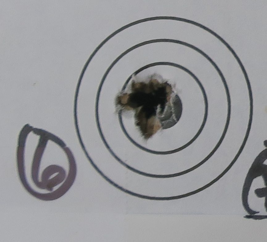

Bull on the target below is 0.33". 25 yards, 10 shot group, JSB 10.34's, single loaded with a CARM SSL, no wind. Shot off a bench, bipod & rear bag.
I would just like to get something near this (and without 2 or more 1/2"-3/4" random flyers out of a 10 shot group) using a magazine, even if I could only use a CARM magazine.

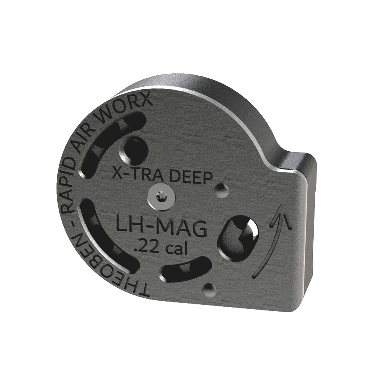

.177 pellets flip sideways inside. It’s far too deep for standard pellets and too weak to use heavy long slugs so…someone dropped the design ball there.
It’s a 14fpe gun…slugs? IDK but the maple mag works awesome. The RAW mag would smash and destroy pellets and literally have several pull out while cocking. I mainly use the single shot loader anyway but quickly removed that mag from the case.
I’ve had no problems with factory mags for pellets or slugs in .177-.30cal over the past five years of competition shooting. Why do Esau the factory mags are junk?
Jeff, my 177 came with one of these extra deep mags is the issue - not a proper pellet mag really. If it had been the marauder style then fine, I know those work. So I had to buy a mag and went with Maple and its flawless. They also made me a narrow side shot loader for my other RAW and I love it.
Ah ok that makes sense. Mine are all the original style.
