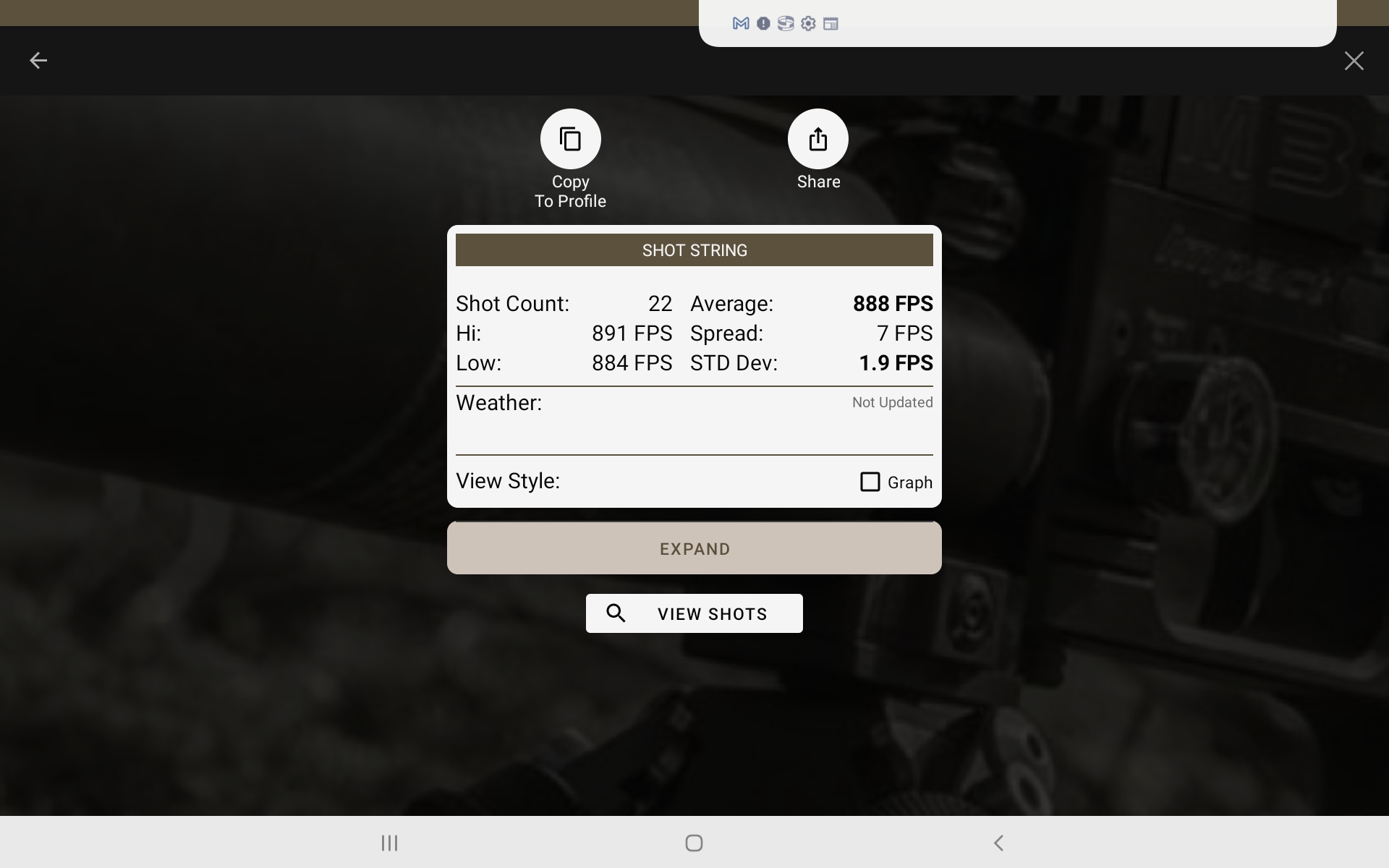

Doesn't really matter. Preferably go to max on the wheel then get a velocity 5% higher than your desired velocity... About 950... Then Start rolling the wheel back. Once you're in the range of the velocity you want, start using the hammer adjuster to make micro adjustments to fine tune till youre at the desired velocity and your SD and spread are minimal. I wanted to shoot 885 with 30gr slugs, I set my wheel to 23/max, then brought the 1.5mm hammer tension screw up until my velocity would raise no more. The started raising reg pressure 5bar at a time, giving ⅛ turns of the hammer tension screw until the velocity peaked, letting me know to add more pressure until they were going 928fps. The. Rolled back to 17 and I was getting 870-893... Then made micro adjustments on the hammer spring until I was at 887.4 average with an SD of 3.2 and an extreme of 9.

Doesn't really matter. Preferably go to max on the wheel then get a velocity 5% higher than your desired velocity... About 950... Then Start rolling the wheel back. Once you're in the range of the velocity you want start using the micro adjustment to fine tune till your at the desired velocity and your SD and spread are minimal. I wanted to shoot 885 with 30gr slugs, I set my wheel to 23/max, then brought the 1.5mm screw hammer tension screw up until my velocity would raise no more, the. Started raising reg pressure 5bar at a time, giving ⅛ turns of the hammer tension screw until the velocity peaked, letting me know to add more pressure until they were going 928fps. The. Rolled back to 17 and I was getting 870-893... Then made micro adjustments on the hammer spring until I was at 887.4 average with an SD of 3.2 and an extreme of 9.
You'll find you can hit that velocity at multiple settings. Personally I like the higher pressure with a lighter stroke. I get higher shot count and quieter shots.
I could get 900fps at 100bar, But it would get me about 60 shots from 250-150 because the dwell would be so damn long. i could get it at 110 and 115 and every increase got mildly better until i found the magic spot. 122-126 Quiet as all hell, Can't even feel the shot. High shot count, Good power, Insane accuracy. Aside from finding a good regulator harmony, i imagine you'll find have a similar experience

Also, when you initially raise pressure, your velocity is going to drop. Because you're at too low a spring tension.. so you're gonna adjust up until your velocity drops or no longer rises. THEN, Back the hammer spring screw back a tiny bit, that means you've reached the velocity potential for that pressure.
