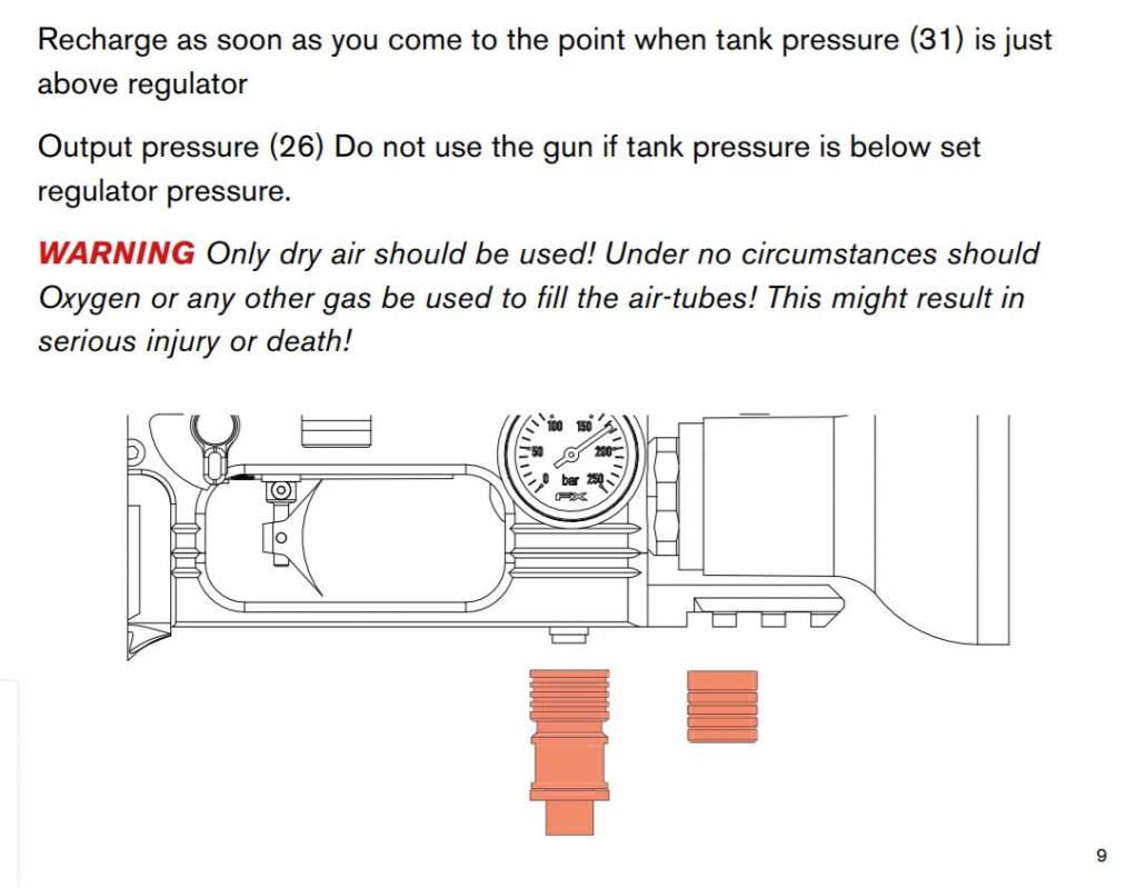

Below was an email I sent to my FX dealer:
”The manual says not to use rifle if tank pressure falls below the “regulator” pressure but it doesn’t specify “which” regulator. Can you clarify which regulator, 1st or 2nd?”
and the dealer’s response:
“It would be your second reg. The one by the pellet probe.”
So, are you saying the dealer is wrong?
The manual clearly shows a picture of the first regulator under the instructions to "not shoot it below the regulator pressure". I would think that means the front regulator. It's so important they said it 2 times in a row. As well, the "tank pressure" they say to recharge before you reach, is denoted by the front reg. Your dealer may be wrong.
Also, why would anyone want to shoot it below the front regulator pressure? It kind of defeats having a regulator in your gun at all.

Here is the response I received from FX-USA today:
”The front right gauge is for the tank pressure the front left gauge is for the first regulator set pressure, the rear gauge is for the second regulator setting.
Technically speaking you can shoot below the first regulator setting, however, even though this won't cause irreversible damage by doing so, this method does run the risk of increasing rifle inconsistencies, and we recommend that if you are able to refill at the first regulator pressure, it will be better for your rifles performance, in the long run, to do so.”
