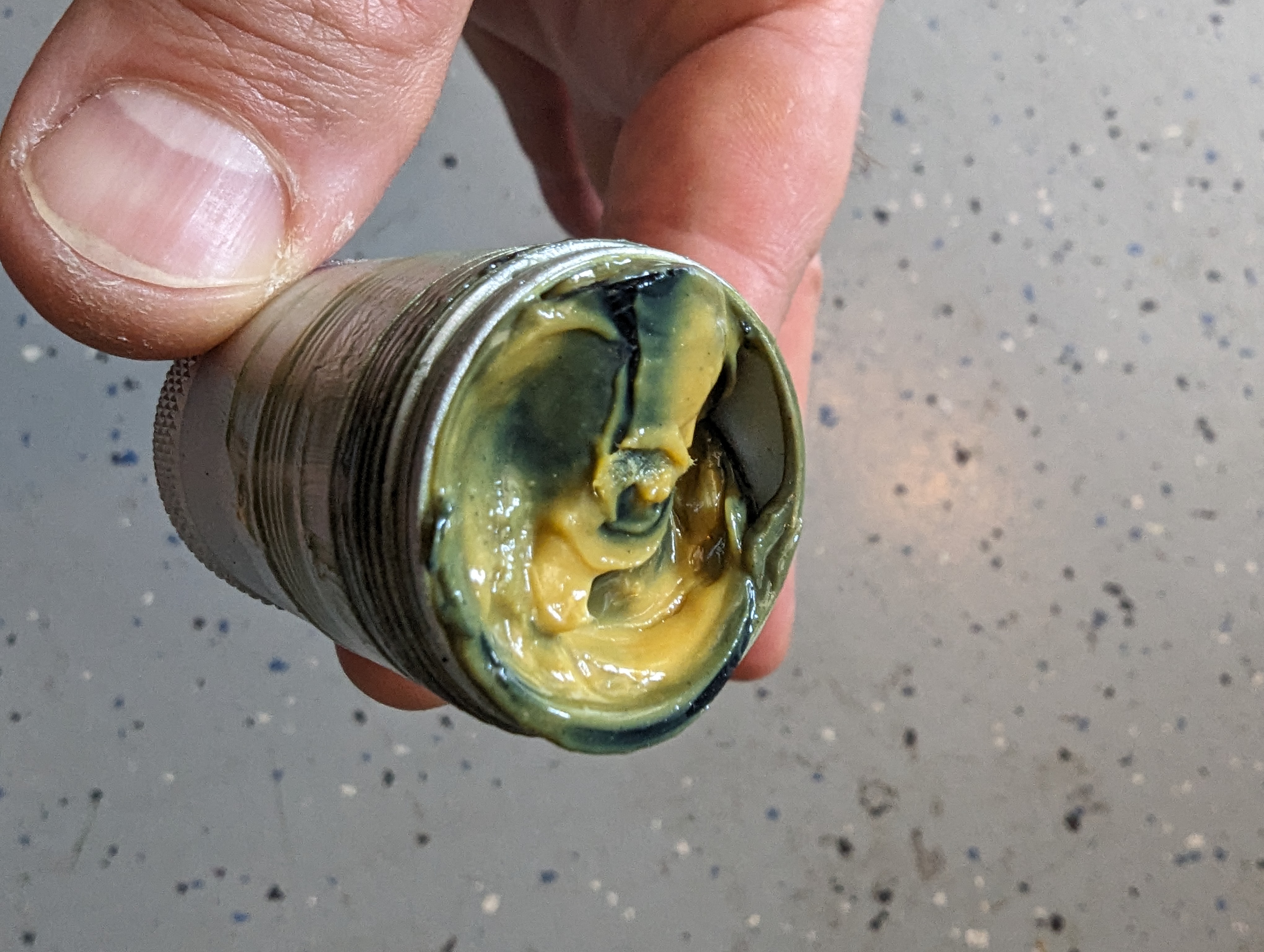

I tried to turn it until the click, didn't hear the click, and apparently turned it too much.
When I screw out the grease cylinder it looks like this (see photo).
So, I don't know whether my compressor is over-greased or under-greased, and what to do next time I need to add the grease.

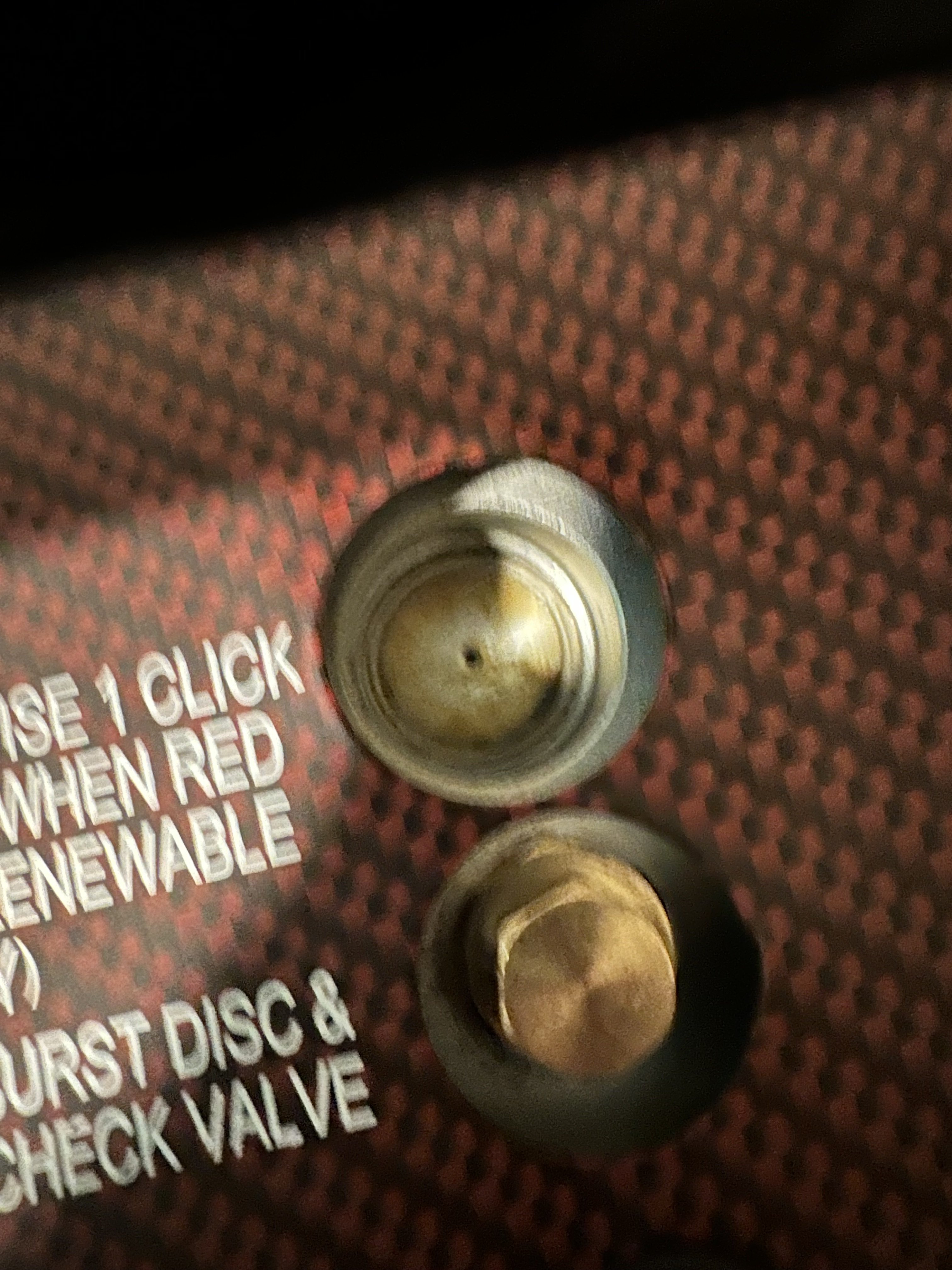

I talked to Todd back in April as I had the same question as you do. The instructions suck as there isn't any kind of click device on the grease cups and not very informative in my opinion! I asked about the red light as I was just over 6 hours and it hadn't come on. He said the 6 hour red indicating light works, but sometimes he asks the manufacture to get rid of it. He said to turn the knurled knob 1 full turn every 4 hours, not 6 and do it while the compressor is running. There is also a rubber disc with a tiny hole, I can see it in your pic, but it looks like it's sitting sideways under the grease, that sits over the grease in the grease cup. Make sure it's there when you screw the cup back on. And yes, my grease cup looked like yours, maybe about 3/4 full, and the disc was sitting above the grease when I took it off at a little over 6 hours of run time. I immediately sent Todd a text and followed his instructions. Just made sure the disc was back in place over the grease, screwed it down to approximately where the other grease cup that I didn't take off was and gave it a full turn from that point. The compressor had developed a minor squeak and it stopped after turning the grease cups which I assumed got grease into the system again. He also said to continue turning the grease cup every 4 hours until it bottomed out. Then remove, refill, burp the air out and start all over again. I found the easiest way to get in contact with Todd was to text him and when he responds, I save a copy of his text for future reference.
I also got advice from another person on this forum about greasing. He said the biggest issue with over-greasing is the last check valve failing which he says is easy to clean on Omega compressors. He said to err on the side of over-greasing if I was comfortable with cleaning the check valves, which I am. So if you feel you over-greased your Turbo Charger, remove the last check valve and look for grease. As there are 2 check valves and I never asked him what he meant by "last", I'd just check and clean both. I hope this info is helpful?

Another great shortcoming of the system is: you fill the bottom of the cup with grease and turn it upside down and screw it into the top of the compressor. The grease from the bottom of the cup feeds the cup in the compressor. The grease at the bottom of the removeable cup never gets used. You are always adding grease to the top and using it from the top once inverted. A better way would be the plug having a Zerk fitting. You feed the grease from the top through the Zerk and the grease gets fed to the compressor from the bottom, so you are always using the old grease first. That's why I would like to wipe out the opening in the top of the compressor of all grease, clean all the old grease out of the grease cup and start over. Since I cannot figure out how much grease should be put in after a complete cleanout, I cannot do that.
