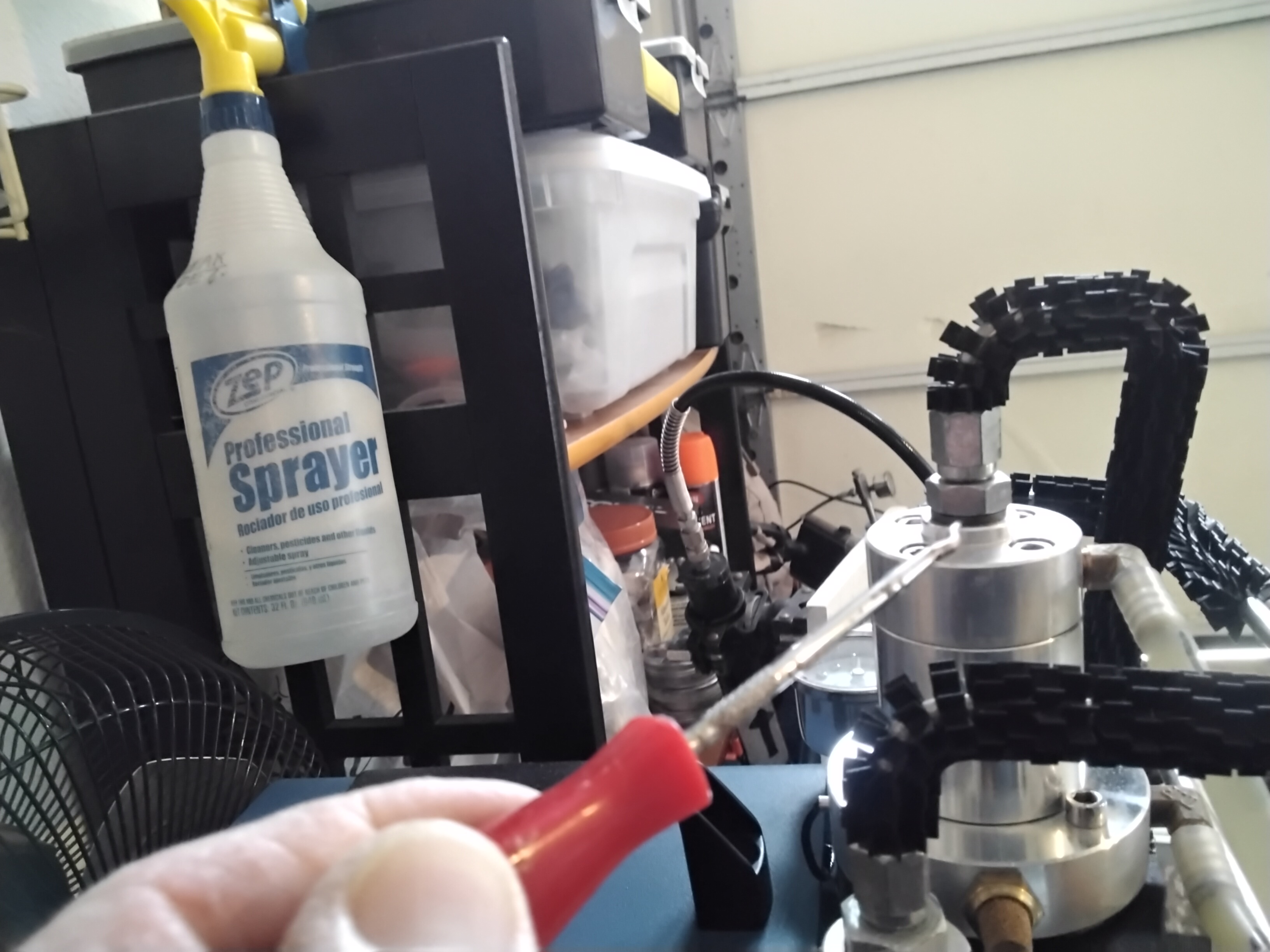

As WorriedMan says, do a COMPLETE leak diagnosis FIRST! Make sure you spray & check the Dowty seal (bonded washer) that's on the top of High pressure cylinder yet under the nut of the tubing connected on top of that cylinder. Should be a brass colored washer that's in direct contact with top of cylinder. I'll post a picture when I can. NOTE: OK, the brass "washer" I'm pointing to with the o-ring pick is what I'm referring to. COMMON place for leaks & loss of pressure. Spares usually are included with YH.
