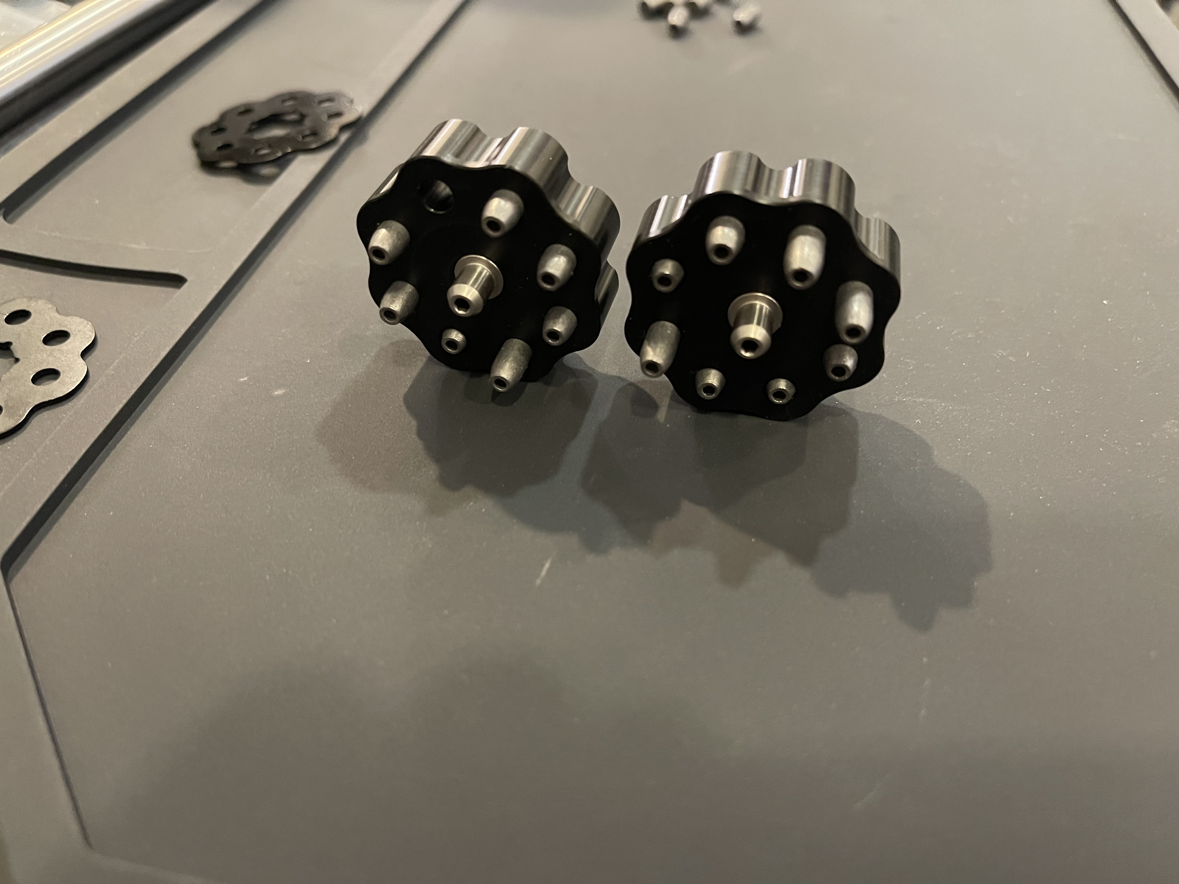

Hello Friends! My Thanksgiving haul just arrived from Edgun shop. I bought a .177 barrel kit with 2 mags. I requested they provide 1 pellet and 1 slug mag and mark which is which. I received 2 mags but there’s no indication as to which is which. Is there any simple way to determine this? I already dropped ZAN slugs in to see if they were caught vs slide through on both but they returned similar results. See attached pic. Thank you in advance!!
Did you measure width of both mags & diameter of pellet/slug "holes" in mags? If one mag is wider (thicker) I'd think that one's for slugs.
I thought it was the other way around, the slug mags were the narrower ones. My recollection is the problem people were having is that slugs were sliding through the pellet mags -- that's why we needed narrower mags (i.e. slightly smaller calibre) for slugs.
The deeper rationale is pellets are easily extruded through the barrel that's why they tend to be a bit over-diameter. Slugs are more solid and less easily extruded, so that's why their diameters are smaller, to cause less friction when extruded through the barrel.
You're probably more correct than me. I'm not very "slug experienced"

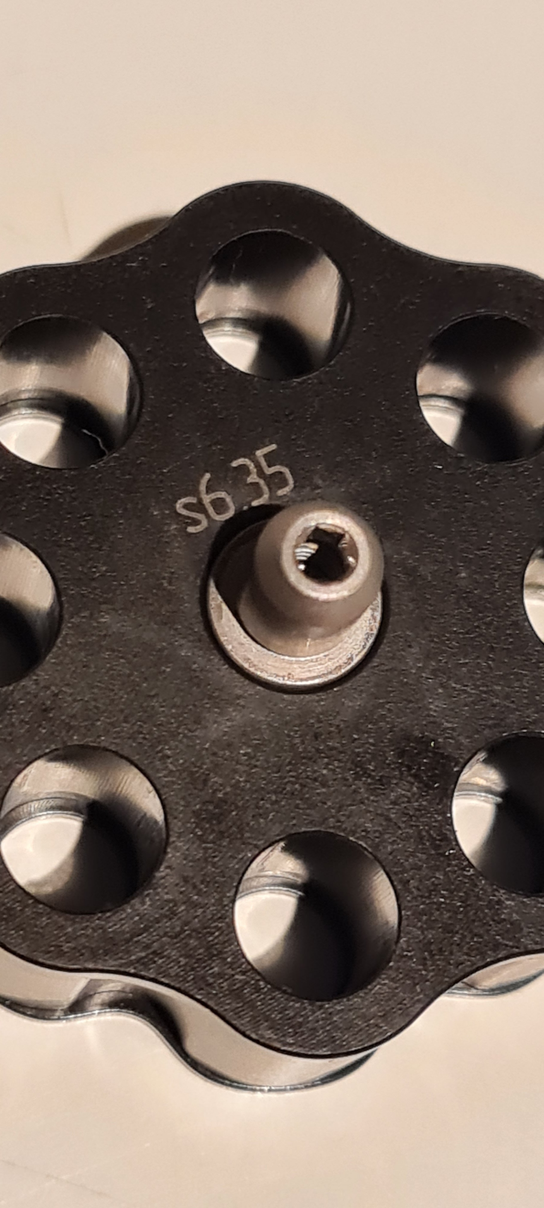

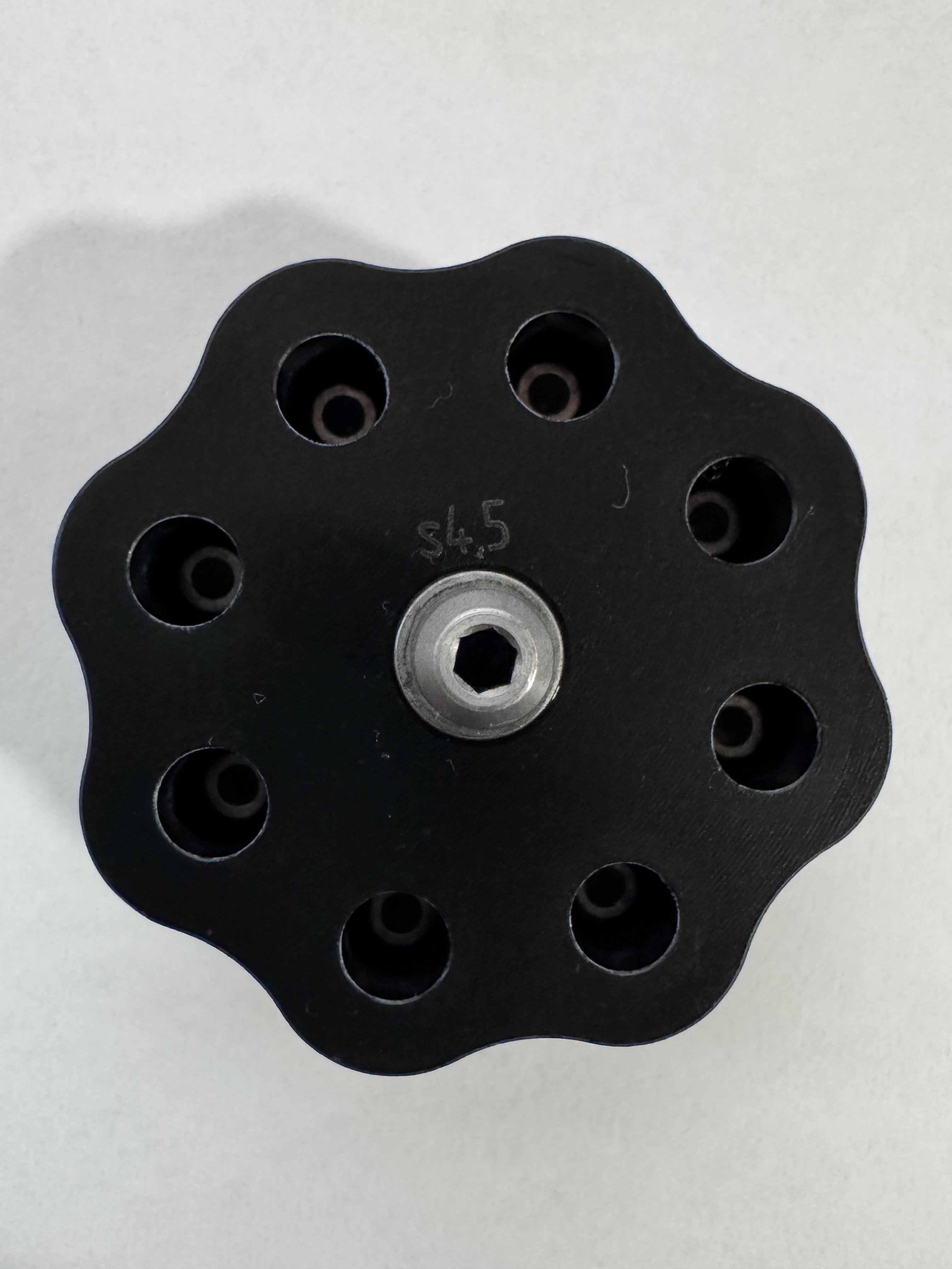

My Slug mags are marked
Thank you, just received confirmation from Matias that this seems to be an absolute rule with Leshiy 2 slug mags.

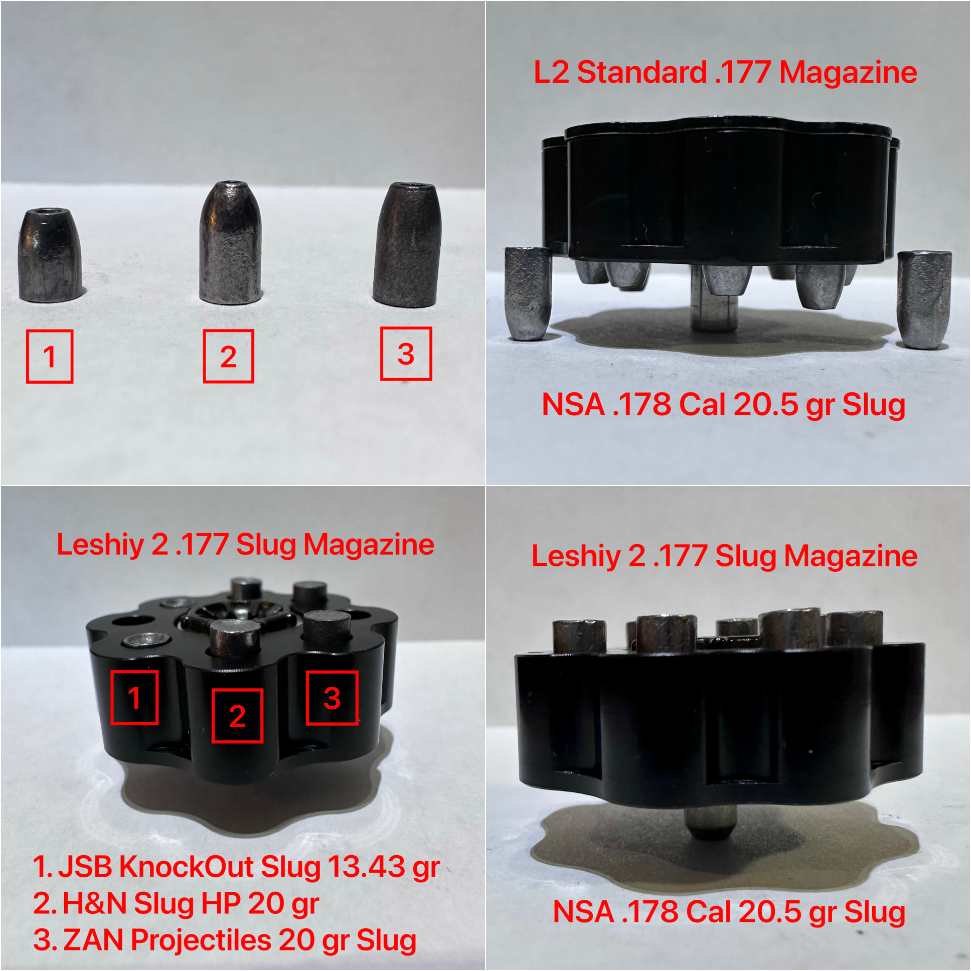

I tried than Zan's, found them to be too dirty and a rougher finish, compared to JSB, NSA and H&N.
The NSA's are packaged cleaner, and are more polished.
I do not like that I have to force the slugs into the Slug Magazine, or that the slugs sit proud out of the breech end of the Standard Magazine.
  • Nielsen Specialty Ammo .178 HP Slugs 20.5 gr
  • Regulator: 130 bar
  • Jets: 1.2mm x 2
  • Average Velocity: 682 FPS
  • Average FPE: 21.2 Ft lbs
I mostly use the JSB/Edgun KnockOut Slugs because these Slugs, are Speed Loader friendly, fit perfectly into the Slug Magazine.
  • JSB KnockOut Slugs 13.43 gr
  • Jets: 1.2mm x 2
  • Average Velocity: 815 FPS
  • Average FPE: 19.9 Ft lbs
Overall, I much prefer to use heavy hitter 20 gr. slugs.
Still looking for HP Slugs, in the 20 gr. range, that would fit the magazine correctly.
