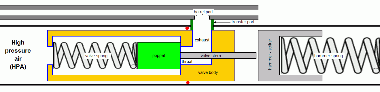

IMHO, the SD and ES numbers on an unregulated PCP don't mean much. True that there's a somewhat "flat spot" where the pressure and valve balance but you are really dealing with a constantly changing situation.

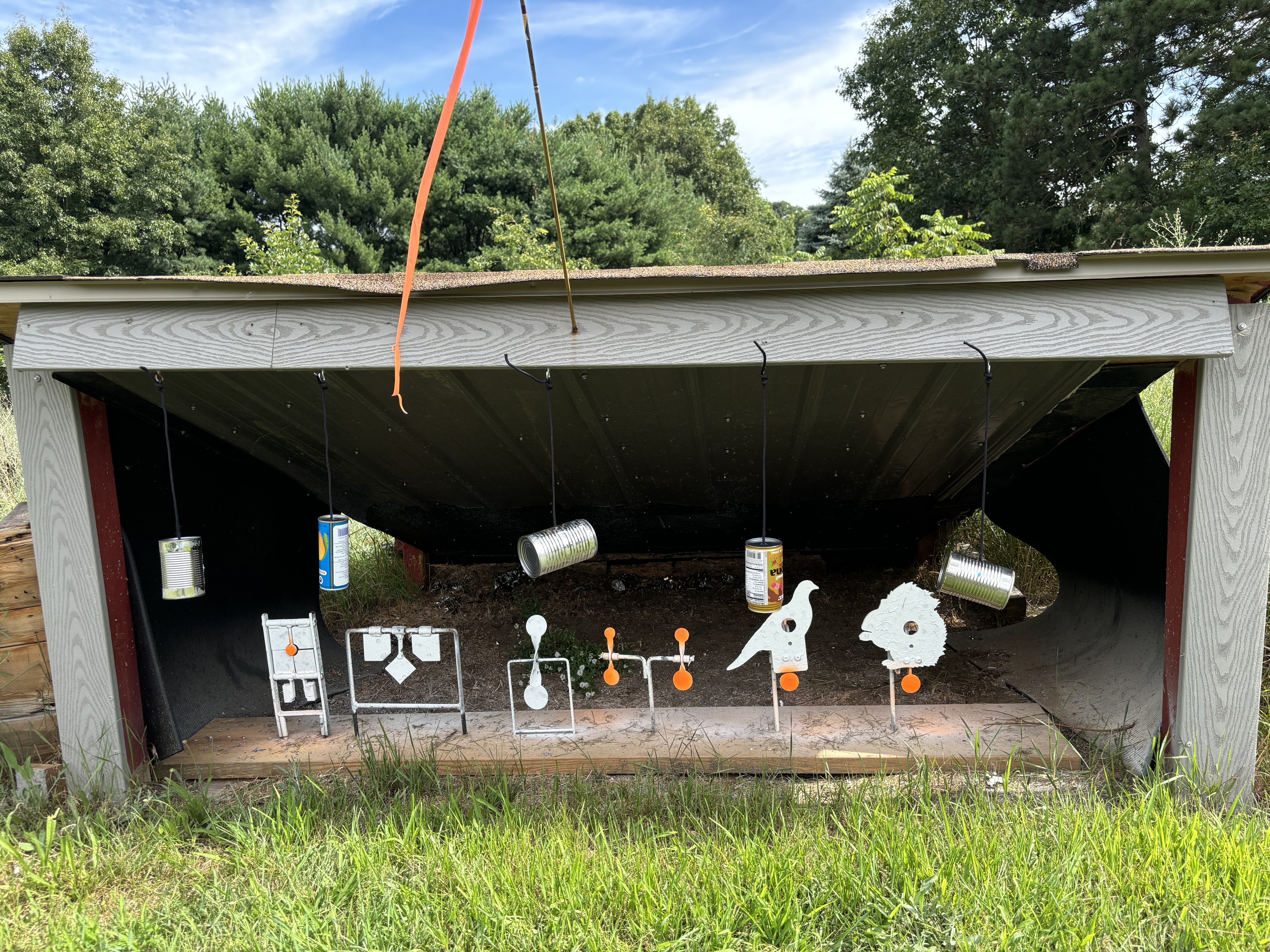

A variance in velocity will affect the trajectory. If you're shooting tin cans at moderate ranges, a large change in trajectory over the whole shot string is not a problem. If you're shooting for precision groups at longer ranges then changes in trajectory are critical and only a small portion of the curve is usable.

SD are ES are good points of REFERENCE for the performance/consistency of the valve/power plant but not necessarily an absolute indicator of accuracy.
The regulator in a PCP saves me the trouble of plotting the power curve and constantly monitor/adjusting the fill pressure. Call me lazy but I prefer the convenience of a regulator even if they are potentially a source of trouble. (I prefer automatic transmissions in cars as well
