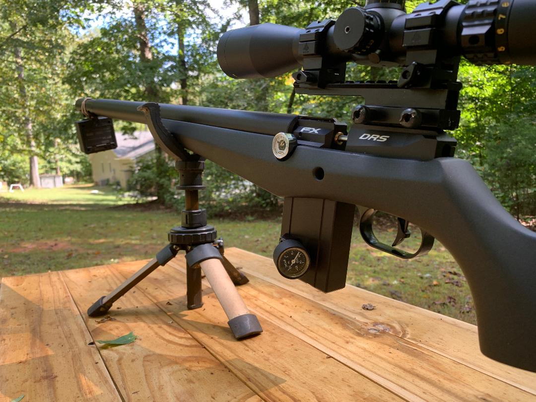

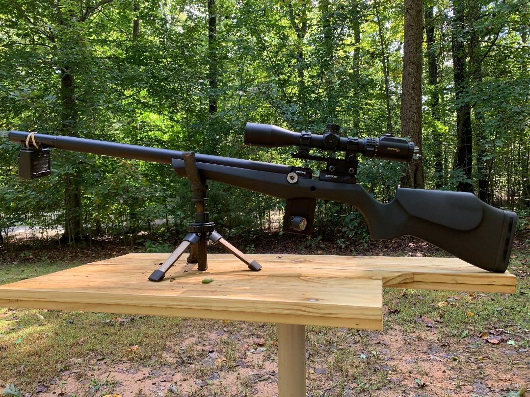

Having got my DRS .22 600 a few days ago It was shooting 18g pellets at around 960 fps out of the box , shot count two mags ( 24 pellets ) I was a little disappointed with the shot count considering I was supposed to get around sixty shots , so ok It was shooting a little hot so I tuned It down to 900 fps with that I saw barley three mags . So I bought and Installed the SHP power plenum with the side bracket and gauge , before I changed the tune It shot 18G pellets at 1024 fps , after doing some tuning on the reg and the hammer spring I am now shooting at around 930 fps with the AEA 18g pellets the regs at 80 bar and three full turns out on the hammer spring now Im getting four mags + . So now this rifle Is awesome It shooting 15g/18g pellets at 60 yards half Inch groups with every brand of pellet I have It even loves the cheap Norma 17g pellets . The picture was at sixty yards with AEA 18 g the small target at the top was a sight In no wind single shot loading .
