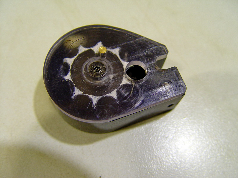

I noticed that, after I saw the following jammed magazine:
The pellet was deformed by the probe on the lower part which meant that the probe arrived before the pellet was in position.

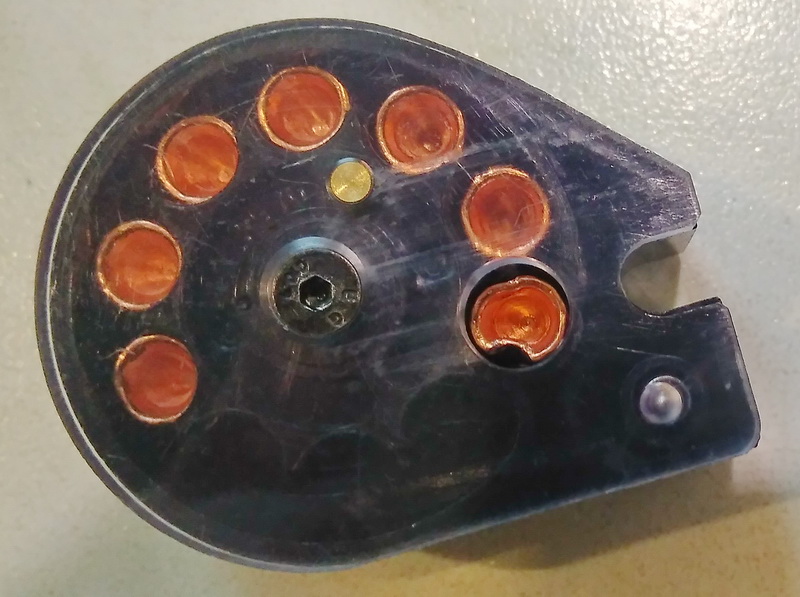

to my specifications. In order to show that it was 100% the spring and not something else, I used my first beat up magazine
in which the rotor has been completely chewed up.
I installed the new spring and I have lost count how many times I have refilled it !!!
It did not matter what kind of pellet I used, as long as it was in the same weight ballpark.
The stronger spring was only for slugs and it worked as intended. Perfectly.
I did not have a single issue since then! Every time I pulled the trigger the pellet would
travel to the target and the magazine would index to the next position.
A semi auto that you can now trust! I am very happy for that, because in all other
aspects, the HP SS is excellent. Design, portability, leaks, power, etc.

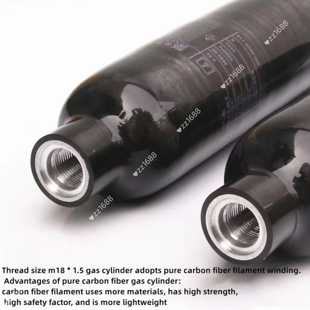

I've just bought from Aliexpress a .36L carbon fiber bottle to double its air capacity
and hopefully the shot count.
This was the seller :
https://www.aliexpress.com/item/1005006221649697.html
Does anybody have any previous experience with carbon fiber bottles from Aliexpress?
I hope its safe. The threads and inner lining are from 6061 aluminum and they said
that they have been thoroughly tested. Good for 300 bar, tested up to 500 bar.
I will not be filling it though more than 220 bar.
Will the increase in air capacity will result in a slight increase in power as well?

I have a .3L on mine from Aliexpress, works fine. Gave me one more magazine at full power, but will continue to shoot for about another mag. It will not increase your velocity. If you want to do that you need to work a balance out between the hammer spring and poppet spring. You can space the hammer spring and gain some velocity but it will cost you in air.
Reactions: BABz58 and hgg2k
Good to know.
You went to .3L from what air capacity?
My thinking was because the air tank acts like a big plenum, if you double its size
maybe you will gain some extra FPS. Same power its ok though, I just want more shots.

Ok, I spoke too early...
Magazine is broken again! lol Guess what broke off?
Not the spring, it was the little plastic extrusion at the bottom inside the magazine
that stops the pellet wheel rotating. This thing is hopeless!
I drilled a larger hole and pushed a 3mm metal pin (6.5mm length), press fit and glued
with two part epoxy. I am not giving up! 🤣
You have to be very precise to install a 3mm rod, so I suggest a 2mm.

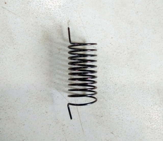

So the slightly lighter spring on the magazine which still works
has a thickness of 0.7mm, OD of 11mm and 11 turns counting
opposite of the spring pins.
