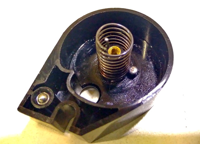

Ok, I spoke too early...

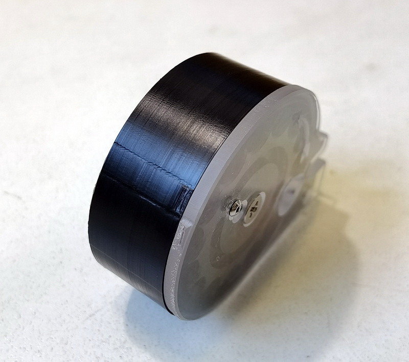

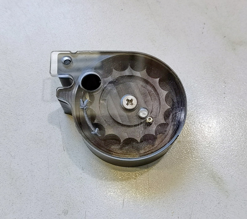

Magazine is broken again! lol Guess what broke off?
Not the spring, it was the little plastic extrusion at the bottom inside the magazine
that stops the pellet wheel rotating. This thing is hopeless!
I drilled a larger hole and pushed a 3mm metal pin (6.5mm length), press fit and glued
with two part epoxy. I am not giving up! 🤣
You have to be very precise to install a 3mm rod, so I suggest a 2mm.
So I guess the stronger slug spring was too much for this trash.
I am feeling like I am polishing a turd...
Let's see how long this will last.
So the slightly lighter spring on the magazine which still works
has a thickness of 0.7mm, OD of 11mm and 11 turns counting
opposite of the spring pins.
Maybe its called AEA for a reason. Abandon Every Attempt... (to fix it...) 🤣

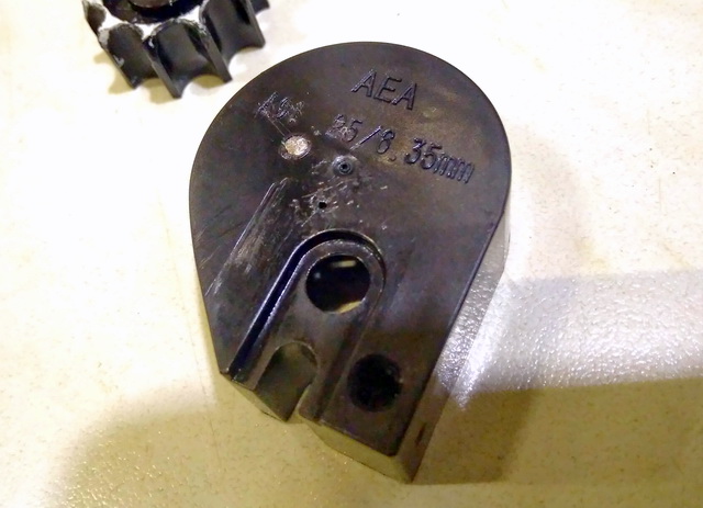

One of my magazines broke the same small plastic piece.
I used it for a while like that by rotating it 2-3 times for more tension.
I gave up on it since I was getting pellets in the trigger area.

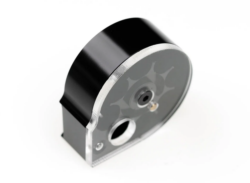

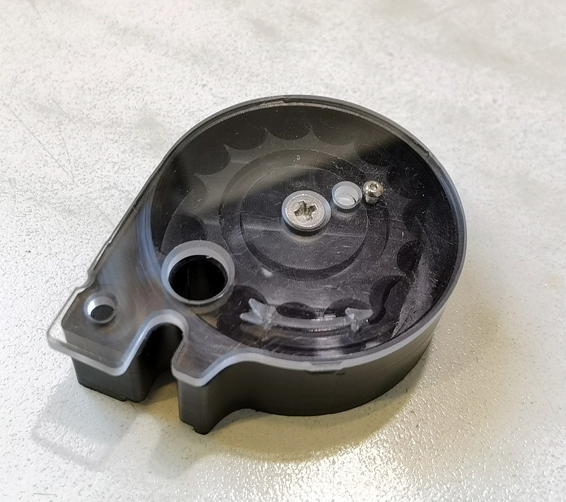

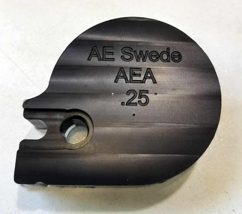

Although I have fixed all the issues with the stock AEA mags and after all the mods they work very well,
I thought I should give a try to the custom extended mags from AE Swede. 15 rounds for the .25 cal.
Recently I received the magazine and first impressions are very positive.
CNC made from acetal copolymer plastic, much stronger and smoother than the cheap toy plastic stock magazines.
It spins much smoother and the locking mechanism of the clear cover is solid. You can throw them around and all
the pellets will stay in place. Try doing that with the AEA mags...
The spring is quite stiff and stiffer than the one I have used but it has to rotate 5 more pellets.
There are some imperfections on the side of the magazine but it is out of the way and does not affect its usage.

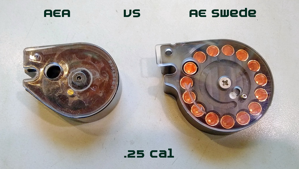

Here is a relative size comparison with the stock AEA.
You need a bit more force to insert it in the breech and it clicks in place.
For the HP SS .25 with the small tube is the perfect companion and you get 15 shots from 25 mpa down to 16 mpa.
I think this is an excellent magazine for slugs on the HP SS.
Let's hope it keeps working like it works now.
