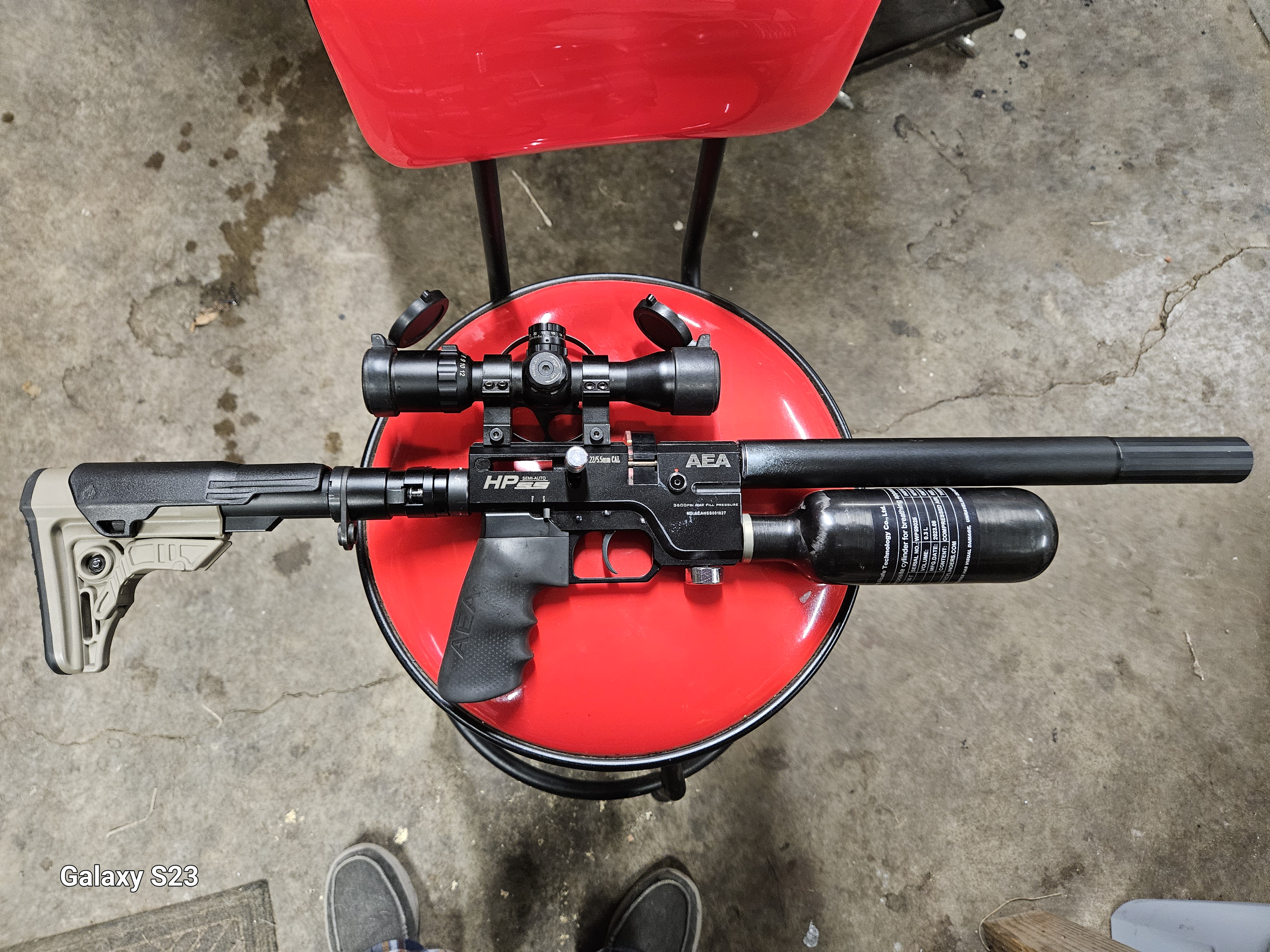

My 22 SS shooting FX 15.9 gr pellets starts out at 910 and bottoms around 780 for two 17 rnd mags. There is 1/2" verticle variation from first shot to last. First 70 fps there is no drop in point of aim. I'm shooting with a .3L bottle filled to 230 bar. I can shoot it at 250 if I shim the hammer spring with a bushing. I get less consistant shots for some reason so I removed the bushing. You can use your stock tube as a hammer spring adjuster. Along with bushings it gives you tons of tuning options. You easily have 3/8" adjustment with just the stock tube.

My 22 SS shooting FX 15.9 gr pellets starts out at 910 and bottoms around 780 for two 17 rnd mags. There is 1/2" verticle variation from first shot to last. First 70 fps there is no drop in point of aim. I'm shooting with a .3L bottle filled to 230 bar. I can shoot it at 250 if I shim the hammer spring with a bushing. I get less consistant shots for some reason so I removed the the bushing. You can use your stock tube as a hammer spring adjuster. Along with bushings it gives you tons of tuning options. You easily have 3/8" adjustment with just the stock tube.
That’s a mighty nice ss ….
At what range does that 1/2 in stringing occur ?

Thanks Al I completely left that out. Duh...... Fifty yards. I told a friend that the other day and his experience was the same as mine. I carry the SS or my 25 carbine twice a day walking the dogs. The SS in the picture shows wear on the receiver and the shroud. Thats from me carrying it in a single point sling. Shoot lefthanded so that is the side that rubs against my clothes. When I received the rifle last summer it looked like new.
Nice. Is that a custom moderator?
Aea s are built for use.
A little wear and tear on a field use gun looks rugged and normal.
