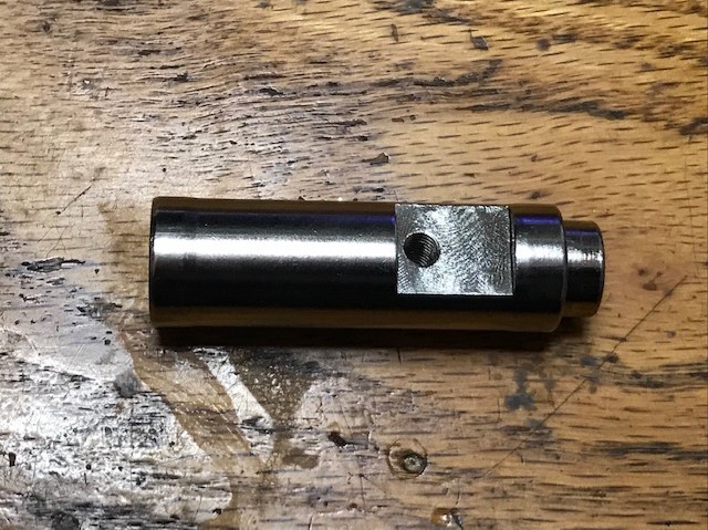

FYI, I ran across this thread on GTA showing an example of an SSG for the Akela:
https://www.gatewaytoairguns.org/GTA/index.php?topic=176720.0
And in it, Troy indicates the tube ID is 30mm. That detail may inform the O-ring size you would need for a bstaley buffer, but it wasn't sufficiently clear to me that hammer rides in the same 30mm space.
It looks like he has a related thread here on AGN so you may want to try reaching out by private message to see if he can advise on it.

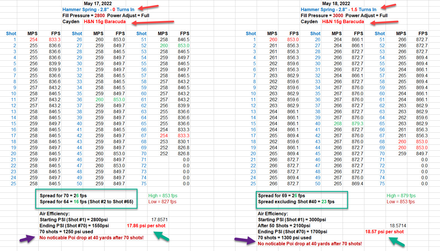

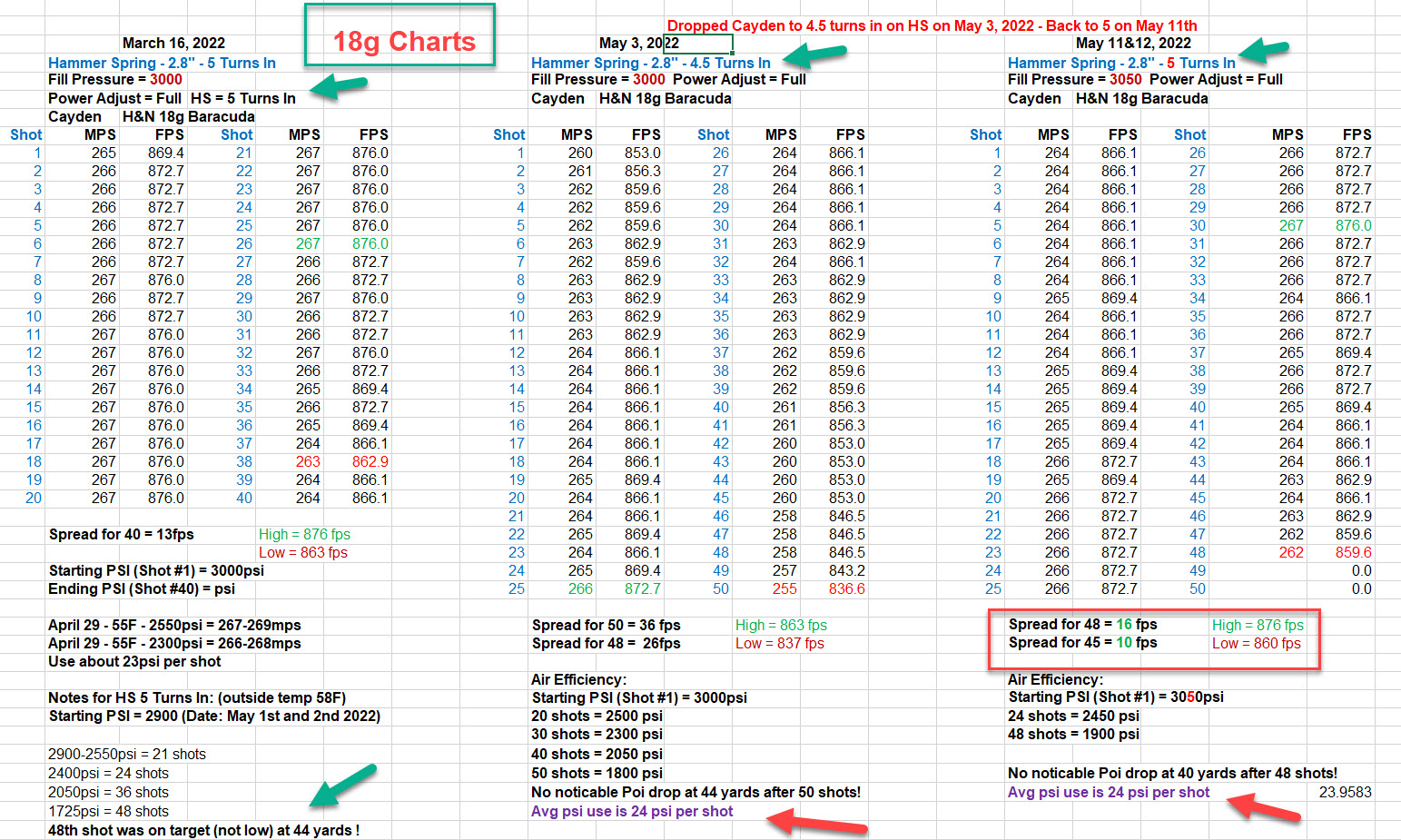

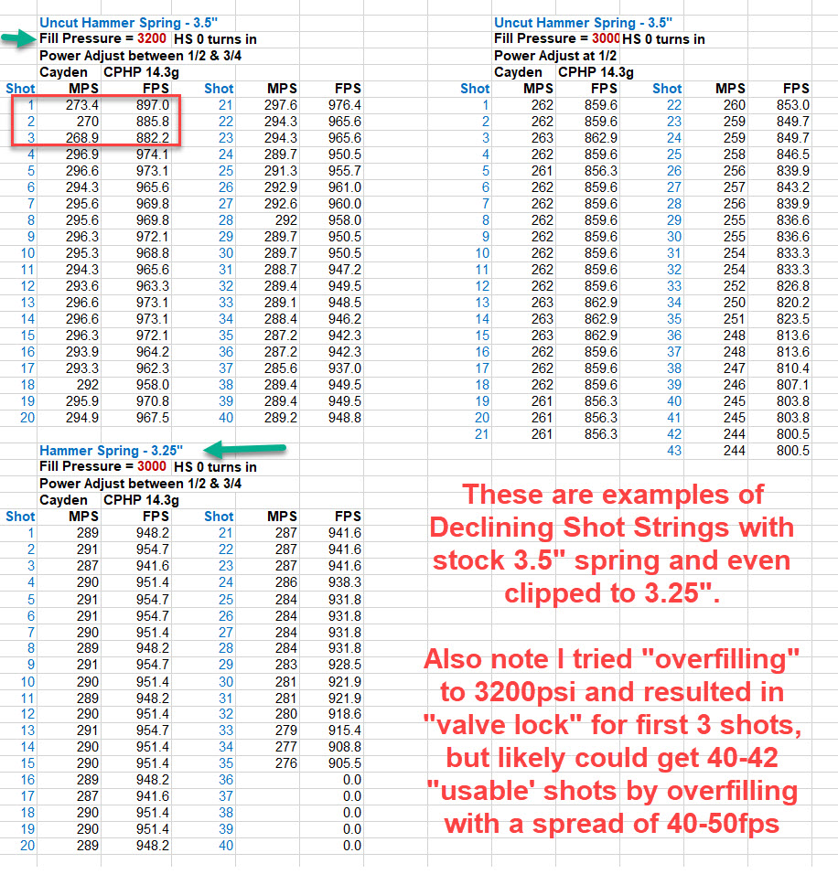

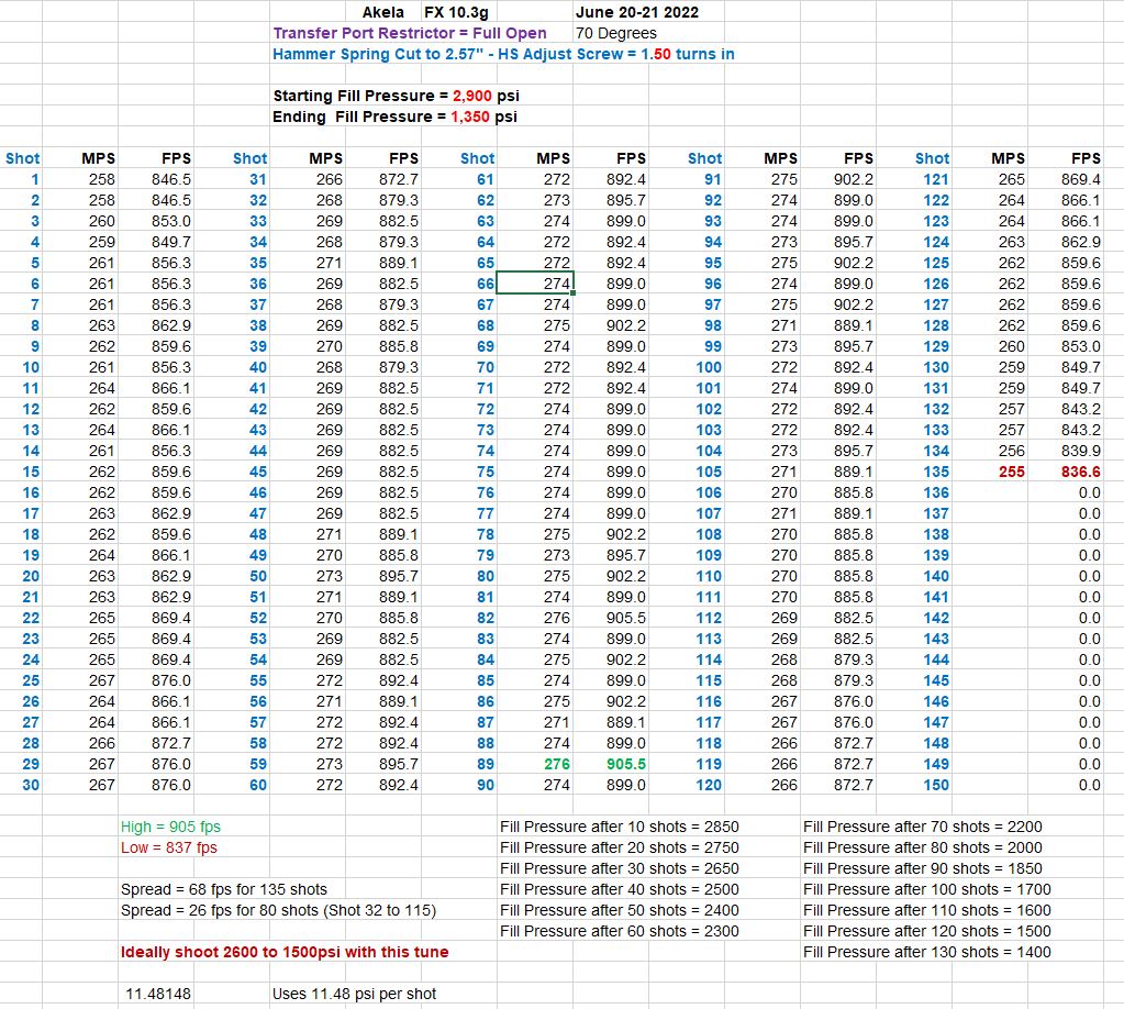

Cmon guys. Cut the hammer spring to 2.8” (for .22) get a nice flat curve, and then he can use transfer port adjuster knob to tune to 500fps. This is a five minute job. If it’s a .177 caliber, cut hammer spring to 2.57”.
The Craftsman series guns are oversprung from the factory. I would start with this simple spring adjustment (via shortening it) before trying any of those complex mods. If you want to go back to the stock 3.5” spring, they $3.50 from Crosman.
