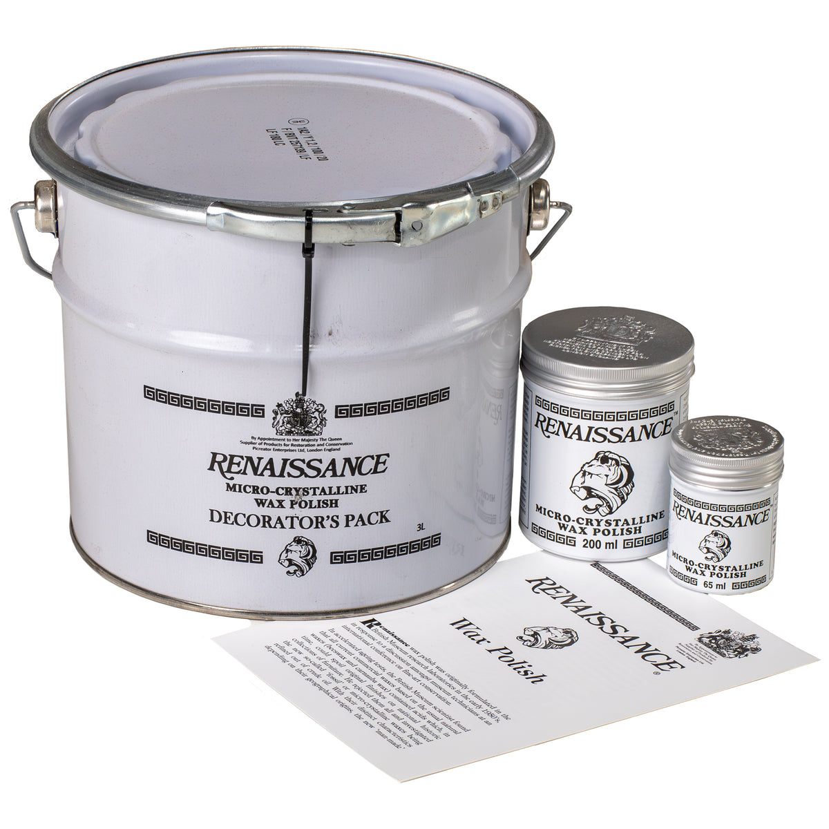

RenWax. Nothing works better on airguns. I do like CLP, though. A little dab behind the ears drives the missus wild.

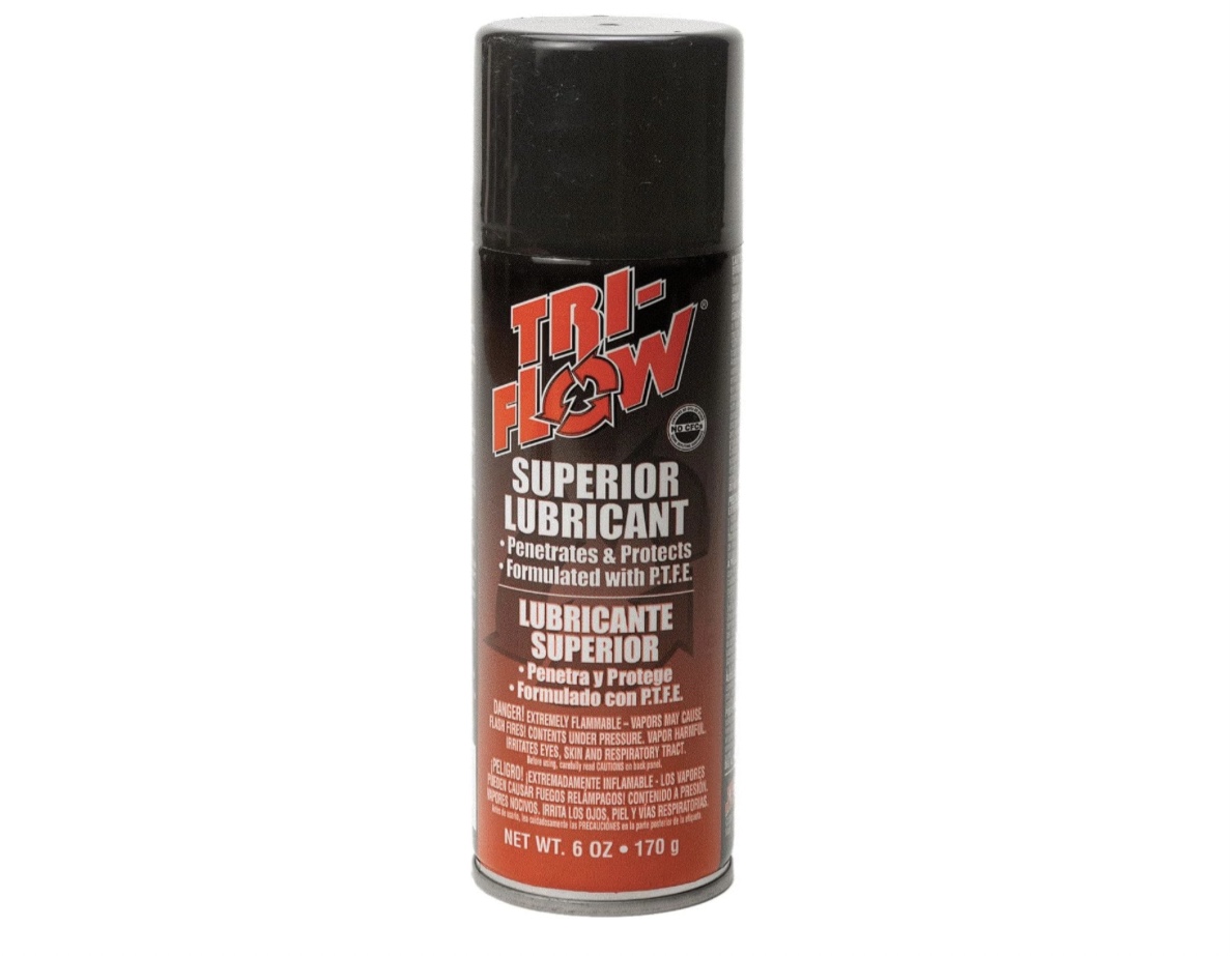

I live on the Gulf of Mexico in the Deep South Alabama for the past 8 years. Most humid portion of the country. I use Tri-Flow. It leaves a Teflon coating. Never had rust. Been using it for decades.View attachment 489209
You’re close, but not quite 🤣
Florida is #2 after Alaska.😮
I’m in coastal sub-tropics. The only place I have been that is more humid than south Florida is Cartagena Colombia.
I’ll give some tri flow a try.
