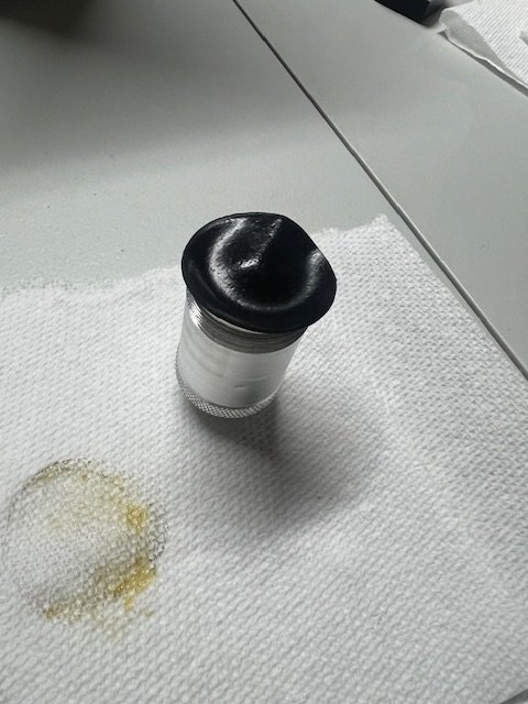

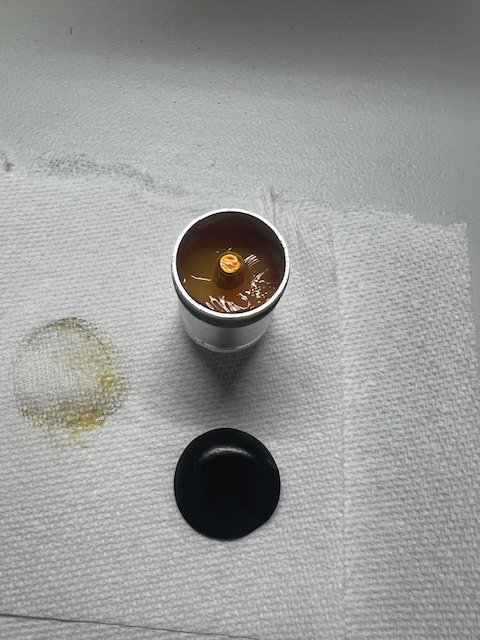

Thanks Jack. I will keep my ear out for those "thumps". Haven't had a chance to run it yet (waiting for the grease to arrive). Did you already had a chance to inject more grease into the machine? If so, did you time your usage on the machine or just went with the speed degrading method? Appreciate your input. Hope this thread helps someone else with new CS4 since this grease mystery topic seems to be hot topic online.
I had about 2 hours on my CS4 when I read post warning of large air bubbles in the grease. I then opened the grease cap and found a large air bubble. There was no need to add grease so I just stirred what was there to remove the bubble. With the cap off, I turned the adjustment knob until the grease was flush with the opening and then reinstalled the grease cap. Because of the bubble, it seemed prudent to turn the adjustment adjustment knob in until I felt resistance.
It was then that I started timing the thumps. The compressor has about three hours run time since then. I plan to the knob in one full turn at four hours run time.
JackHughs
