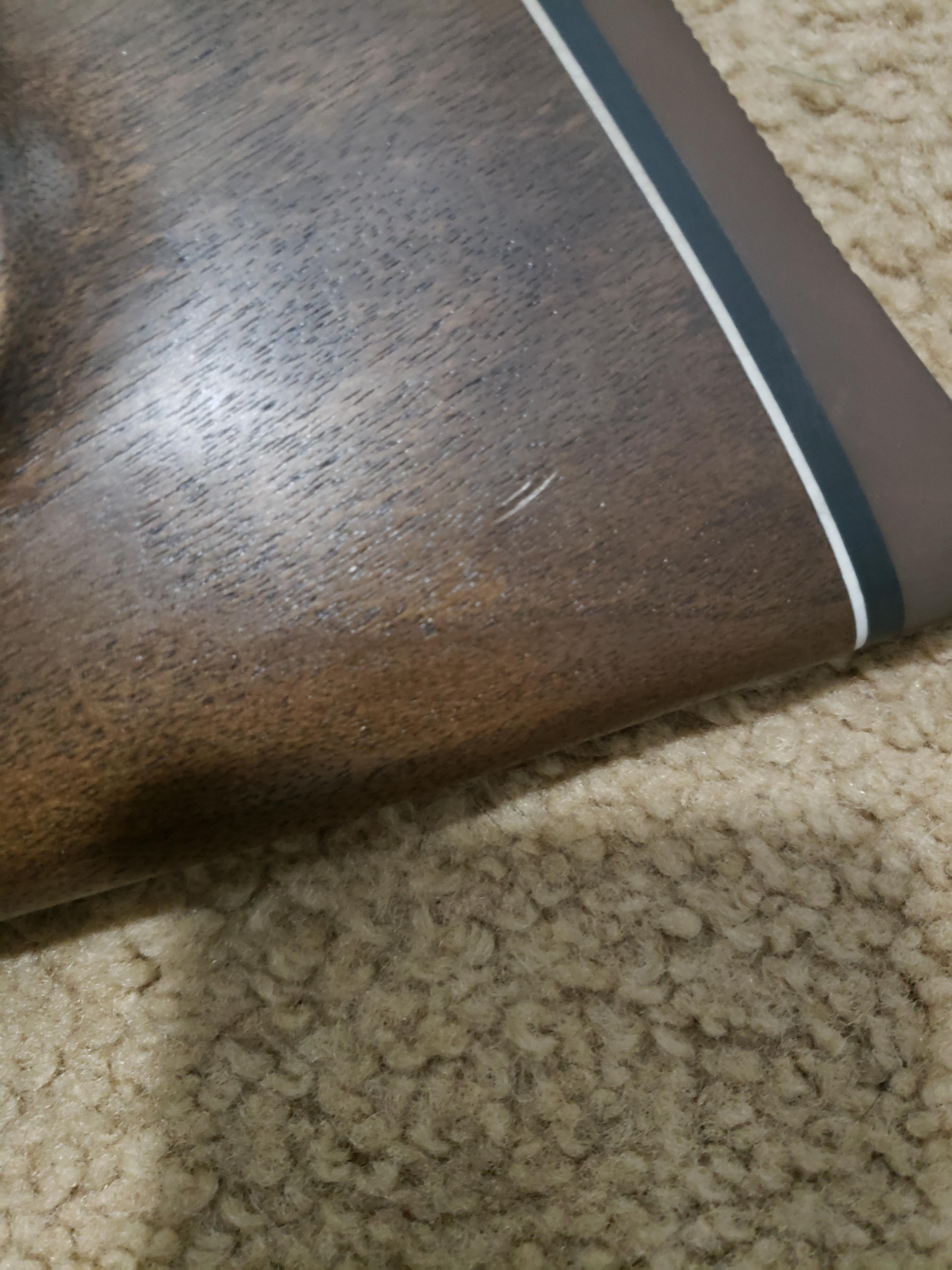

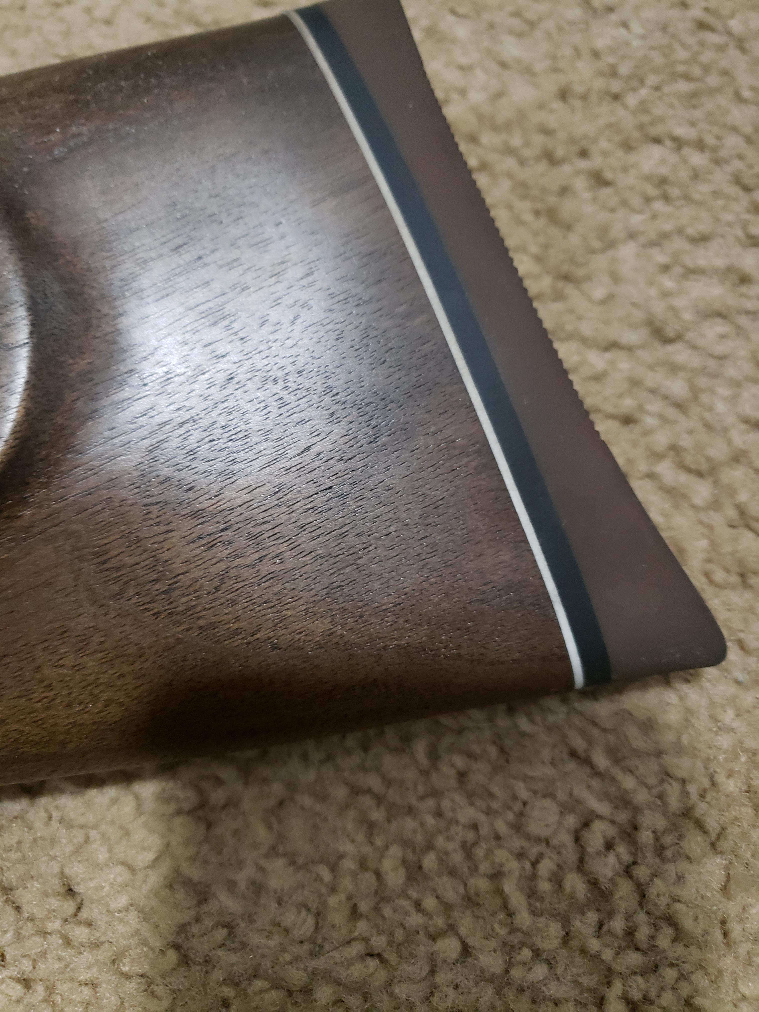

I dropped a scope on my brand new HW35E stock and put a small dent in it. The steaming method took it out in seconds and unless you look very closely you would never know
 Before:
After:
Steaming dents is the best way I have used. If you have a glossy finish? You are going to have visible finish degradation.

I do some piddling here and there with wood etc.. (not claiming to be an expert)...I've steamed out a few dents in stocks. As others have said and shown it can be very successful. I might throw in that the results will be better with a true "dent" where the fibers of the wood aren't broken. If the dent is bad enough to where there is broken fiber/grain then it will help but may not be as clean as just a dent. GL
