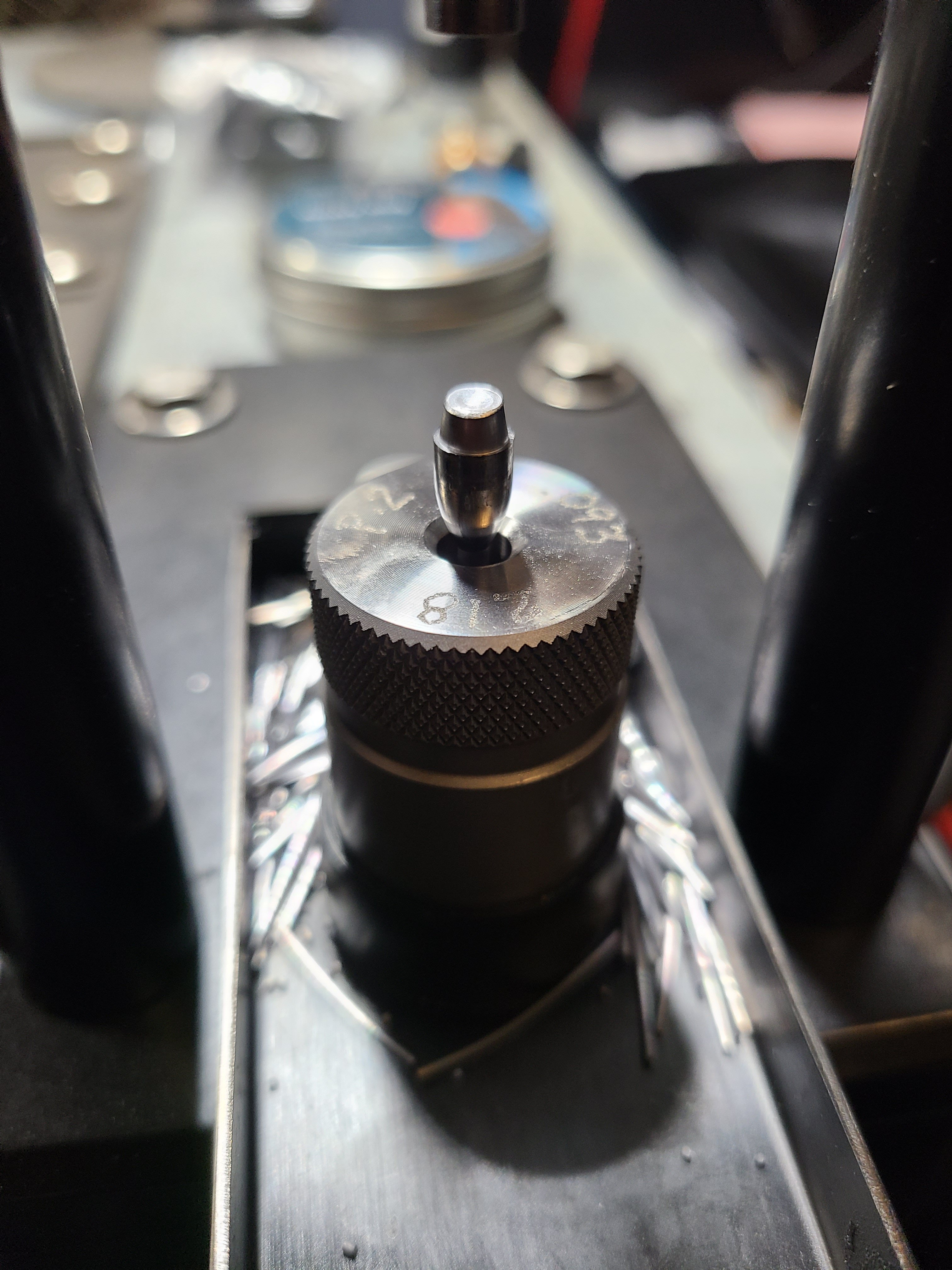

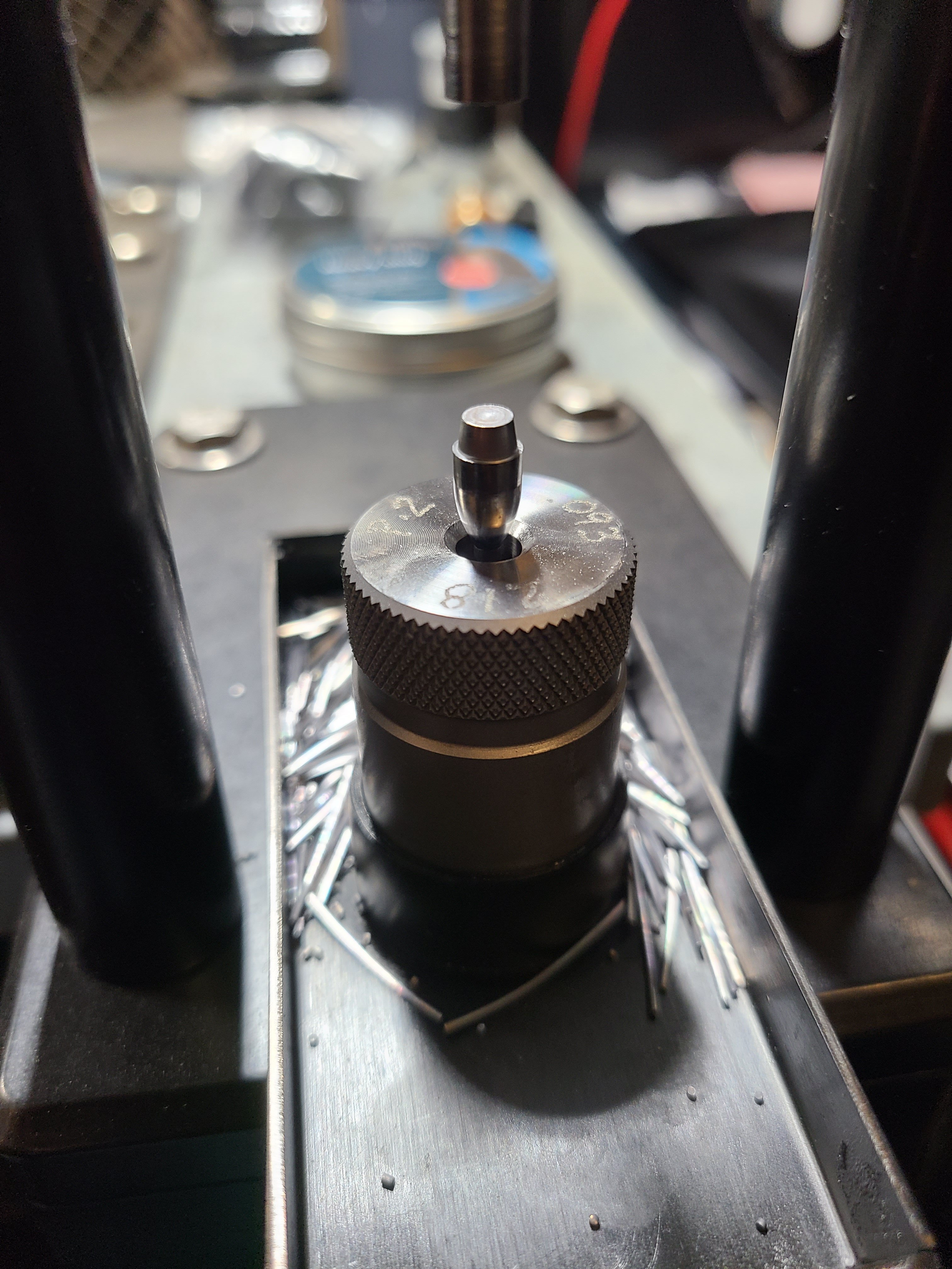

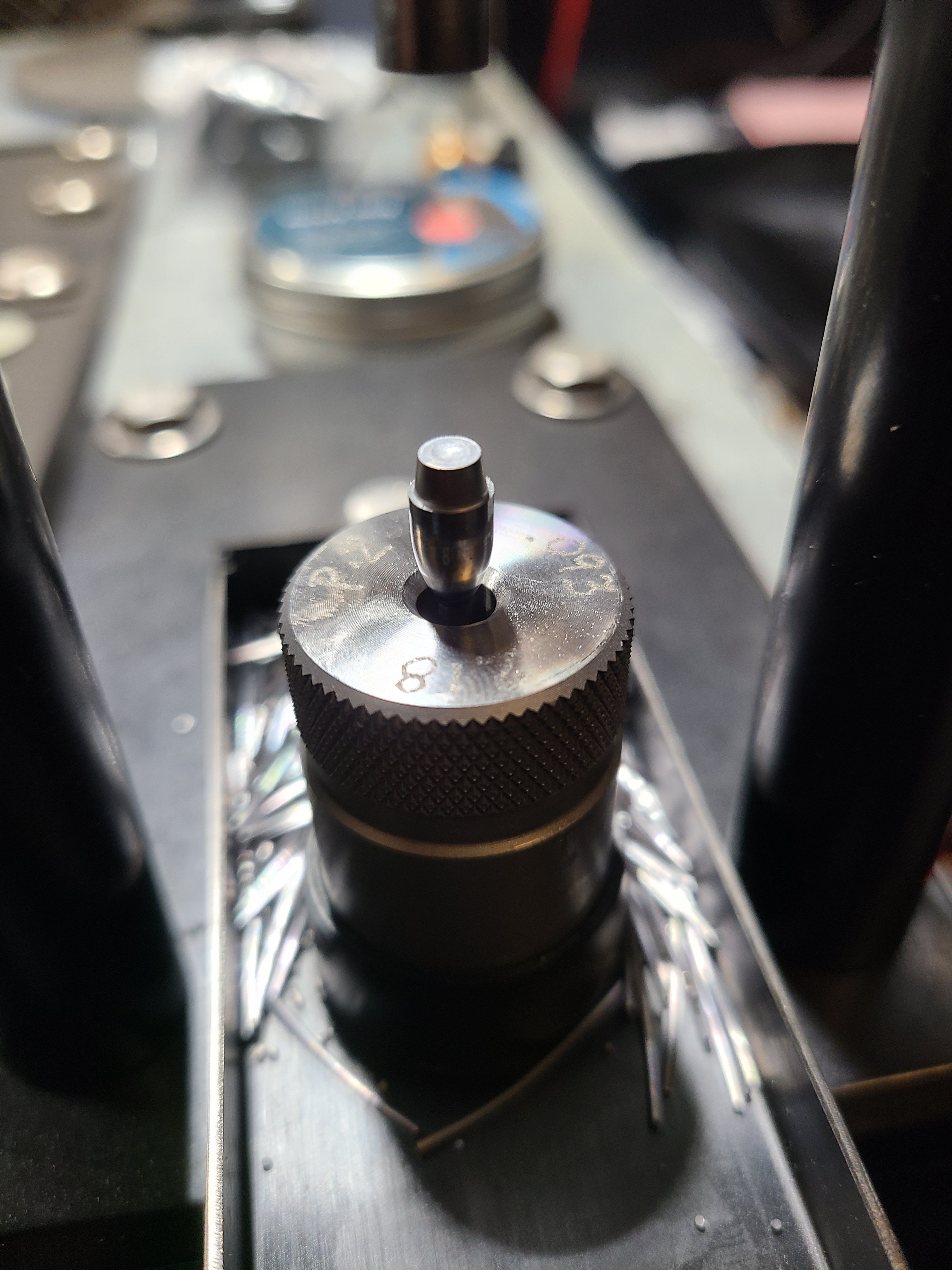

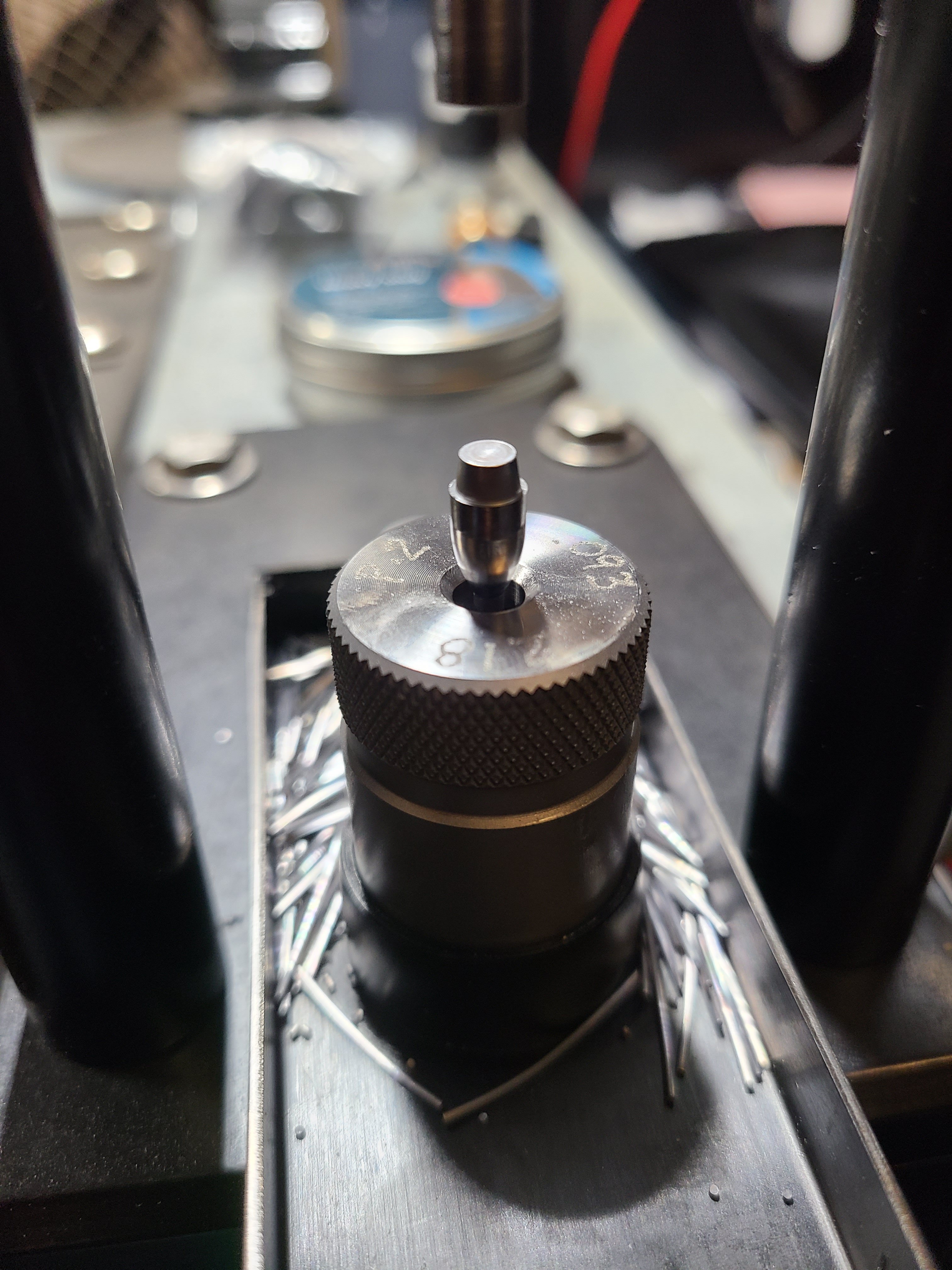

For the ones making RBT's, I'm sure you noticed the deformation on the bases caused by trapped air on the 1st pass. I have been following up with 3 passes rotating every time for the best results. What have you all been doing to combat this? So far this has been working very well.
1st press
2nd
3rd
4th
One little wipe with the fingers removes the leftover burs.

What diameter wire are you using?
I've found that smaller diameter wire usually works best for BTs. It tends to fill the ends of the slugs first, then smashes out and fills in the rest of the slug if that makes sense. You might measure the back of the boat tail to see if it's smaller than .200 and if so, try .185.
Another thing that can cause the BT not to fill correctly is if the core cutter dies aren't the correct size for the wire. It will cut the cores off at an angle so they won't fill the BT as evenly.
I hope this helps.
I hope this helps.
I might give .185 a try. If I can get the results I want with one pass, or two, that would be great! My cutter die is a snug fit, but the blade cuts one end at an angle and leaving one end squared. The angled end goes into the swage die 1st leaving the flat end for the punch. I just came to the assumption that RBT's are just more work and probably why most manufacturers don't offer them. So far I'm liking them.
