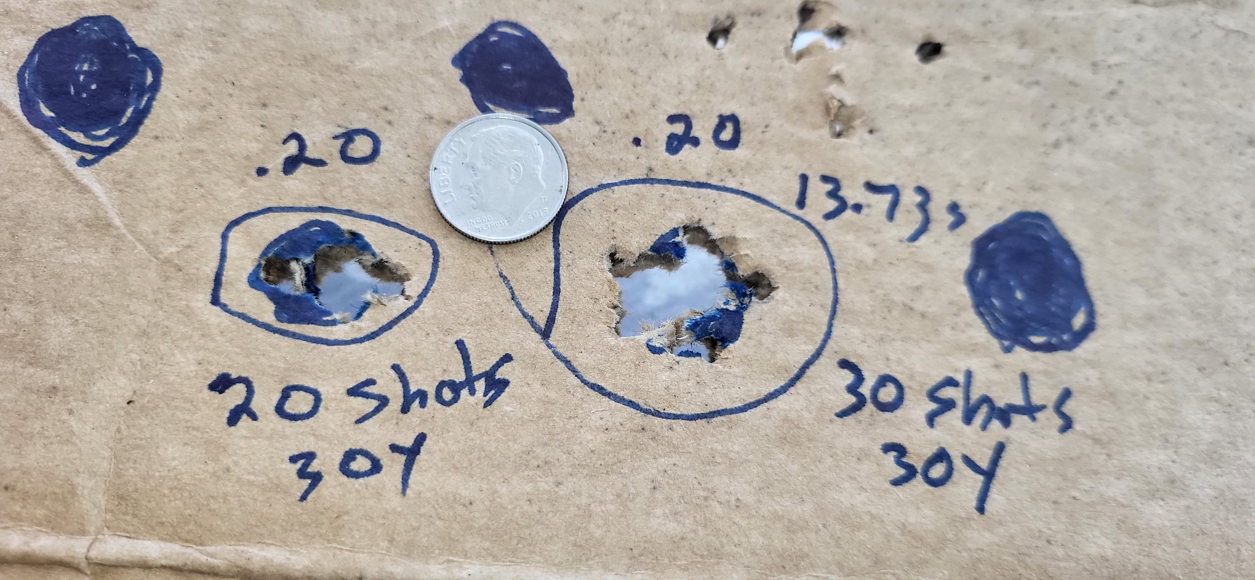

Opening a can of worms but IMHO...Different standards for individuals accuracy and what is "good" for them. Take the three group's beginning this thread...the two dime sized groups are sparrow head capable forever more at 30+ yards with no cleaning...ever...would thrill some people to death...myself I would be ashamed and throw that gun away if it wouldn't do better than that...that is the defined dynamic...different for different people...Barrel polishing...I was machinist for 38 years and know something about metal...I believe in polishing with the correct medium...my best three barrels...Veteran standard Bobcat. 25 and Huntsman Regal .177 (best of the lot) have all been polished by me...If an individual is satisfied with the two dime groups I doubt if polishing would impress them...the overlapping clean barrel group (not polished) is no where near THAT barrels (or my) best potential because of the heavy trigger unsorted pellets 18X scope and ridicules bench and bag system I was using even a bit of wind...I just target shoot for fun...but been doing it 60 years and still enjoy it....and pretty good at it...IMHO...LOL!

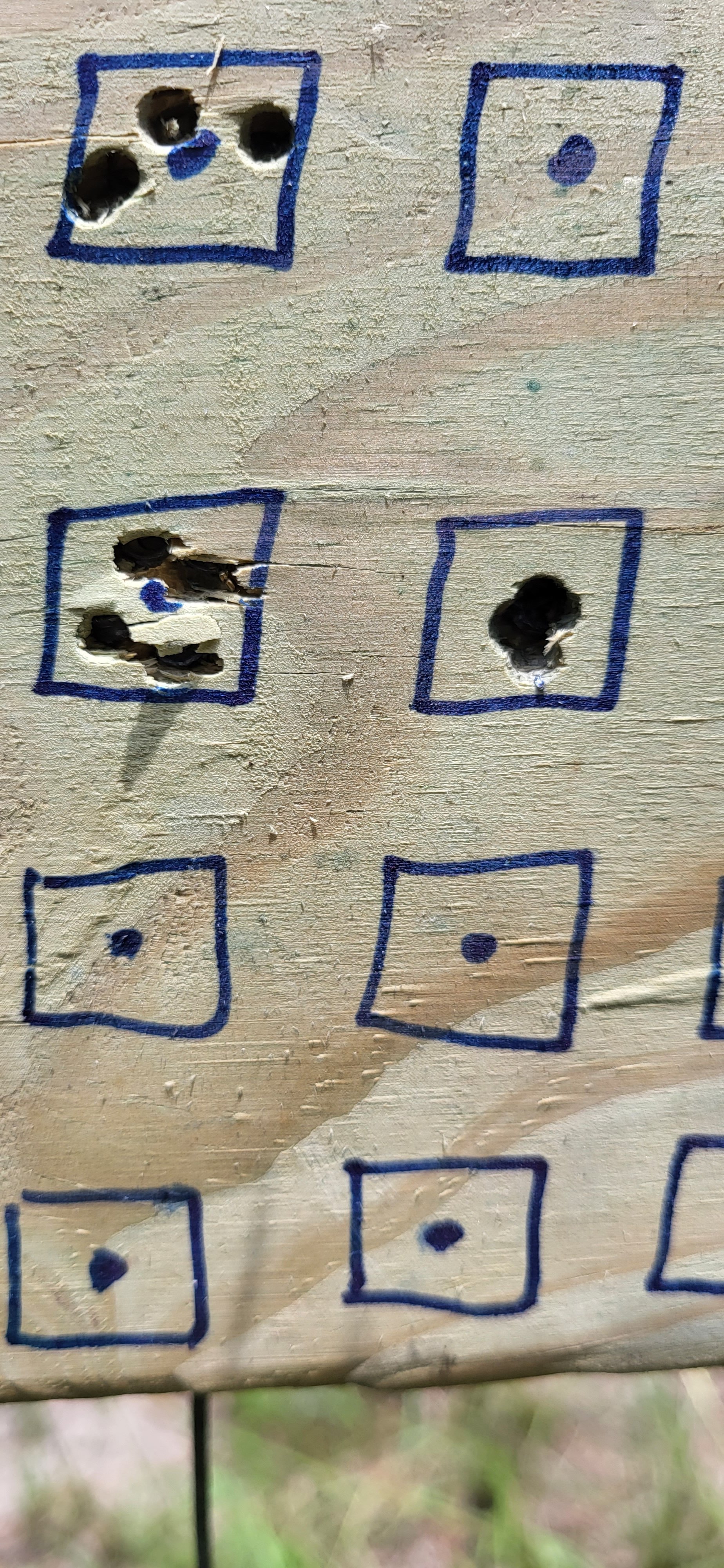

Another good example...I knew within three or four shots that this smooth twist Bobcat .25 barrel needed cleaned...I've been shooting this Bobcat YEARS longer than that Huntsman...not sure how many shots since last cleaned but note the difference...Had my wife take a picture of my favorite shooting position...doesn't look comfortable but it had been working for me for years...the two groups were shot during this session...from
this position.
