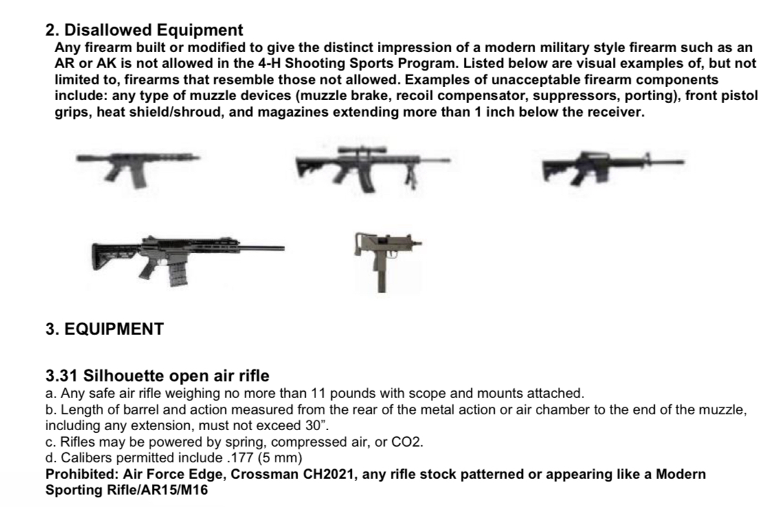

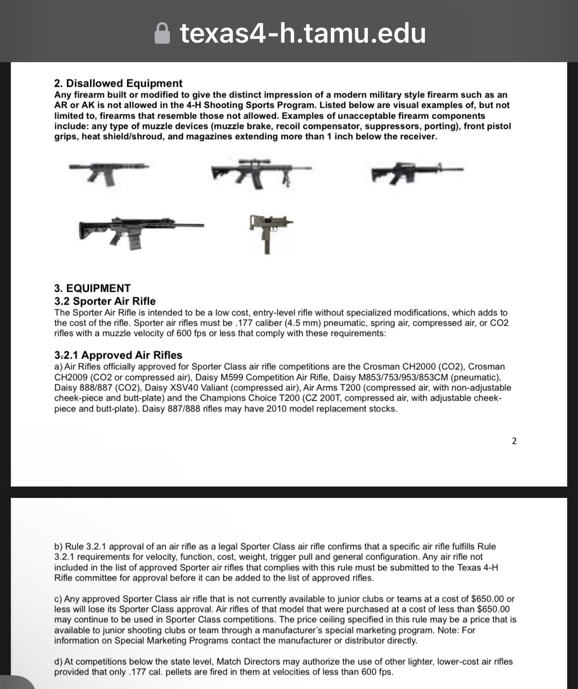

Unfortunately in the match we just we just went to the kids could only use the Crosman Challenger 2021 in one of the matches. The 2000 and 2009 were ok to use. I’m trying to post pictures of the rules as the crosman challenger 2021 was explicitly prohibited.

The first two pics are out of the Texas 4-H shooting rules. The last was from his competition.

They don’t allow the Air Force talon due to the chassis style. But I’ll look at the avenger. Thanks for the suggestion.
