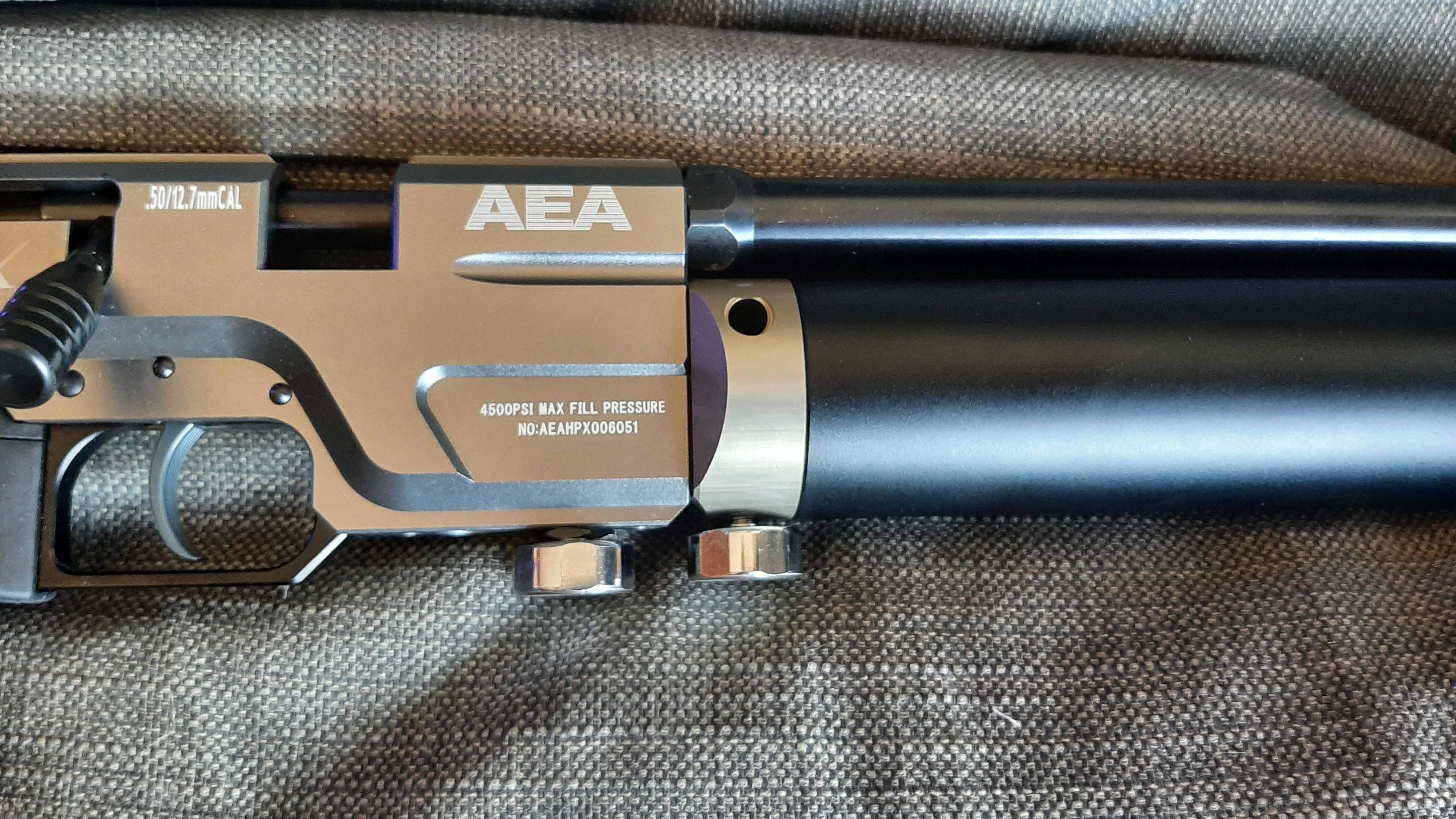

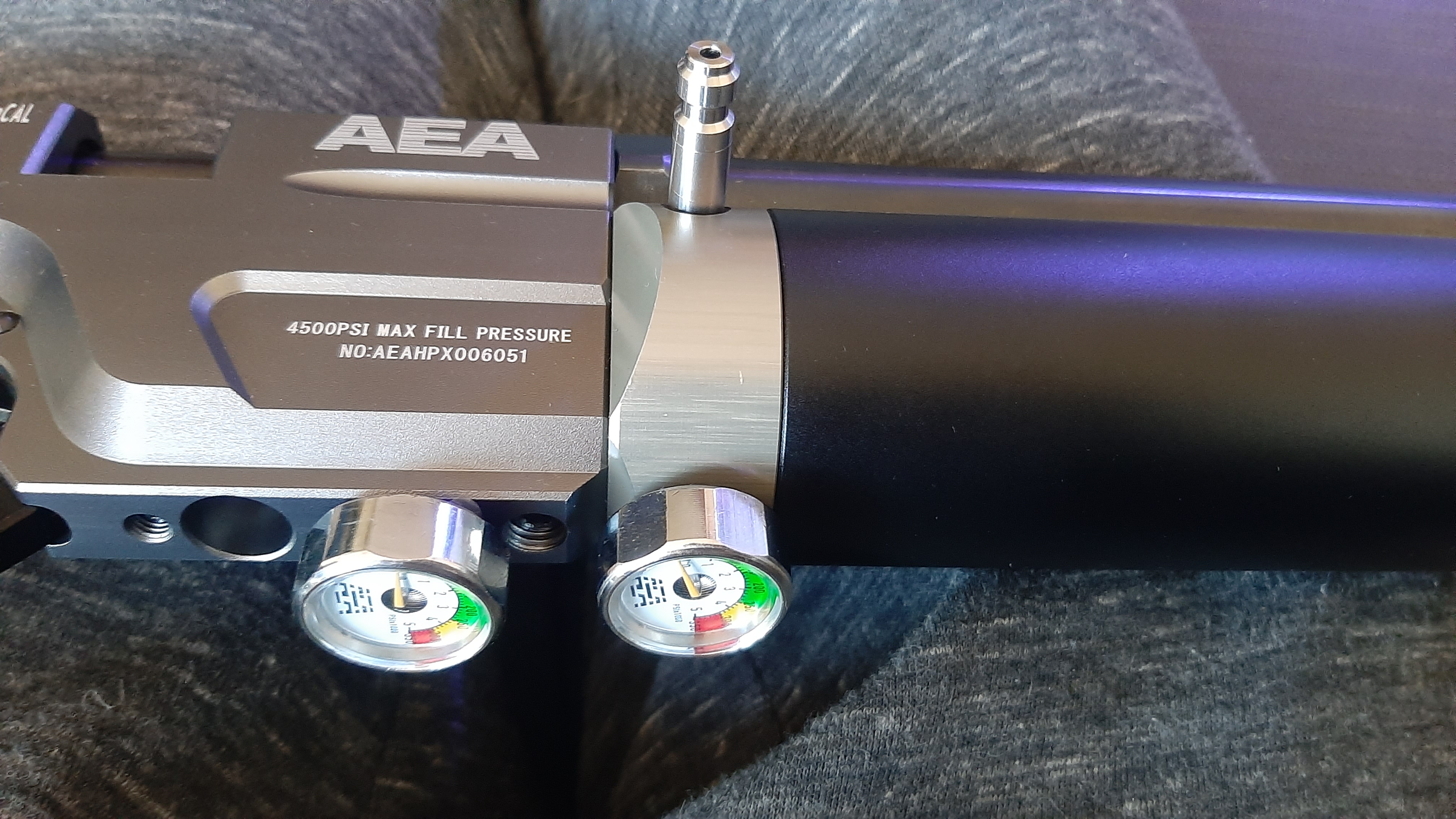

Received my HP Max .50 today. There seems to be some differences with the normal US version.
It has 2 gauges at the bottom and the fill port is on the side of the tube.
Does this mean it has a regulator? No manual with the gun, so totally in the dark here.

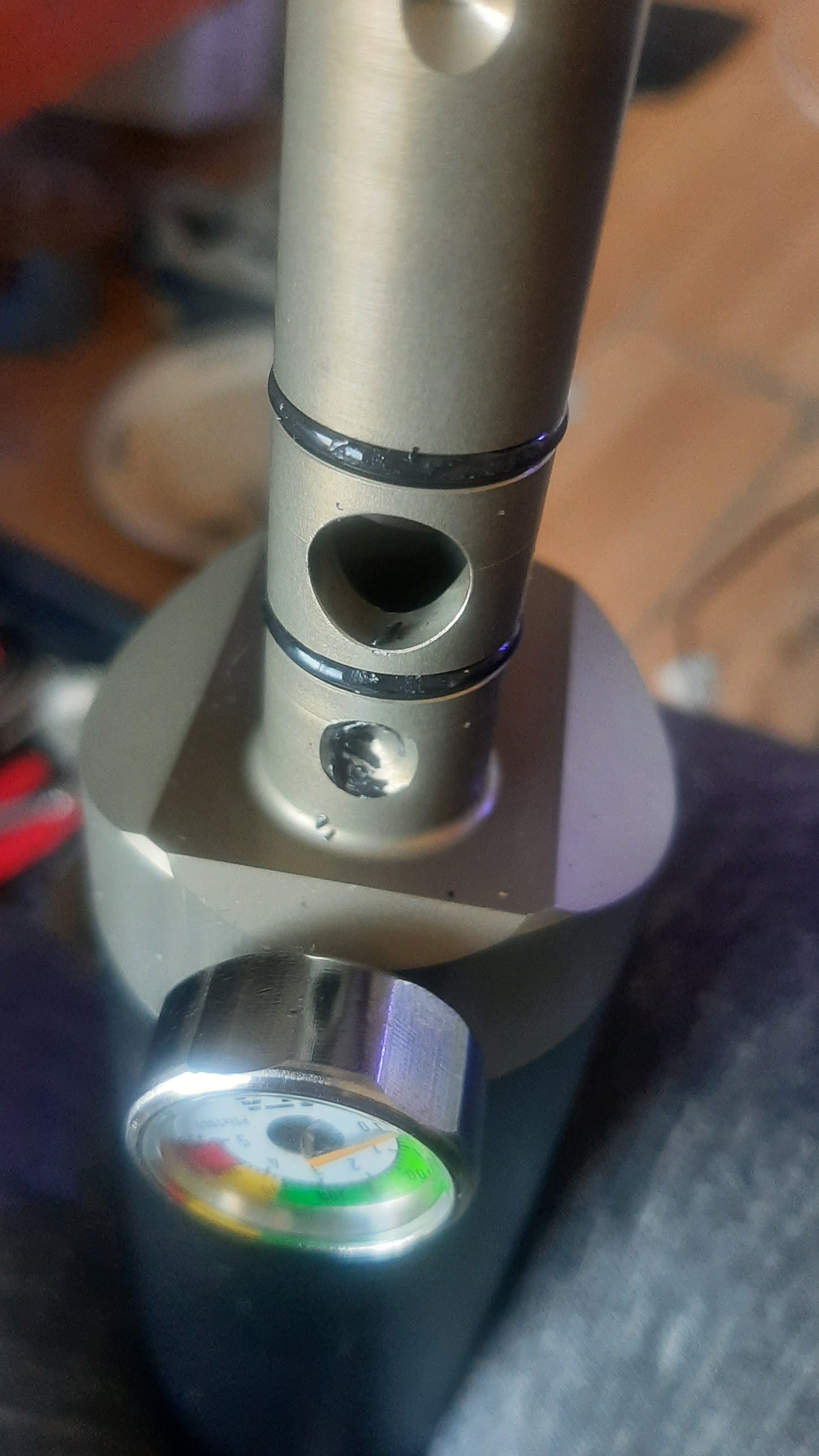

I checked for myself what's going on here so removed the airtube holder from the breech, by losening the allen bolts. Well, for starters somebody at the factory thought it was a good idea to insert the airtube holder while the allen bolts were already turned in, because they destroyed the o-rings. Rubber all over the place. Nice!

Do the gauges read the same value? When one drops by say 50 bar does the other follow suit?

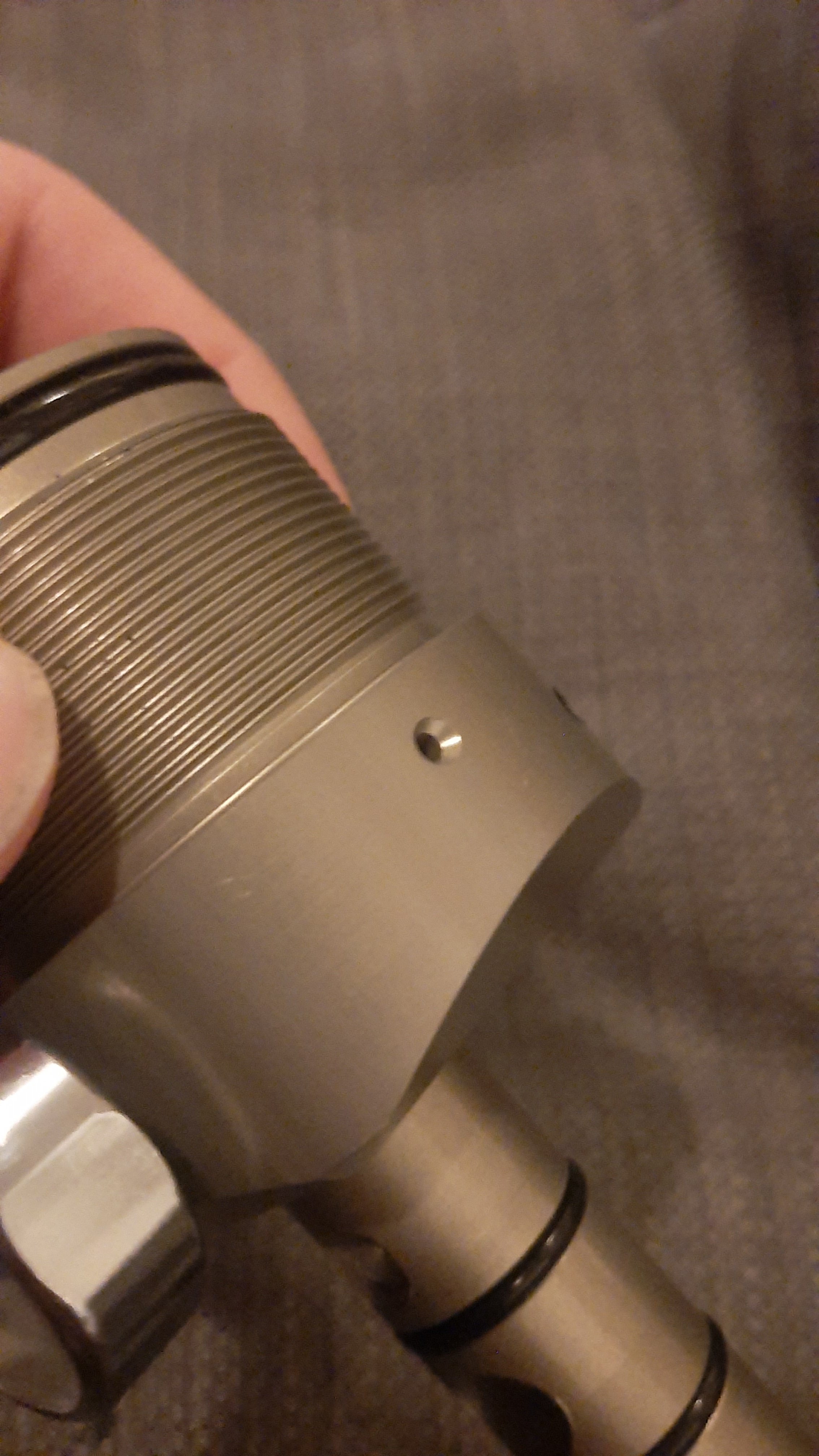

O-rings are finito so can't fill the gun. What also is missing is what it seems like a very tiny allen bolt for degassing the airtube so it wouldn't hold air anyway.

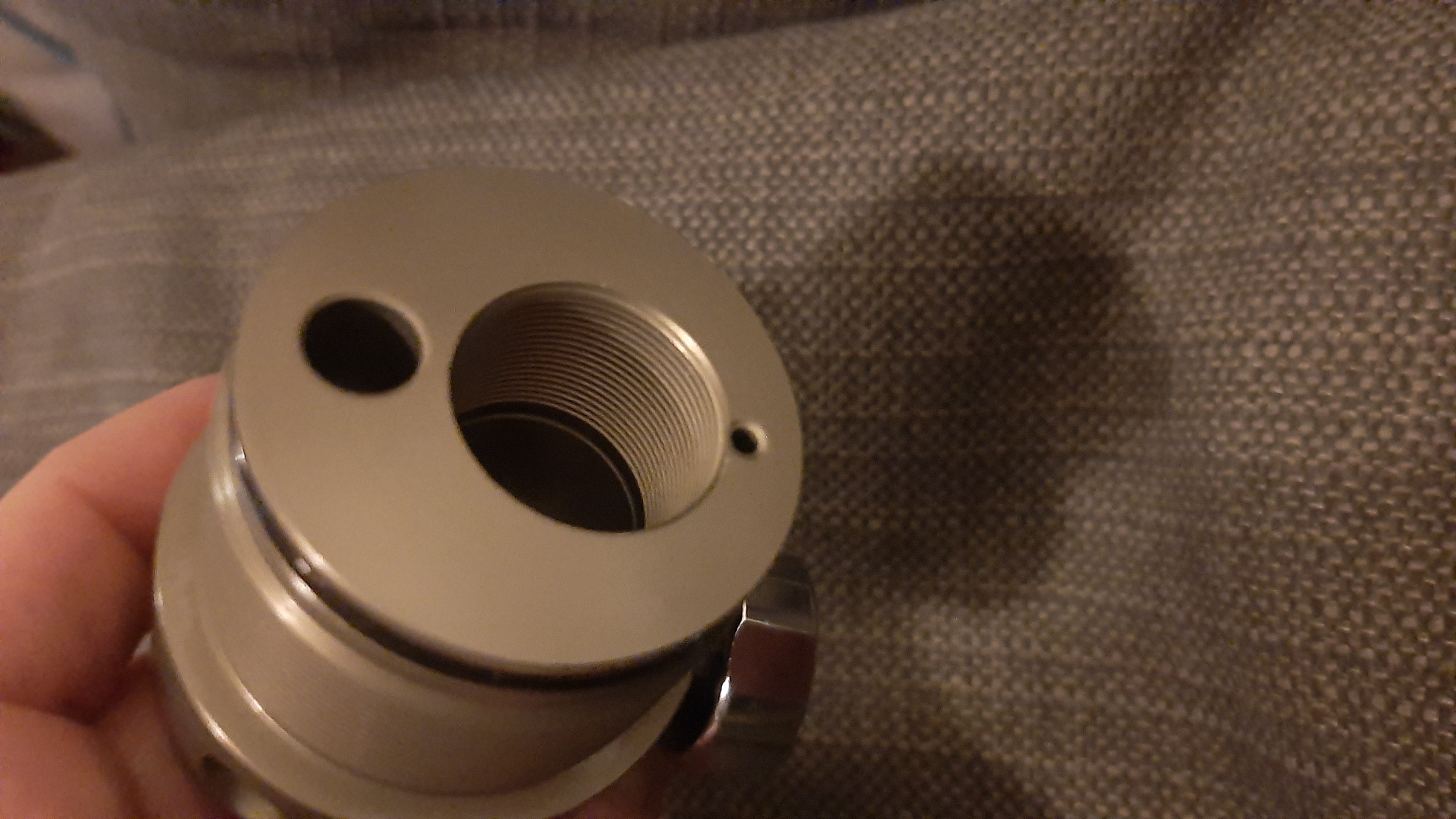

Removed the airtube and there is no reg inside, but it looks like there is thread for a (later optional?) regulator.
See picture 1.
On picture 2 you can see the small hole which i thought was meant for degassing the airtube and missing a little allen bolt (because you can look from the outside to the inside), but the hole has no thread!
So what is missing there? I guess here you will be able to adjust the regulator from the outside.
It looks like i have some kind of the first ones that has the option of placing a regulator, but they haven't finished it/it's incomplete!
Without some plug that closes the small hole, i will never be able to fill the airtube.

AEA Spain tells me they are going to send me a "plug" that will close that little hole. They don't have it yet, it must come from China.
I wonder what plug that will be because the hole has no inner thread.
They didn't explain my question why it has 2 airgauges and if this has something to do with a regulator, they just say "it has no regulator".
All clear now. This was originally a restricted gun for the European markt with a built in fixed regulator. But where i live, Netherlands, power is unlimited. So what AEA Spain did for me was take out the regulator but this leaves a small hole.
They want to send me a "plug" to close this hole, but i already wrote them this isn't gonna work because there is no thread in the hole.
Also i don't want 2 airgauges, that's just stupid if it hasn't a regulator.
So i asked them if they could send me an unregulated airtubeholder with the fill port at the bottom and just 1 gauge, this would solve my problem.
Else this gun is going back.
I saw on Youtube that more people have this issue.
Yours might still hold air, but as soon as you pull the air tank holder out of the breech the chance that you'll notice damaged orings is big.
It's not an assembly fault i thought it was, it's a design fault. The ports inside are very sharp and cut the orings if you shove the tankholder in the breech.
