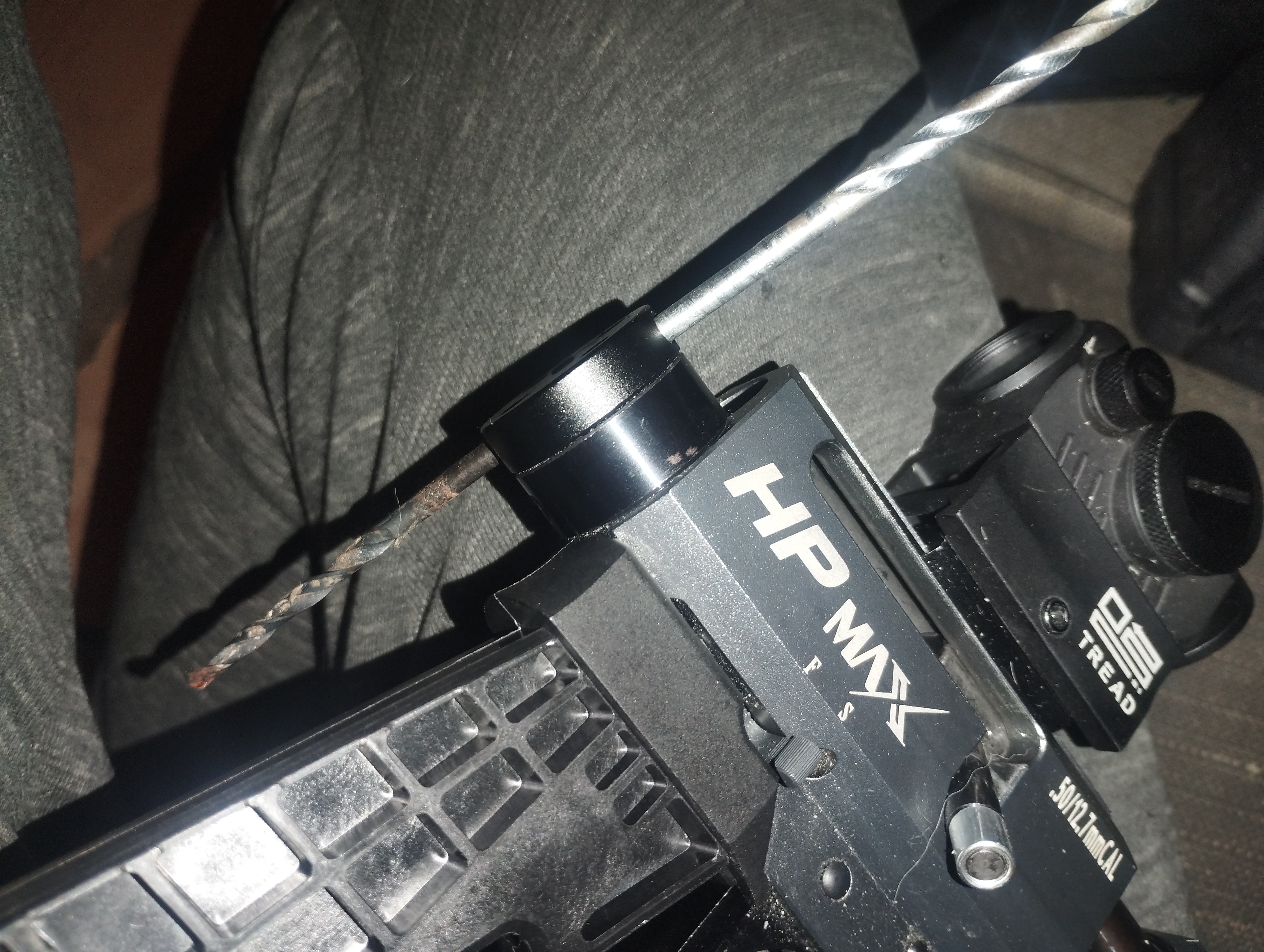

It was pretty easy. You have to take the stock off. There is a little Allen head screw in the back if bolt you back off some to pull bolt handle off. There is a small screw on side of bolt you take off. Not to bad.
How do you take the stock off, like this? I put 2 drill bits in the side holes so i should be able to turn it loose but it is tight a f.
