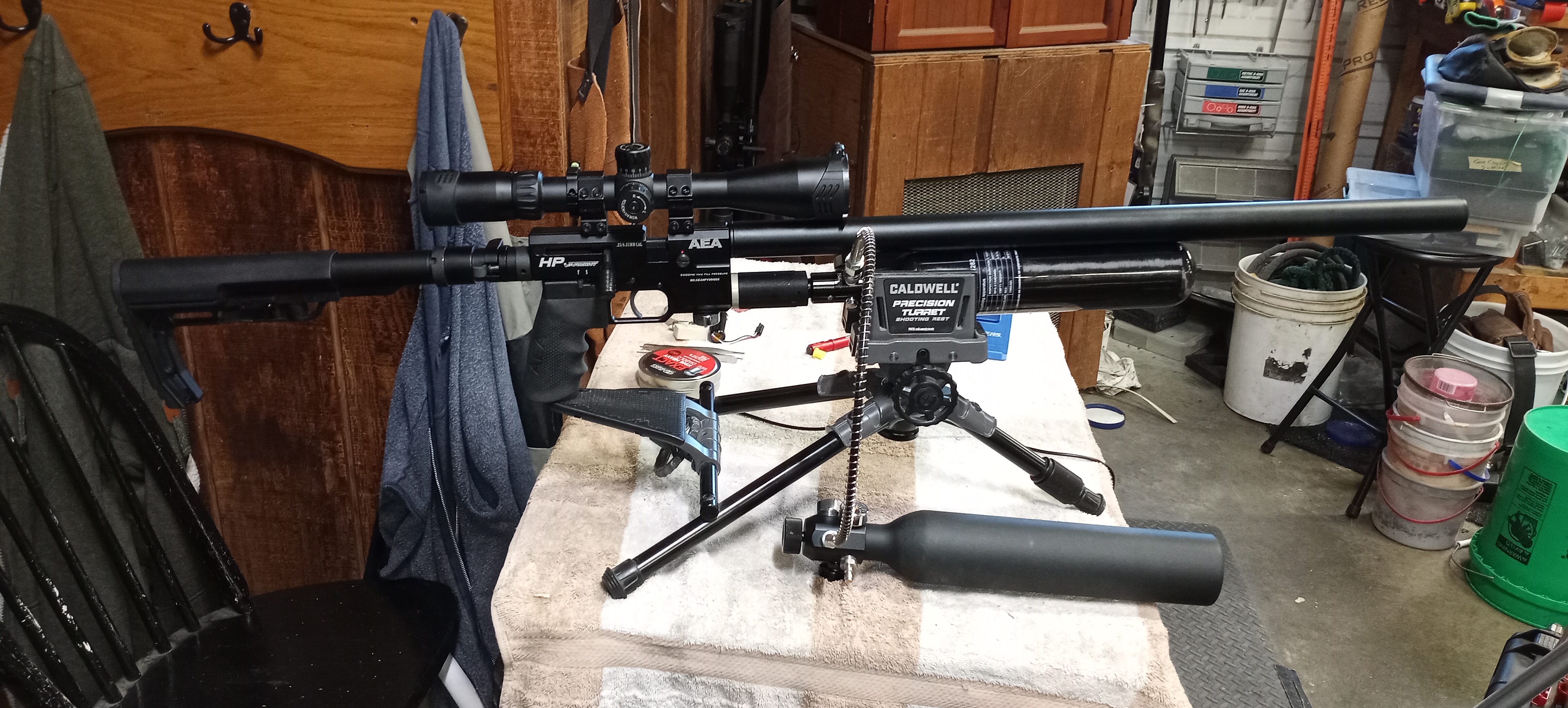

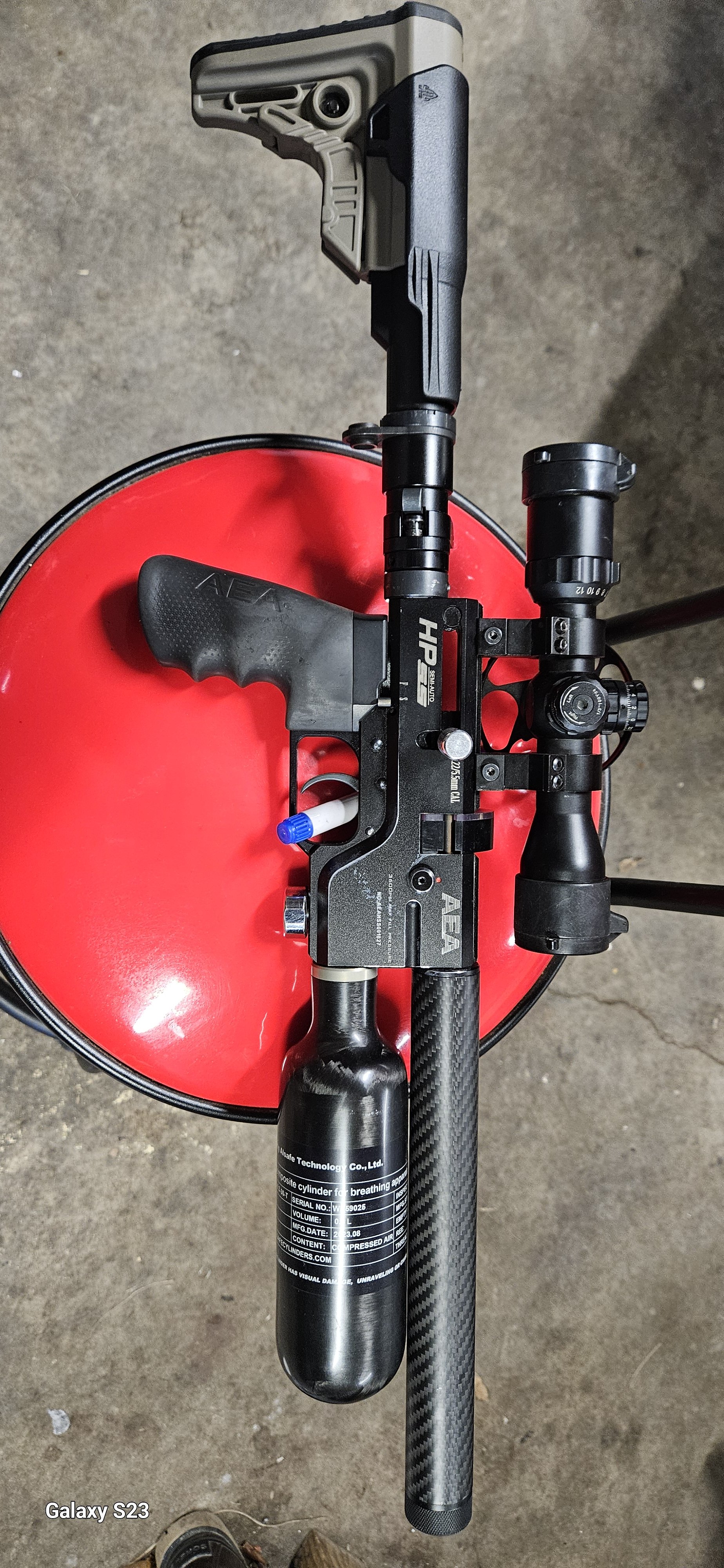

Need one of those. As Firewalker said you can regulate them also. He gets twice the shots as I do with his regulated system. Get a carbon fiber bottle. Mine is .3 liter. A .35 would work Perle has a .35 on his.

That adapter has an M18x15 thread which connects to the air bottle.
How do you attach the other end to the AEA HP receiver?
Would a 60-62 mm diameter air bottle fit?
Or what diameter would fit?
Also, how do you attach a regulated bottle (since the adapter will not fit the regulator) ?
Beside the air gauge is a set screw. Loosen that and the air cylinder slides out of the receiver. Screw the adapter into your bottle and push the adaptor end into the receiver until flush. Make sure your adaptor holes are aligned to where your fill adaptor can be inserted. Tighten set screw. Yes a 62mm bottle will work.
Im sure you know this but make sure existing bottle is void of air before you proceed. If you look closely at the adapter you see an indent then two holes. Indent is where the set screw secures the adapter to receiver. The next hole feeds the air gauge, hole after that is the fill port. So adapter threads screw into bottle, make sure oring is in place. Then from bottle out you have indent for set screw, hole for gauge, and hole for fill port. Slide that into receiver. Clear?
Reactions: nobody1 and Perle
