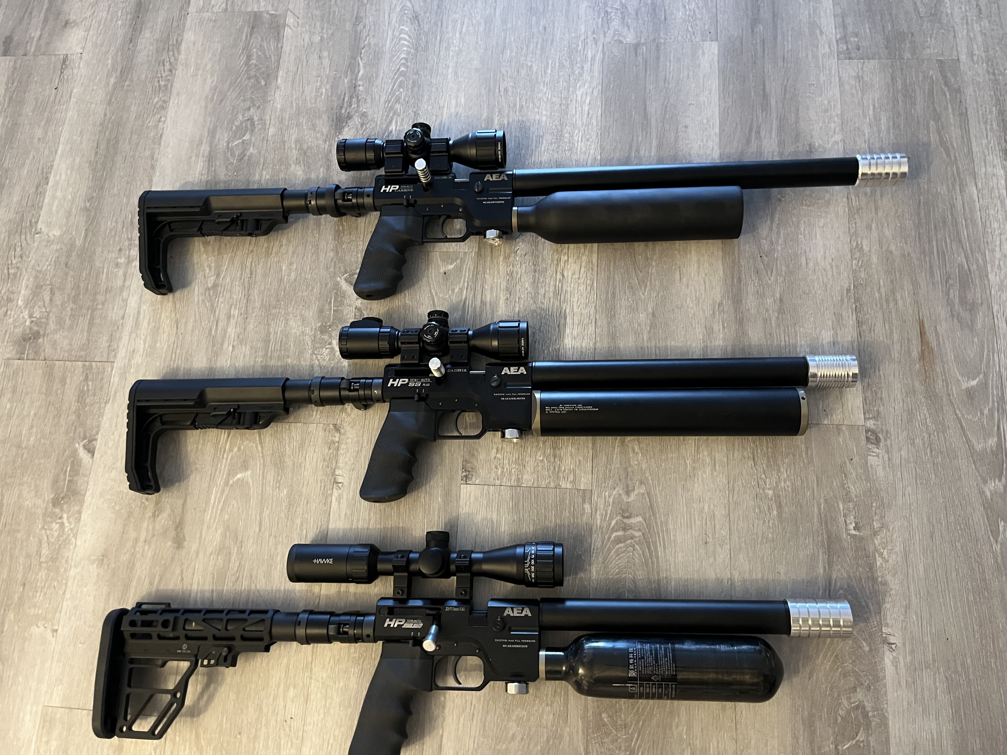

AEA HP SS .25 decided to go Full Auto!
Well once they are sorted out they rock the house. It’s a lot of gun .. small , powerful and accurate. It’s not for the uninitiated it seems. YMMV
😆 What is it about certain folks here that make them want to insult other members over an opinion about an airgun 😆
Far from from "uninitiated", my friend. I just don't like things that are junk straight out of the box. Having to tune, tweak or even smith a gun that is lacking in areas is no problem, but there's more than enough evidence here for anyone who isn't wearing blinders to see that AEA is hot trash. I'm not about to buy something in which the engineering is so flawed that it jams and dumps in full auto for any reason, let alone multiple reasons, period.

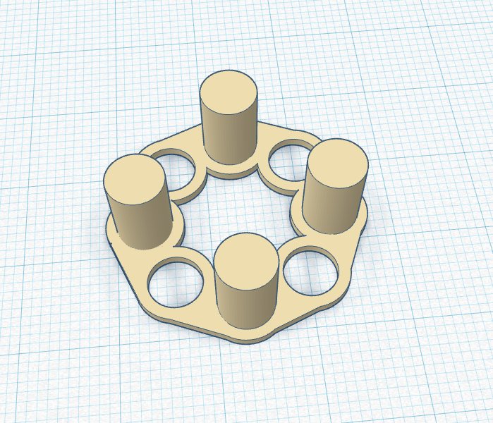

It is the magazine spring! They are using a very weak spring and on top of that it looses tension fast.
The next pellet should be in position way before the probe returns after the blowback, but its not.
This airgun needs very good synchronization in order to work properly and they messed up.
They should have used a mechanism to cycle the magazine not with a spring but with the probe
action. Very bad design.
Anyway, I did not have any stiffer spring and if you try to install it in the magazine by turning it
twice, it will slip from the tiny hole. What I did was to design a small choke that will limit the
blowback air in half and insert it on the front 8 hole cylinder.
I have now emptied the magazine 8 times and I only had a single jamming, so its definitely the wrong timing
caused by the weak spring!
The current spring has a 0.6mm thickness. I will try to find springs with 0.7mm thickness and try again.
