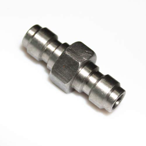

Need some info on tanks. I found an paintball field that can fill tanks to 4500psi. They informed me as long as the tank has a gauge and the right connector they can fill it for me. My question is: Do the tanks have the same fill port as paintball HPA tanks? I have no knowledge of this stuff, I am learning as I go. I have not bought a tank yet but am looking. Currently I have a Maximus .22 and a hand pump.
First knowing your gun use a male 1/8 inch foster style quick connector and the hand pump fills the gun with a female 1/8 inch foster quick connector. When you get your tank you will need a fill hose ending with the same 1/8 inch female foster quick connector same as your pump. What you will need to purchase is a male to male 1/8 inch foster adapter like this.
to connect your tank to the fill station. I have my own scuba compressor and it is setup with the same way so I connect my tank to the compressor with the same type of male to male adapter. Hope this gives you some idea.
Jack
