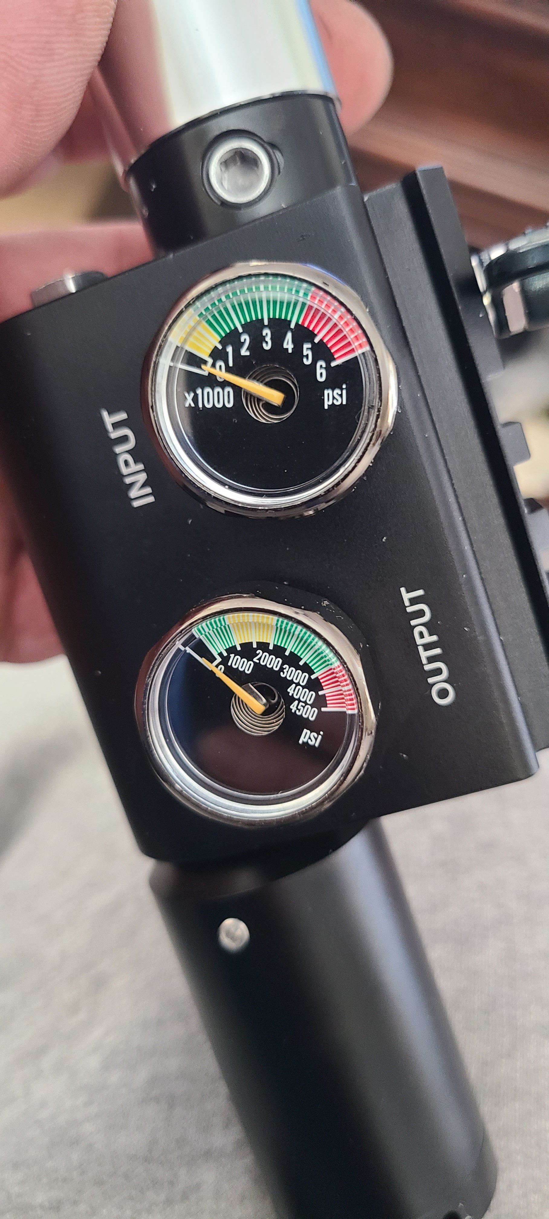

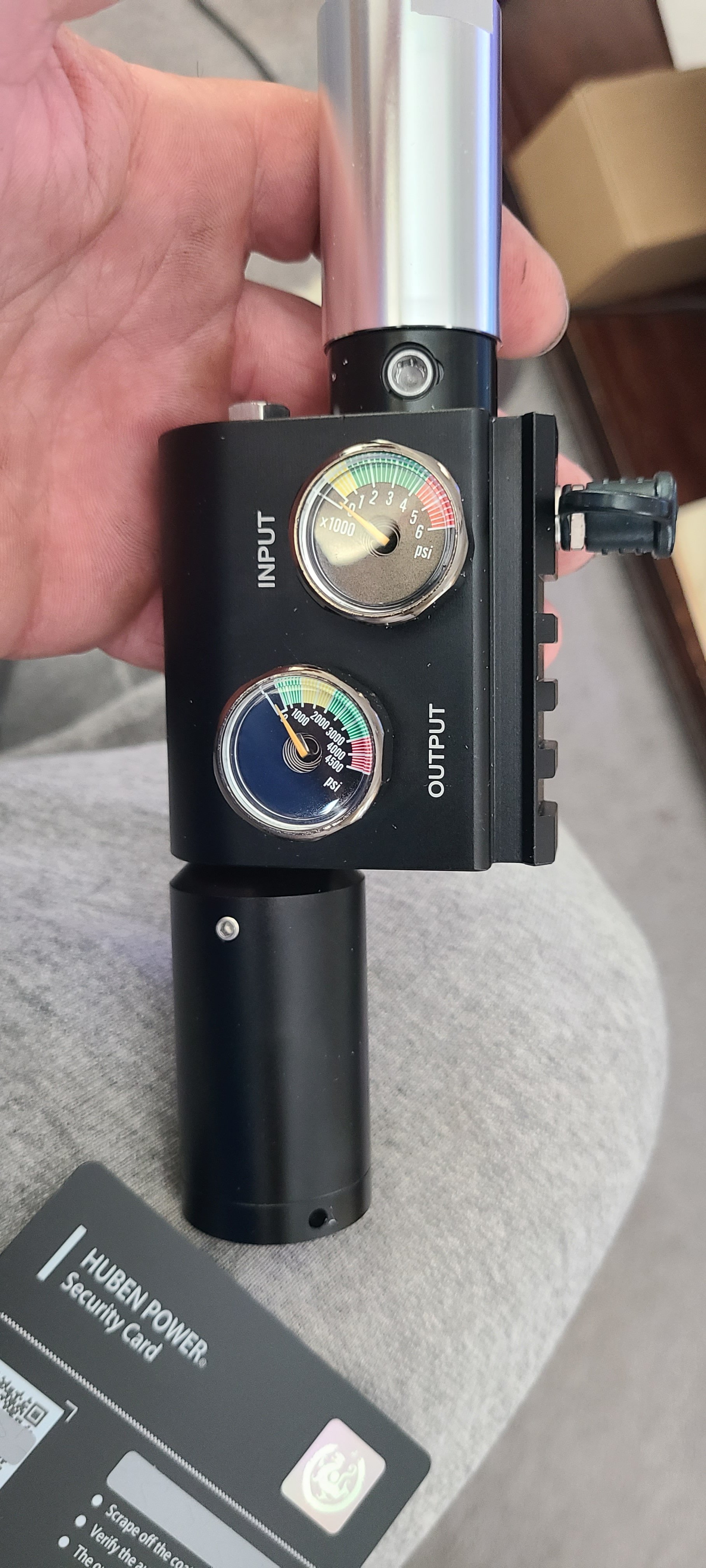

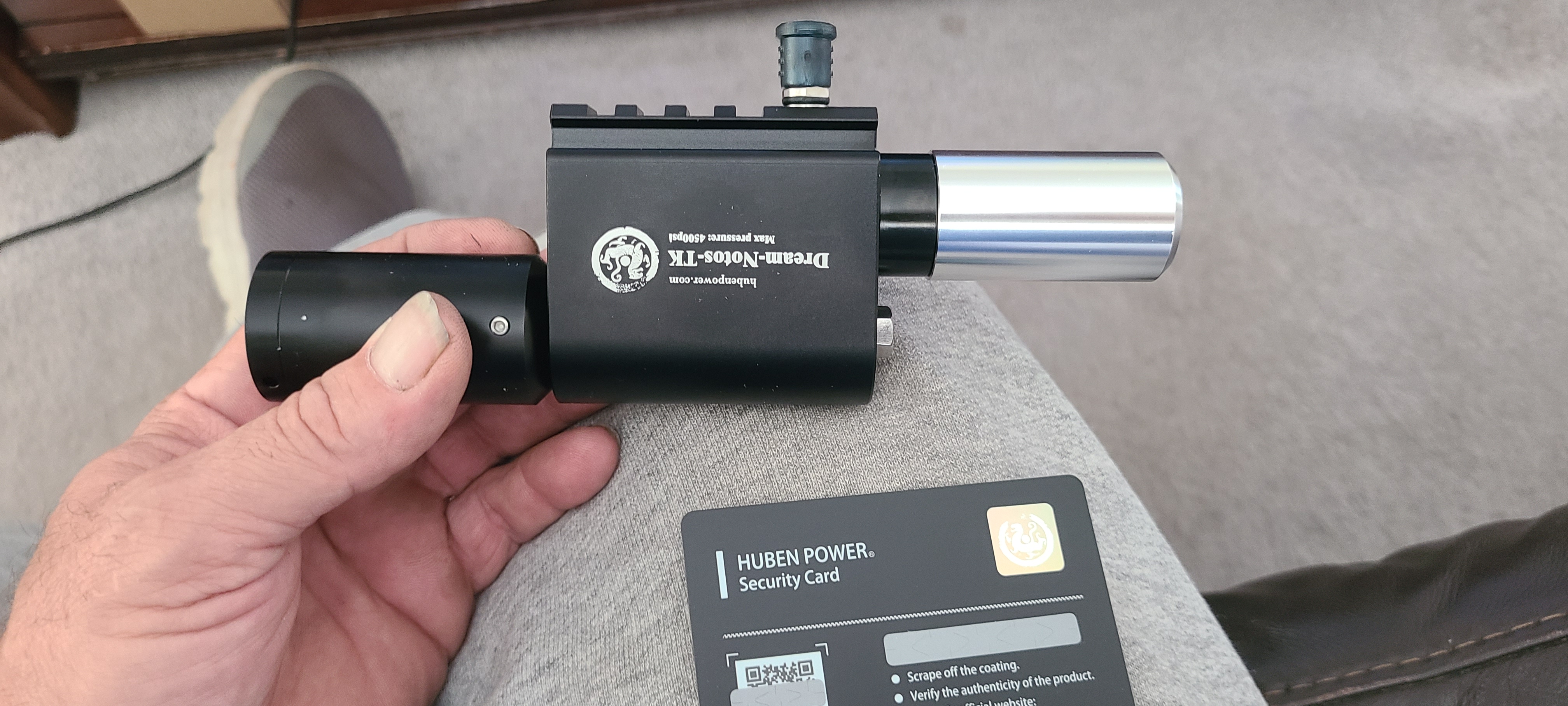

Finally got the Huban dreamTk
Little different gauges are in
PSI which I like better also has the pickney rail and both gauges are on one side staggerd
Fig is share for those who asked

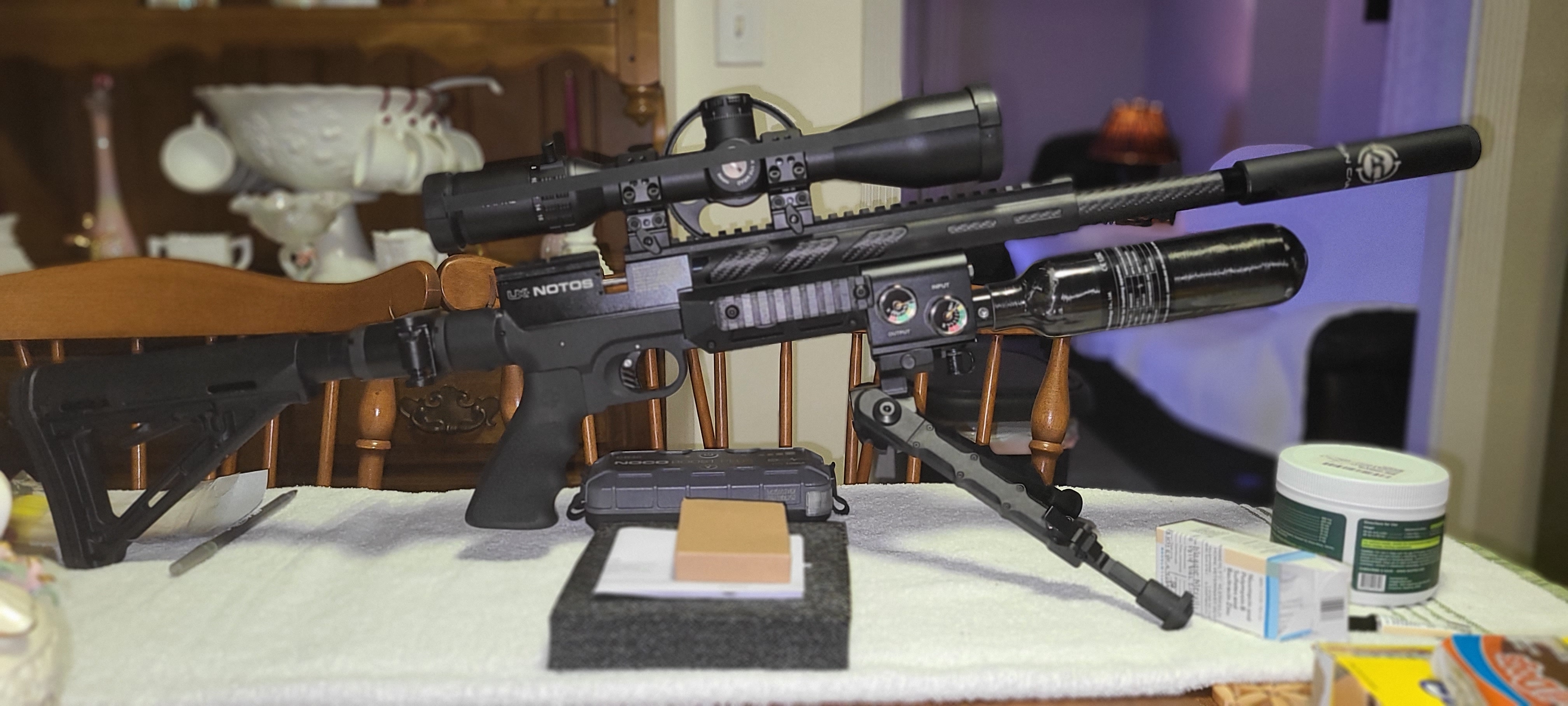

Well 6 hrs later she's almost done

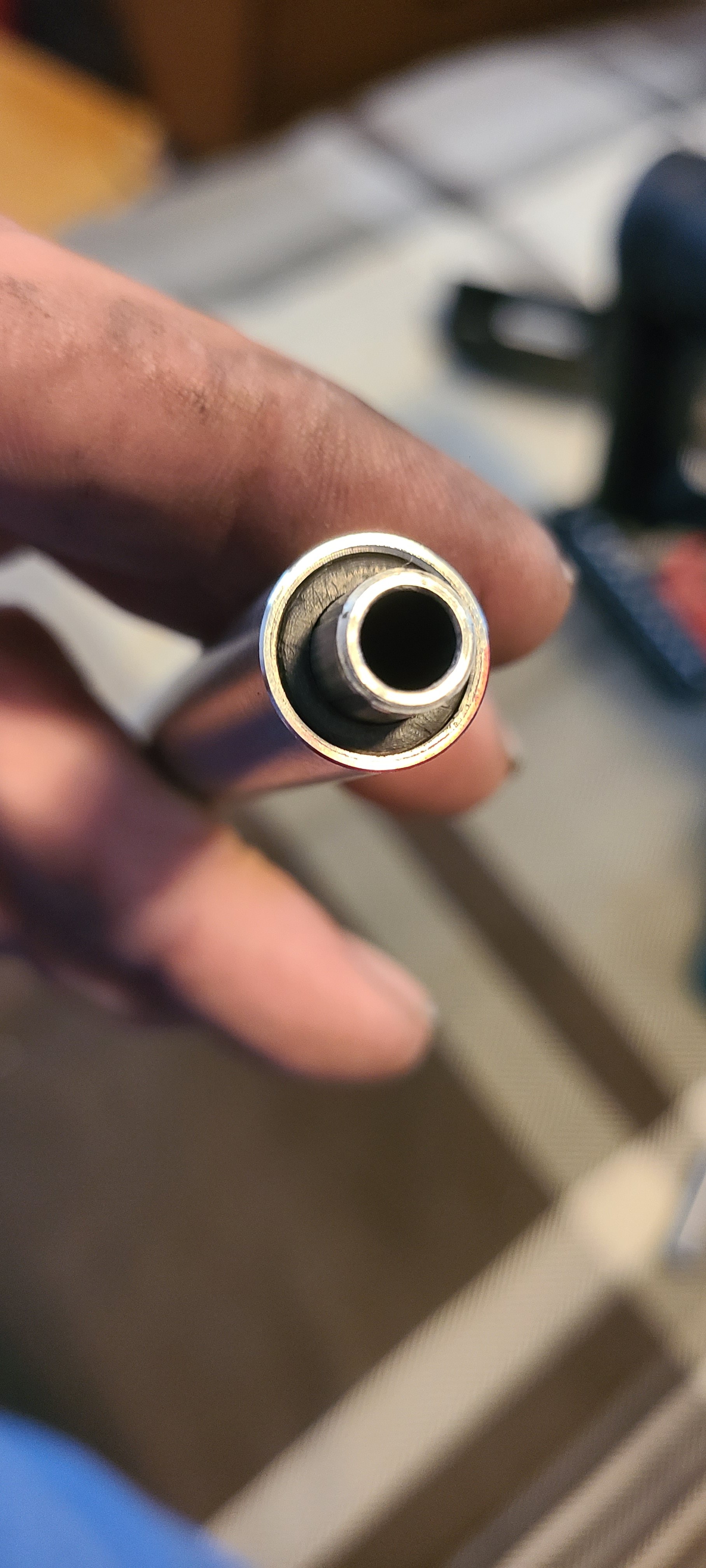

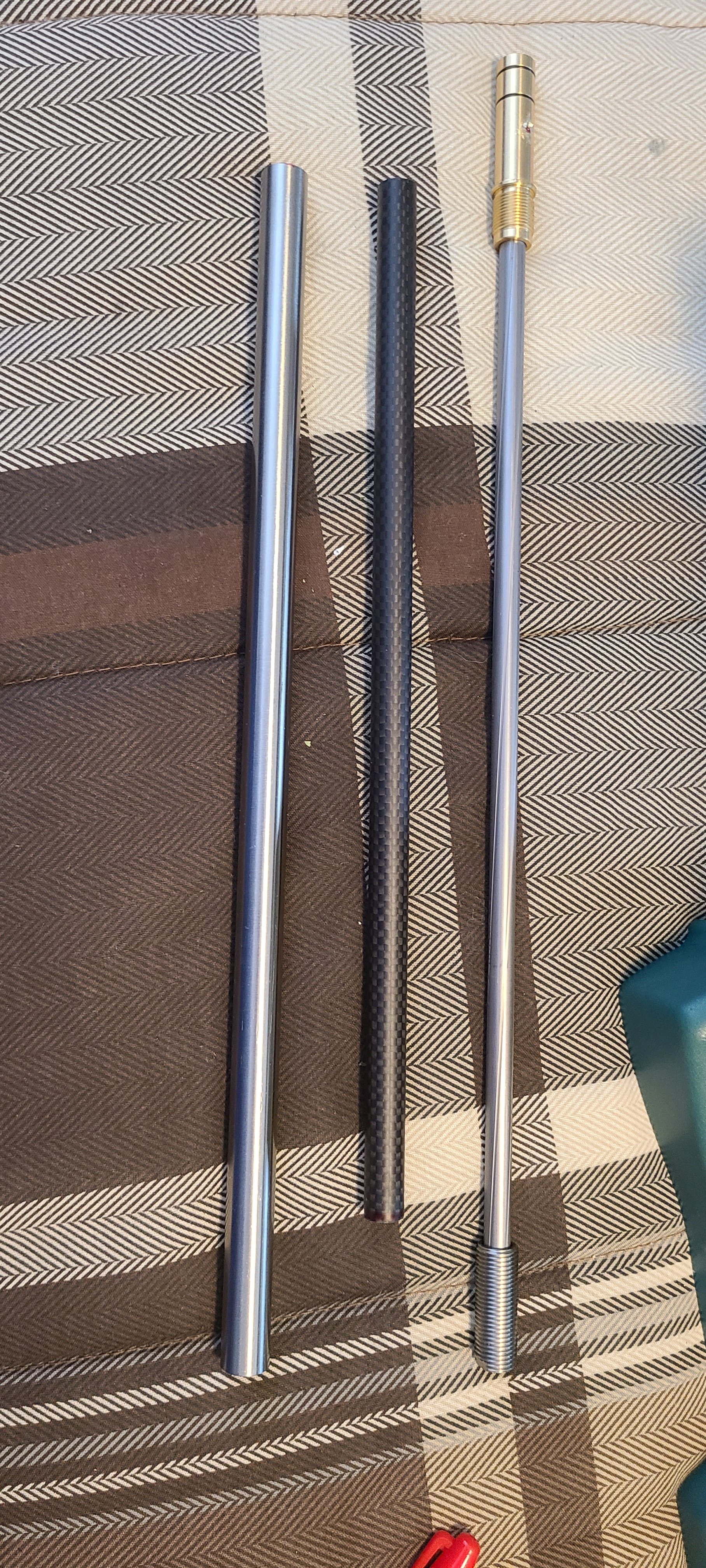

Added a second plenum to the tk dream valve cut down the hand guard also installed a fx cf barrel stiffener
Having a bottle support made and she should be done

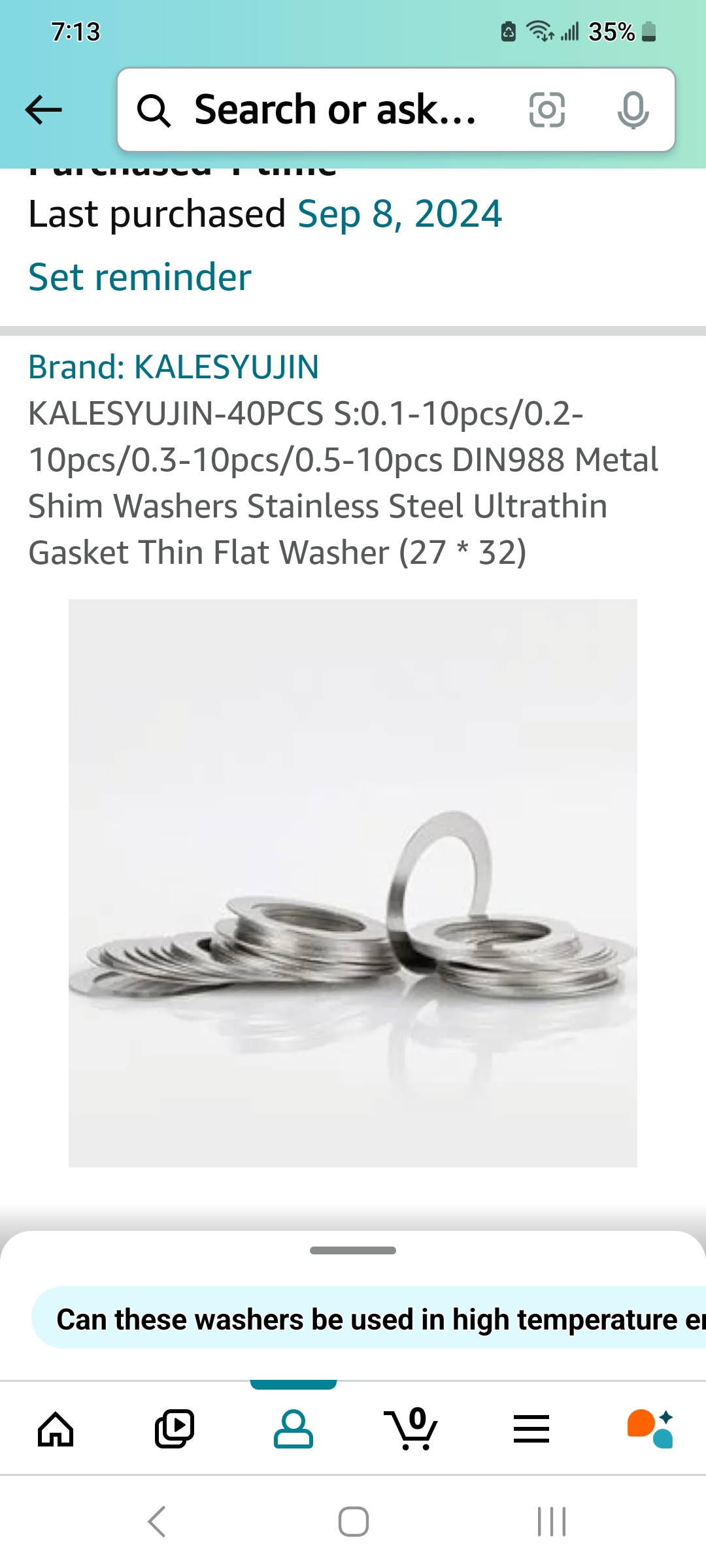

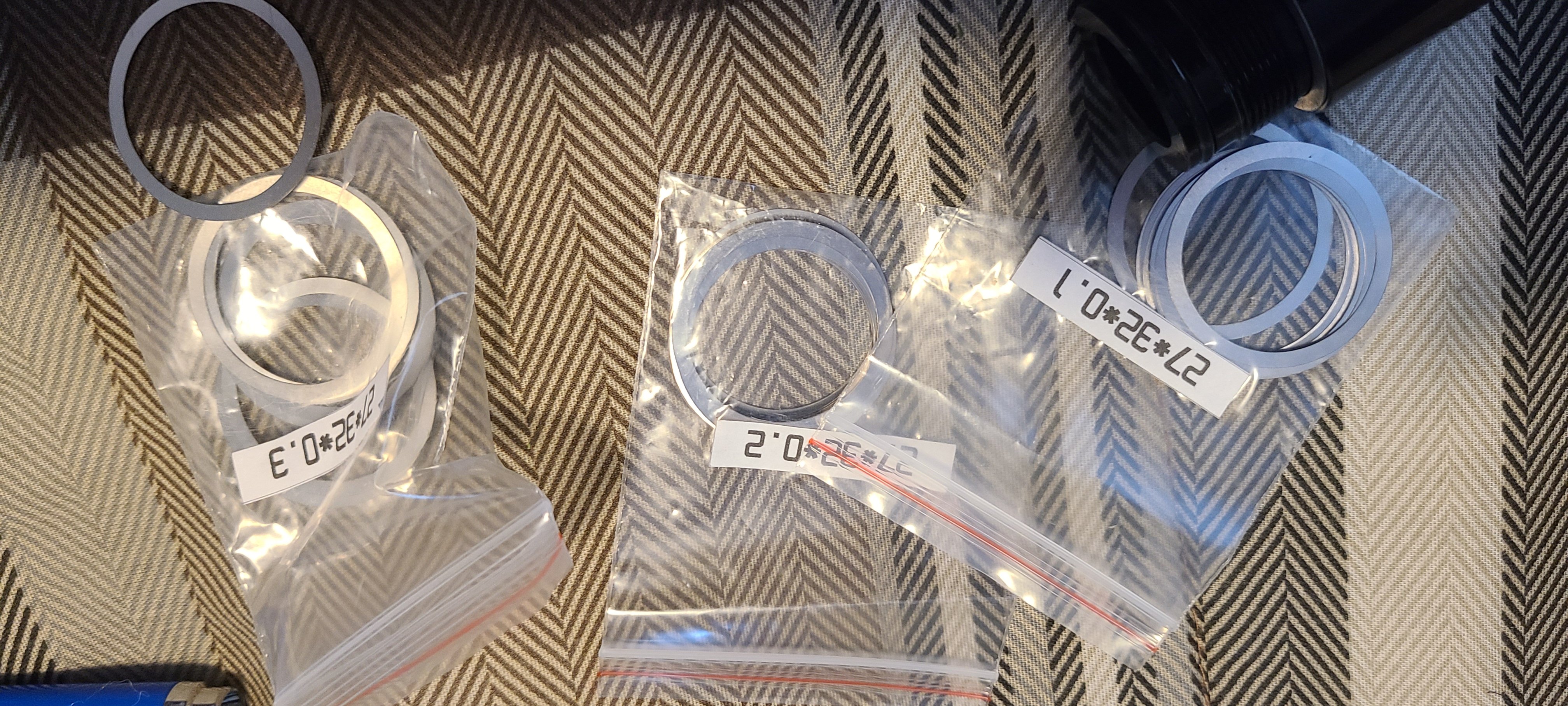

For those guys sanding to clock a plenum extension on a cricket these ss 27mm I'd 32mm.od come in .01mm 02 and up just unscrew the plenum cap throw a shim.on screw back together and it's re clocked just fig I'd pass this on

Where did you get those shims?
well i can say i do like the bottle set up its heavier but well-balanced front to rear

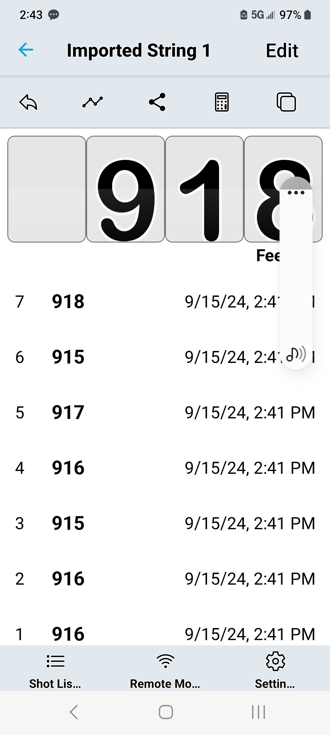

at 2400sh psi it was shooting 950-958 seems to like 15.89gr they group nice
I'm sure if i went to the Crossman 14.3 it would pick up fps but I'm pretty much set where it is,,, those group nice as well.

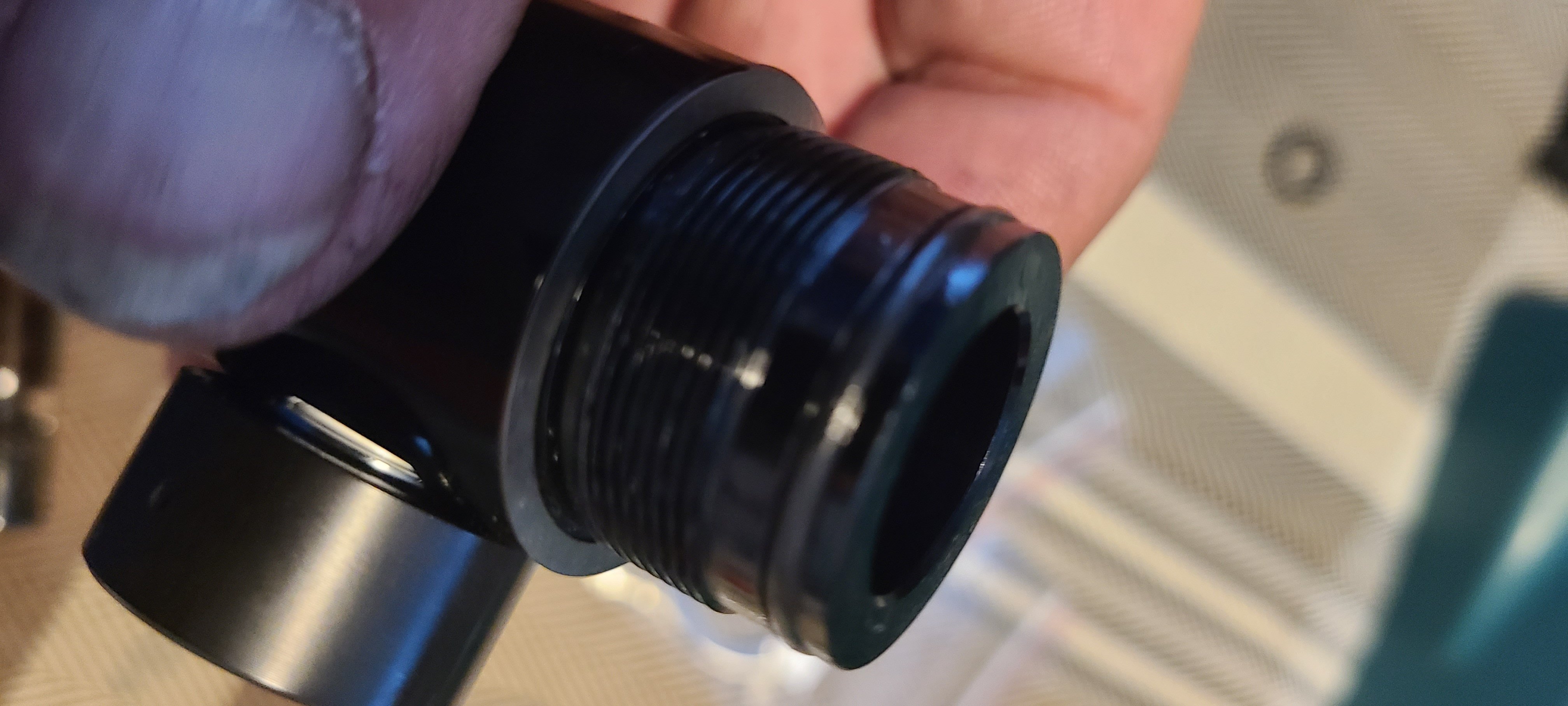

i tried the valve with just the plenum extension it comes with,,,,,, shot 2 strings
then added another plenum extension C88 Machines. you just need to use a skinnier o ring because the bevel on the Huben plenum isn't as nice or deep as C88 Machines.
what is weird is it didn't pick up fps but picked up 3+ almost 4 Fpe if that makes any sense got me scratching my head on that one
only thing i can think of is the volume of air behind the regulator or possibly the venturi affects going from 1in id to 12mm back to 1 in like a merge collector on like my drag car fig that later.

only thing it seems to have a very slight wabble not much but enough to bother me
those 2 little set screws it seems to rock very slightly when no pressure when pressure is applied it don't move
prob cant with 3500 psi behind it.

other than that, cut my buck n rail hand guard down to fill the void of 2 plenum extensions seems to complete the gun
now just waiting for a custom-made barrel band found a guy on Ebay just need to give him some dimensions
he sends you a proof and if all looks good print and send. what a world
anyways that's as far as im taking this gun backed it down to 912-915 stacks pellets at 40 yds no problem 38-39 fpe more than enough

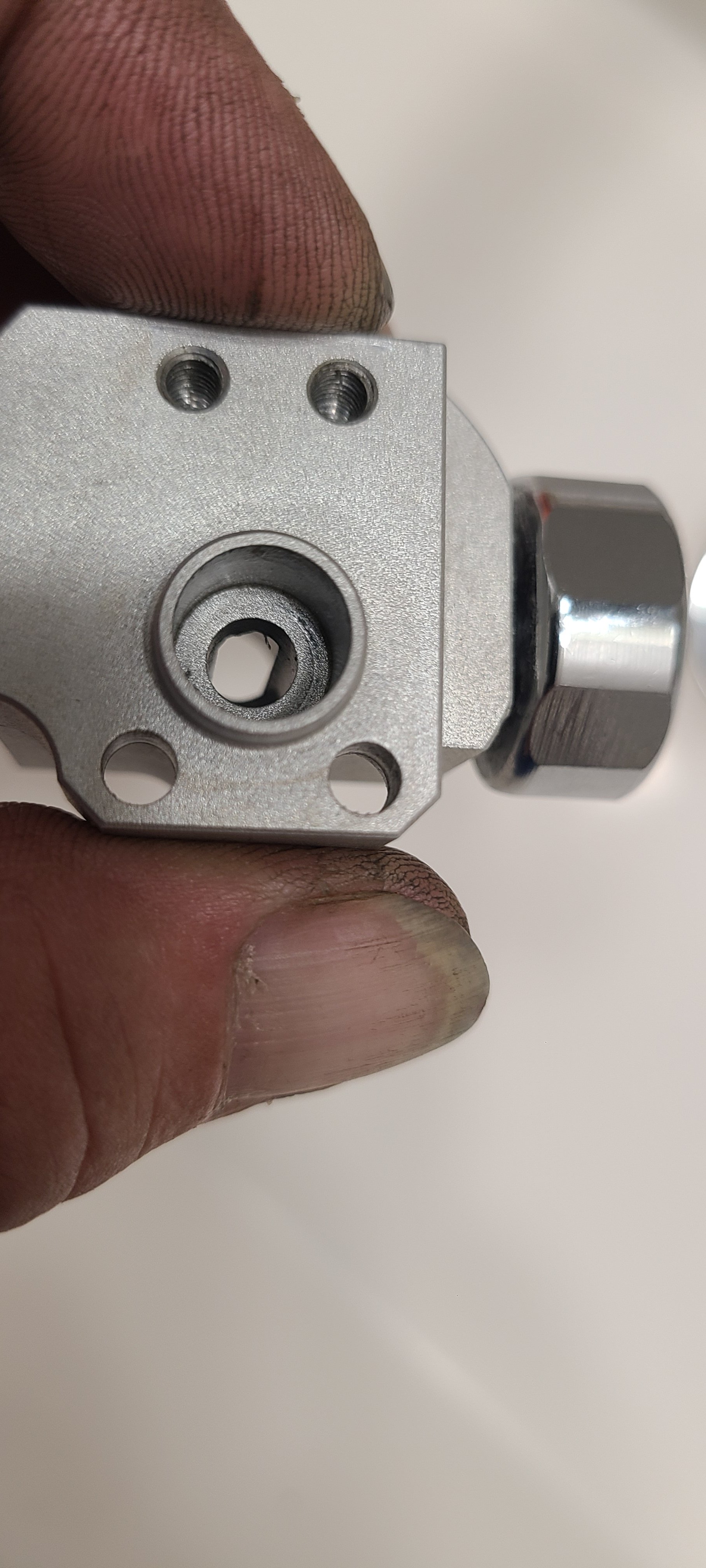

Got the gauge block to the machine shop and after looking at the port design
Im putting it on the notos
Also going to finish porting the main body and seat as I left those alone so this should be interesting this block measures 6mm 2 mm larger than whats done now.
