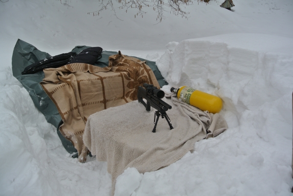

I have yet to review the swagging kit, the snow is disheartening finally. We had so much snow this year, that we have not seen in years. Here are some pictures of me being too stubborn not to go shooting on my range :)

There was nothing else to see.
