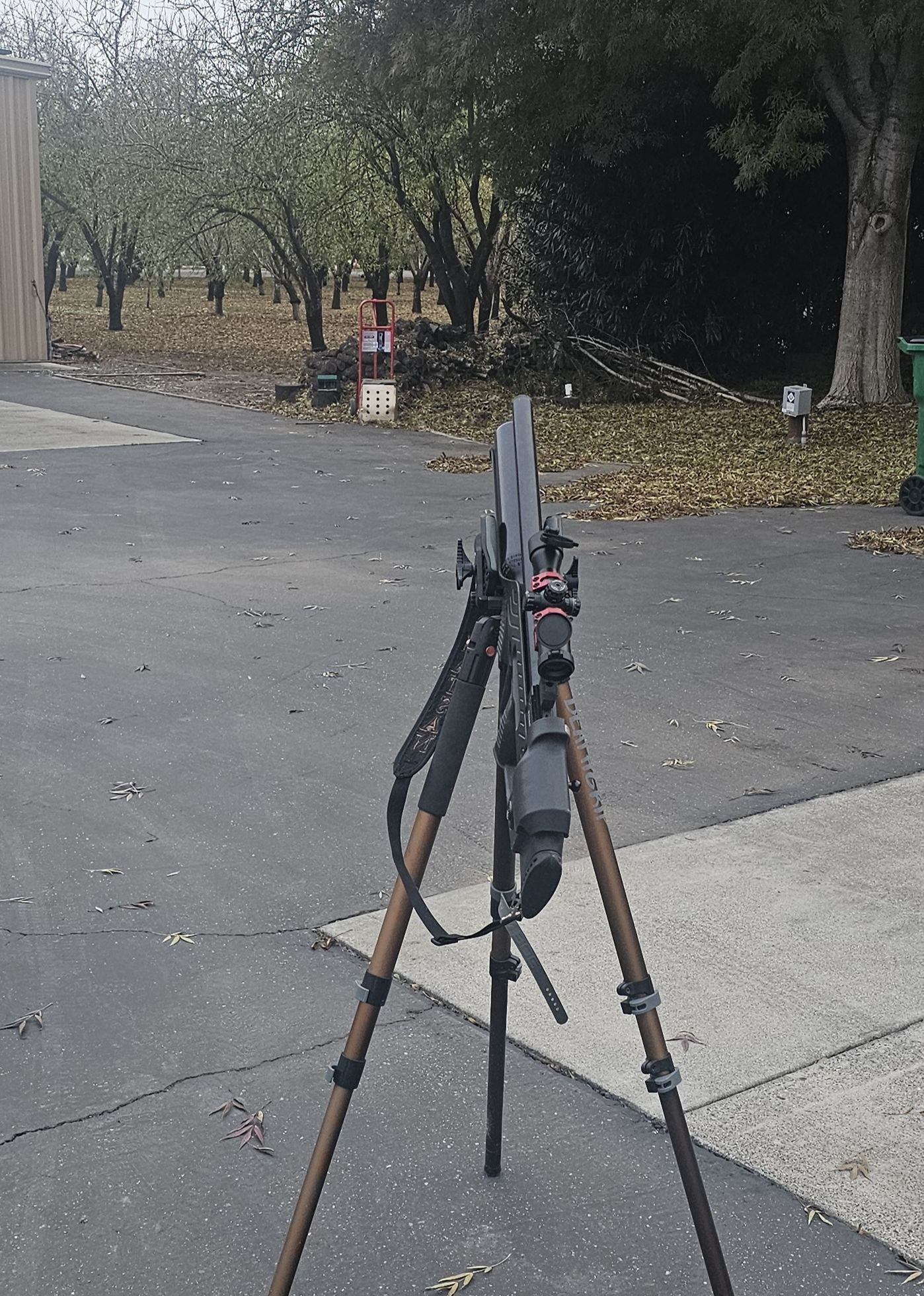

As I have mentioned, I primarily use the air pistol for hunting squirrels. I don’t have the patience to actively hunt them. Instead, when I walk out of my house, I have several shooting lanes. If I see a squirrel, or even just sense a squirrel, I bring out my air pistol from the garage. In one lane, I usually have my standing Bog deathgrip tripod. In the other lane, sits my garbage can.
And here is the shooting lane:
I dispatched many a squirrel in this exact fashion. The first tree in the orchard has a few logs stacked (about 40 yards)--there is frequently an apple from the tree just to the right of it, sitting on the log. Fun way to make sure my scope is sighted in. I have gotten squirrels on that log, munching on the apple. My orchard extends all the way out to probably 100 yards (I have gotten squirrels that far out).
