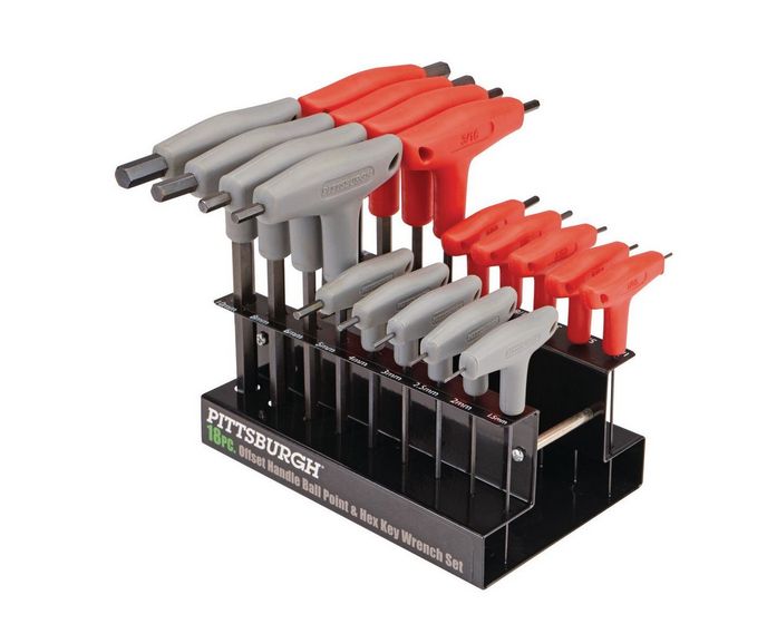

Another little side note. If you are going to be tinkering on a GK1, highly recommend getting a hex key set, and not a fold-out set. I am constantly using smaller metric units, not only just on the GK1, but on mounting rails, optics, just about anything. It is so convenient to have a set of handled individual hex drivers. I picked up this set on sale for like $12 at my local Harbor Freight.

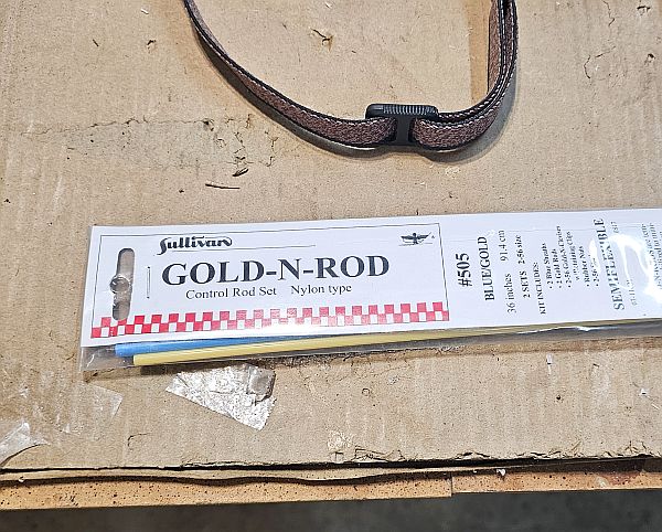

Picked up the control rods from Amazon.

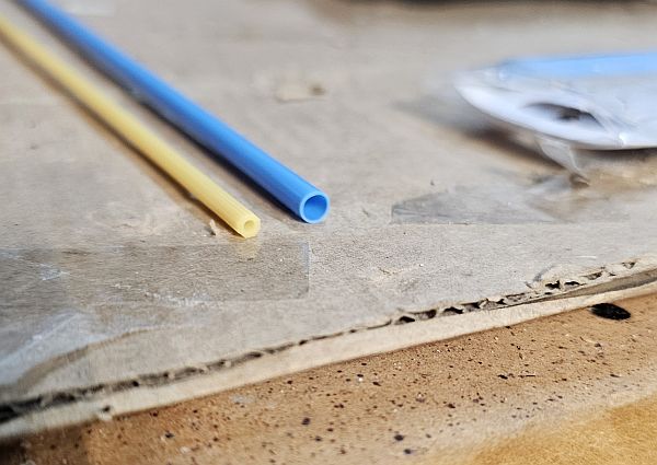

2 Long hollow tubes, one slides within the other:

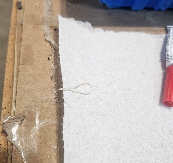

Took some kitchen twine (I figured it’s sturdy, temperature resistant, resistant to oils). Made a noose. Solidified the neck with gel Krazy glue.
Added a small column of gel Krazy glue into the end of the yellow rod, and rammed the twine noose into it, and then packed some more Krazy glue in to make sure it was good and stuck.
i got the same set yesterday , but not on sale , they were 19.99 plus tax
Reactions: Bandito
