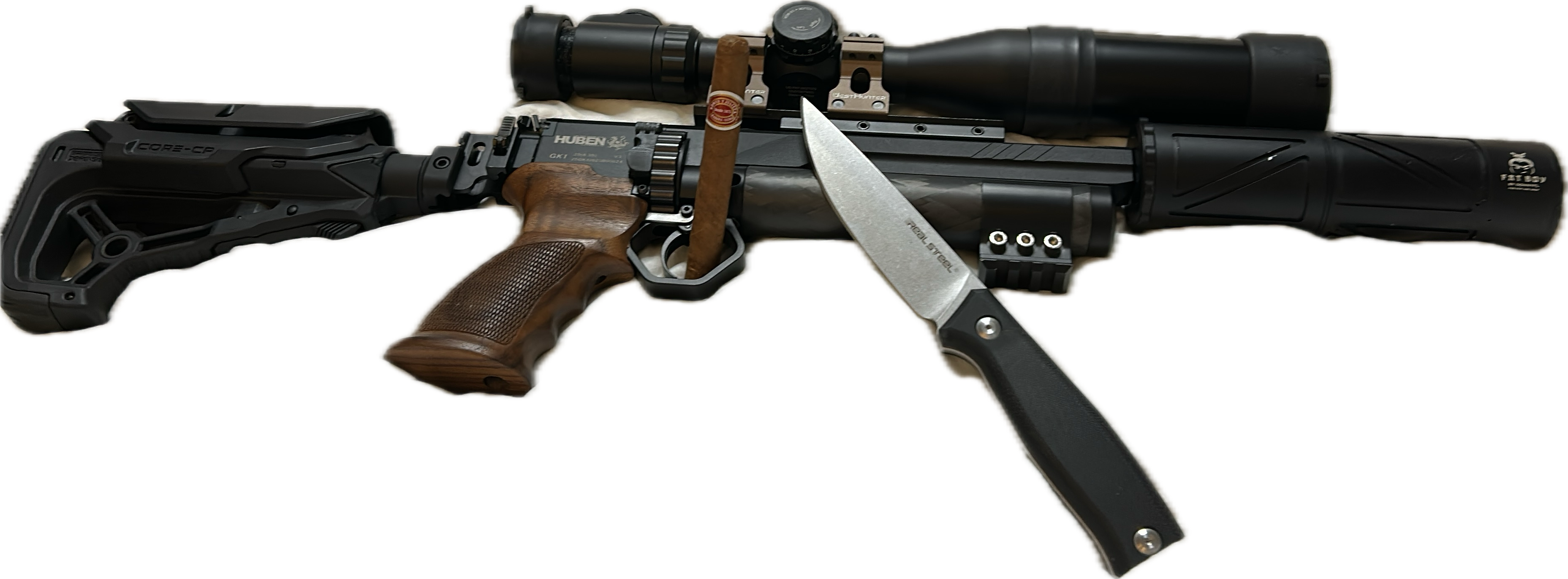

My GK1View attachment 522713
Brother, this setup is top notch👌💪💯
Im ordering the same stock fab defense...
But don't know which buffer tube to put in for picattiny rail... Can you help with this?
Is yours foldable?
Cheers
