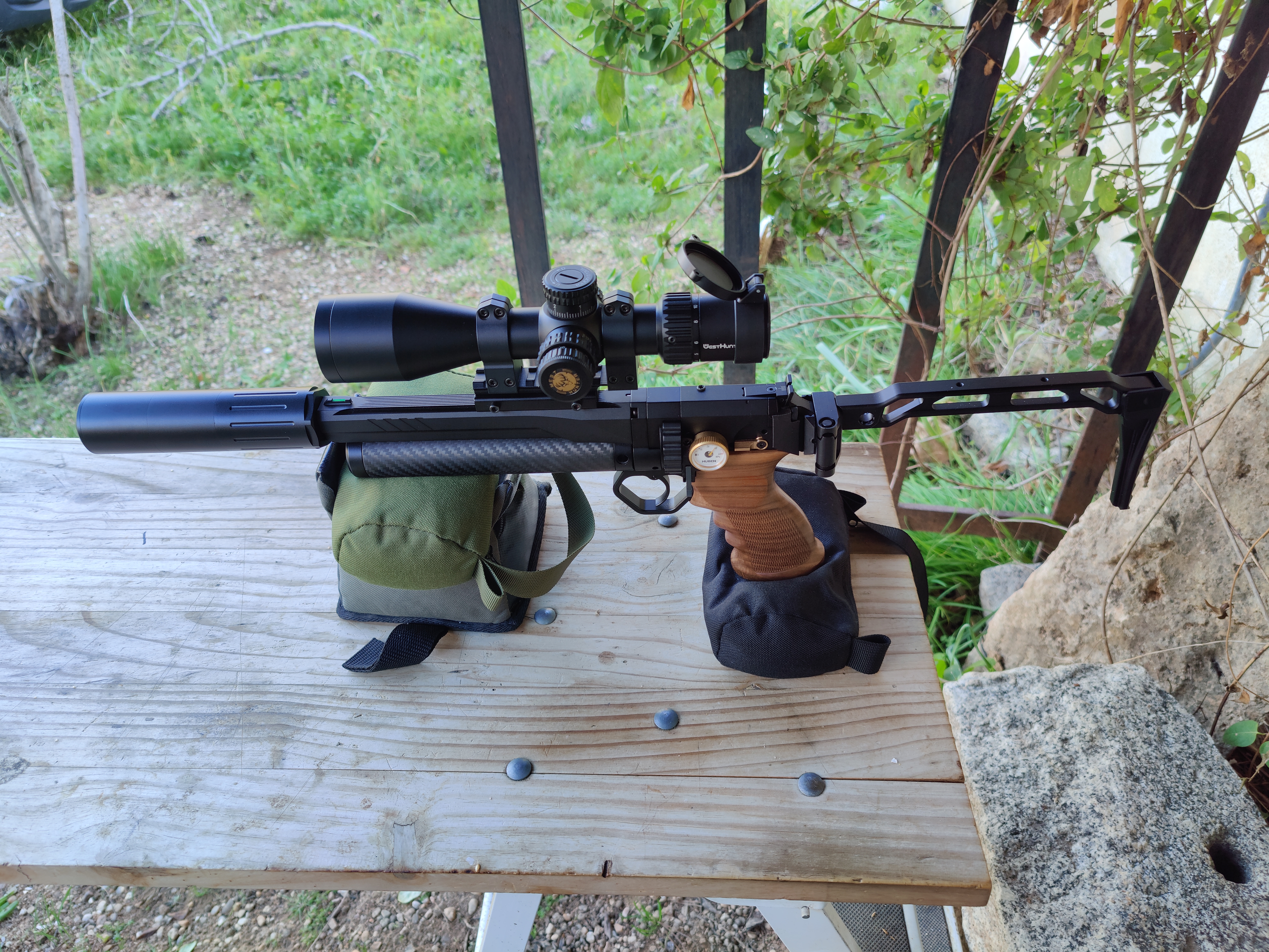

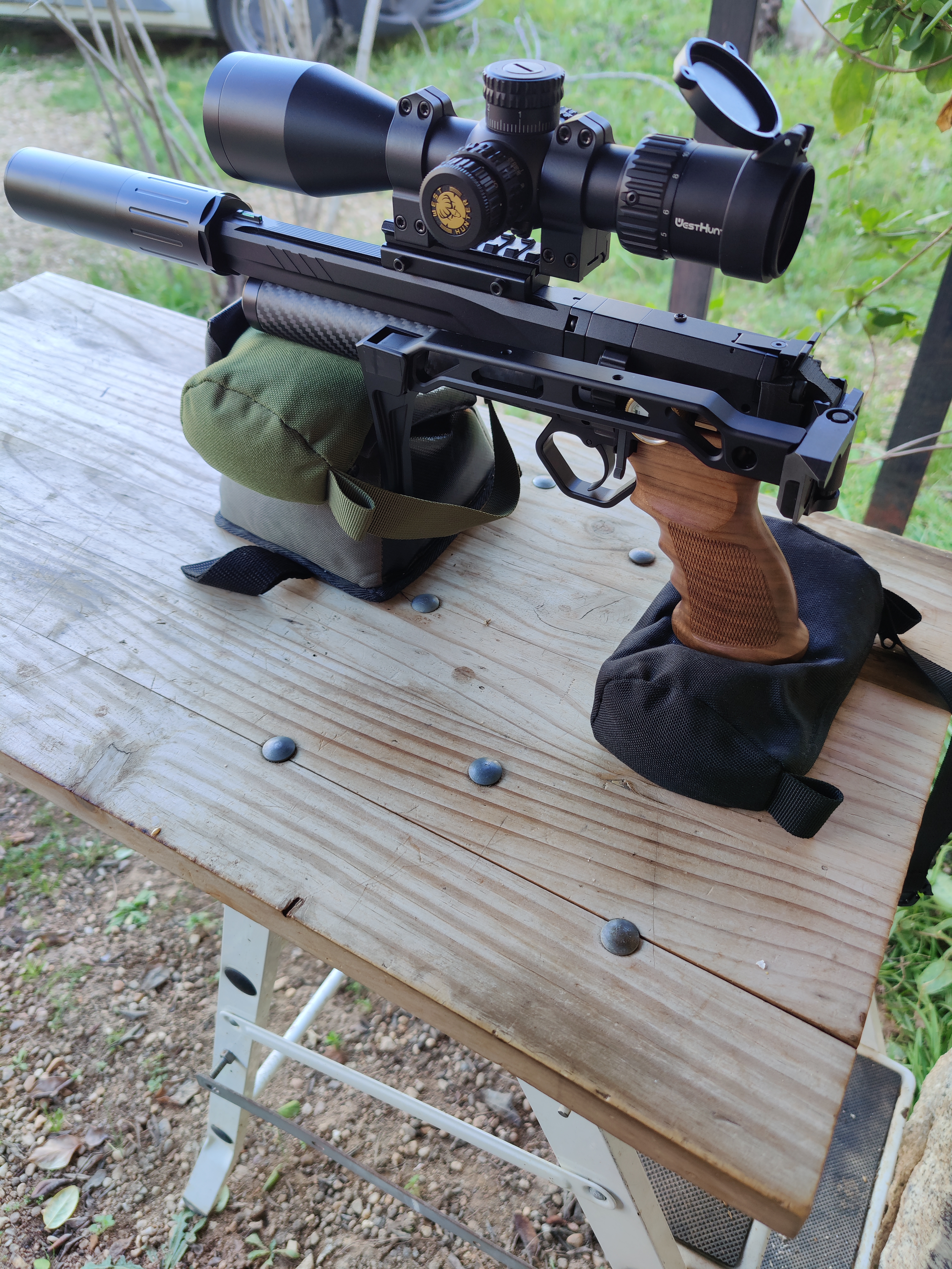

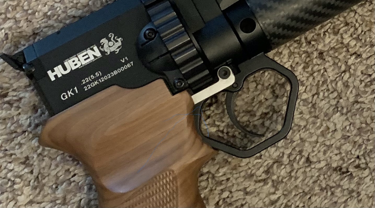

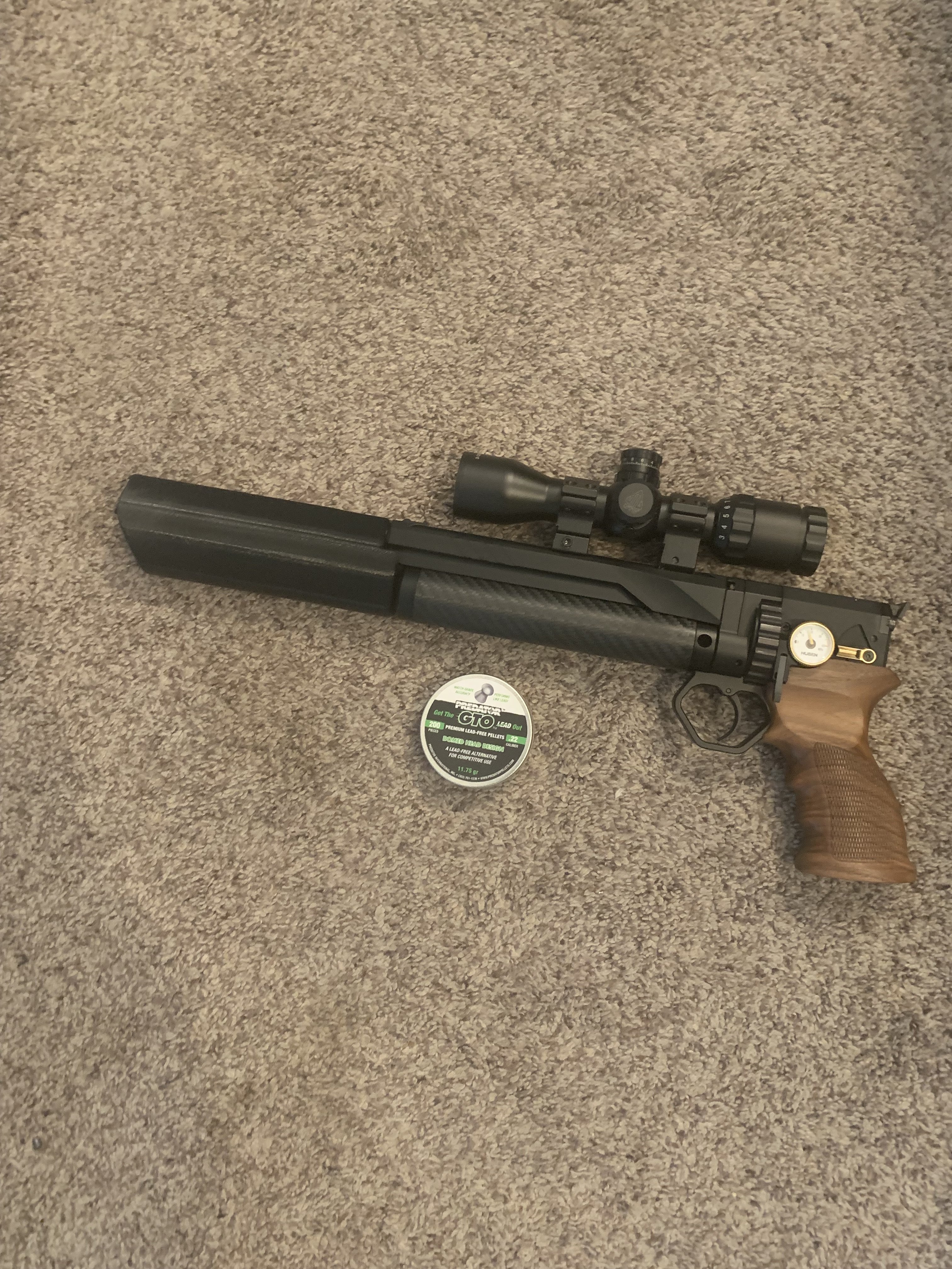

My GK1 (v1#67) just finished its 66th 150ct tin of .22 GTOs. That’s 9900 of em, costing in total more than I paid for the GK1. Since I’ve also shot at least 100 other projectiles (being conservative here), I’m calling this it’s 10000-shot celebration.
In that time, it has actually just got better, or perhaps that’s me getting better at shooting it, or both. It consistently shoots 1/2” (or less) groups at 50 yards with GTOs at 900fps and has never failed to shoot, jammed, or had any other issue. All original parts including the gate, which works very well with no seating needed for GTOs - just clicking 2 in at a time. It just gets filled and shot and shot and shot and shot, 250bar to 190 and the mag and air (nitrogen in my case) are reloaded. The barrel gets cleaned every 3 tins from the front with a rod and retractable patches - 5min job. I use it mostly for fun (spinners and targets), pesting (99% rats) and it goes hiking and Xcountry skiing in my pack. It has sported red dots, prisms, a $3k thermal and currently is fitted with a bugbuster, which I use to shoot precisely from a rice bag with short eye relief at 10X or using a freehand taco hold at 3X, which allows quite a bit of eye relief. It spent most of its life with an Impulse Air 1200 mod, then I made the shroud active, and now it is wearing @subscriber ‘s oval mod, which makes it sound like tapping a nail.

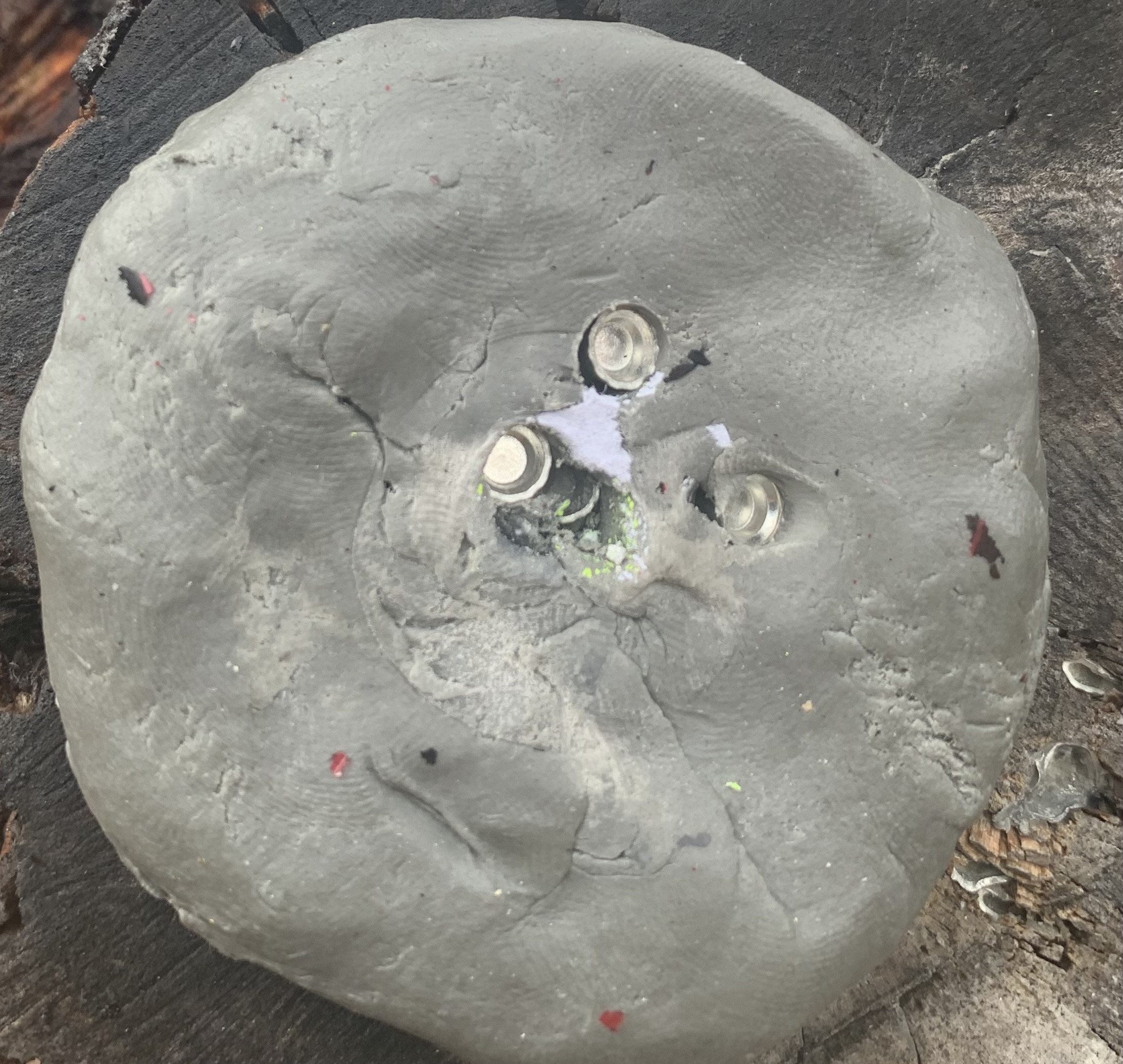

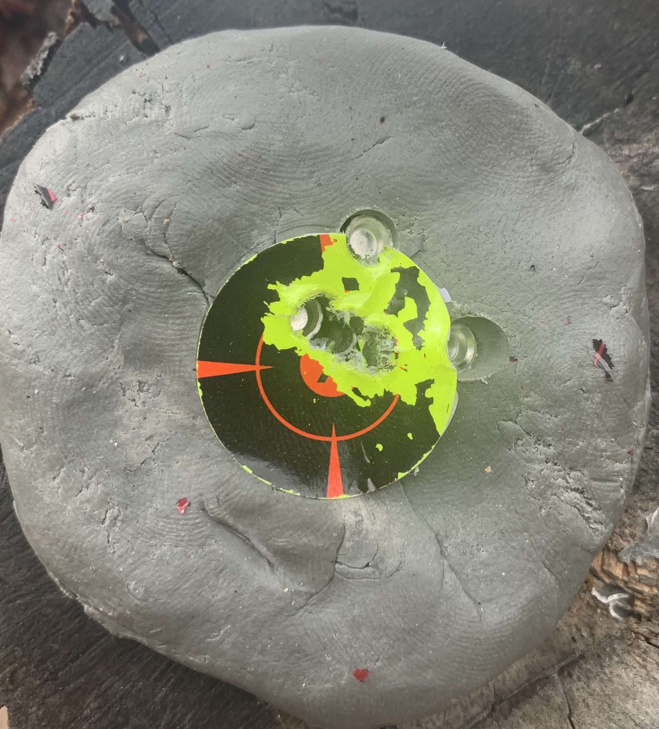

Here is my celebratory 50y, 5 shot group. I pushed out the boat and used a splatter target, which I then peeled off to show how good this thing really is. It does this all day every day, in semi auto, with a sublime trigger that tapped two into a raccoon dome 1/4 inch and 1/4 second apart.
Because there is no reg (to creep), the icing on the cake is that it will hit your point of aim every time you pick it up. It’s the perfect pesting instrument. Quiet, handy and absolutely clinical.
Ill end with a great quote from our friend Manny (@Nomadic Pirate 66) who posted this very early in the main Huben GK1 thread, before release:
“I've been searching for a PCP pistol that fits my needs for over a decade and a half now,...the Huben might well be nirvana.”
Manny seems to have a pretty good crystal ball, but did he envision that V1 issue #67 would make it to 10k shots without a single hiccup? I think that’s pretty remarkable for a semi…

View attachment 437473My GK1 (v1#67) just finished its 66th 150ct tin of .22 GTOs. That’s 9900 of em, costing in total more than I paid for the GK1. Since I’ve also shot at least 100 other projectiles (being conservative here), I’m calling this it’s 10000-shot celebration.

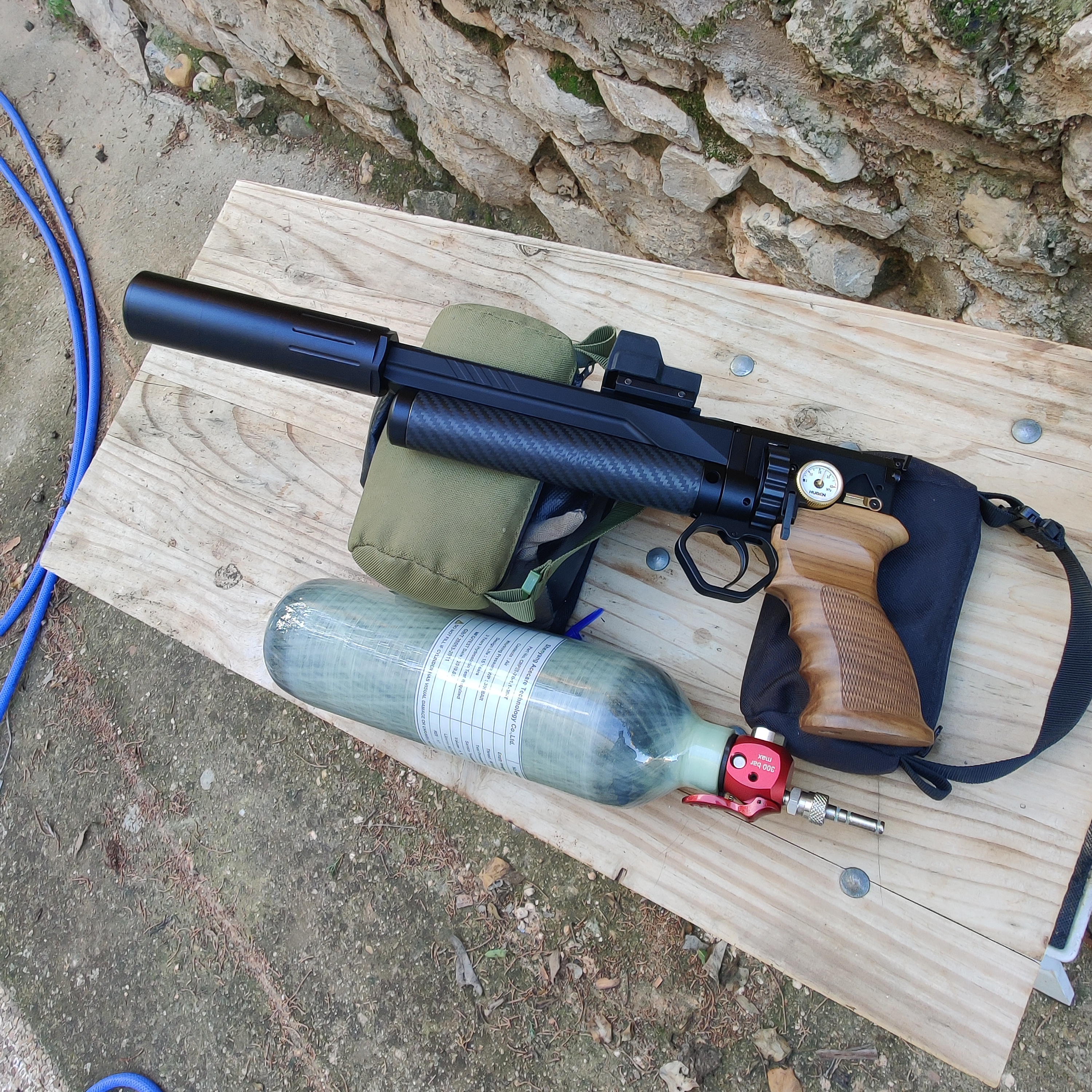

Amazing gun completely exceeded my dreams, ........what made me buy a Huben was the sheer amount of posts mentioning how rugged and reliable it is, and rugged and reliable is the only PCPs I wanna buy.

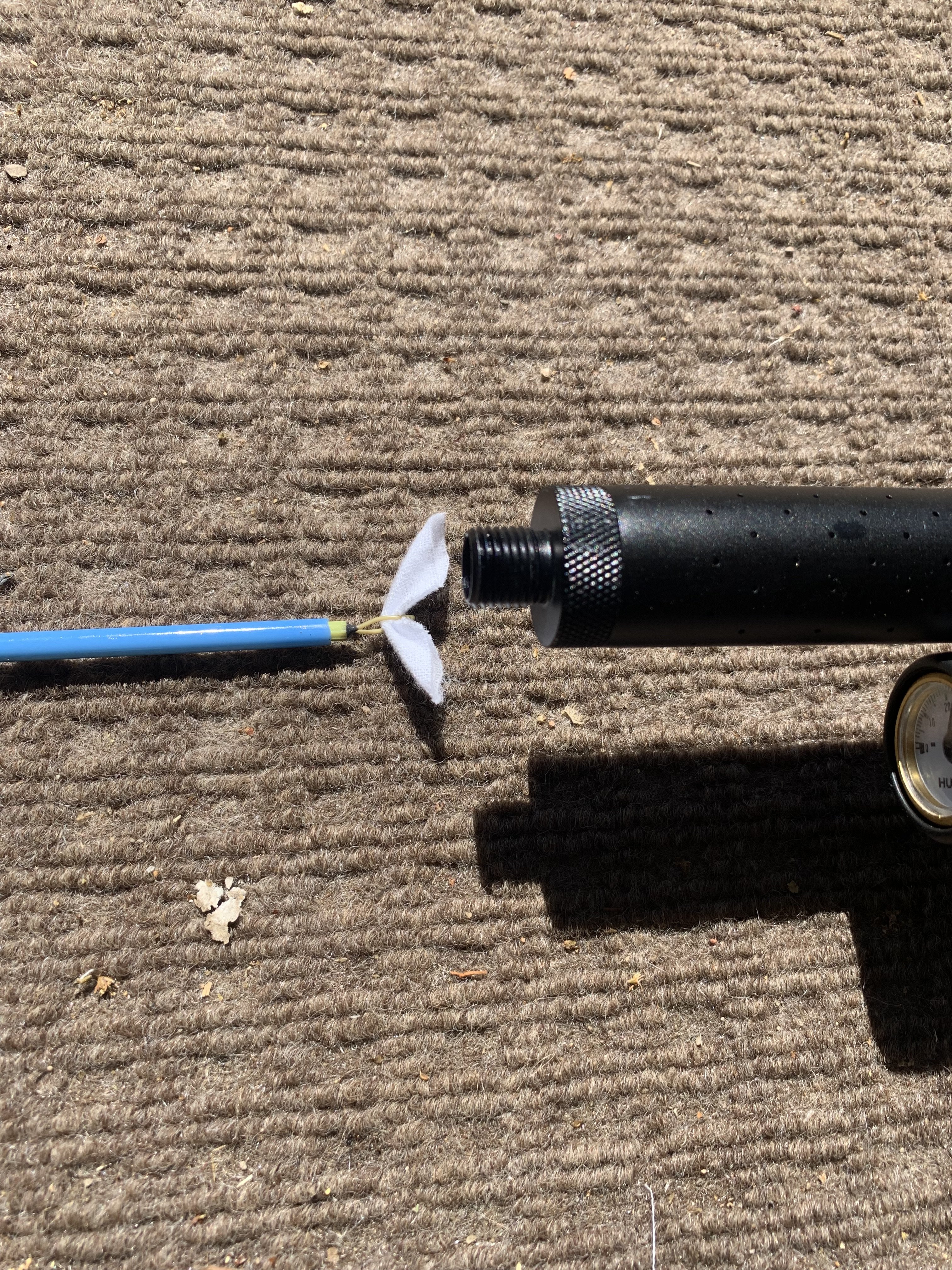

The diy barrel cleaner (shown with K1):

Regarding cleaning, it is very easy if you look up my method. I find that grease, which is present in copious amounts in the action (at least in mine) finds its way into the barrel, degrading accuracy. Maybe I just had a very grease-happy assembler but my back spring was literally encased in it.
