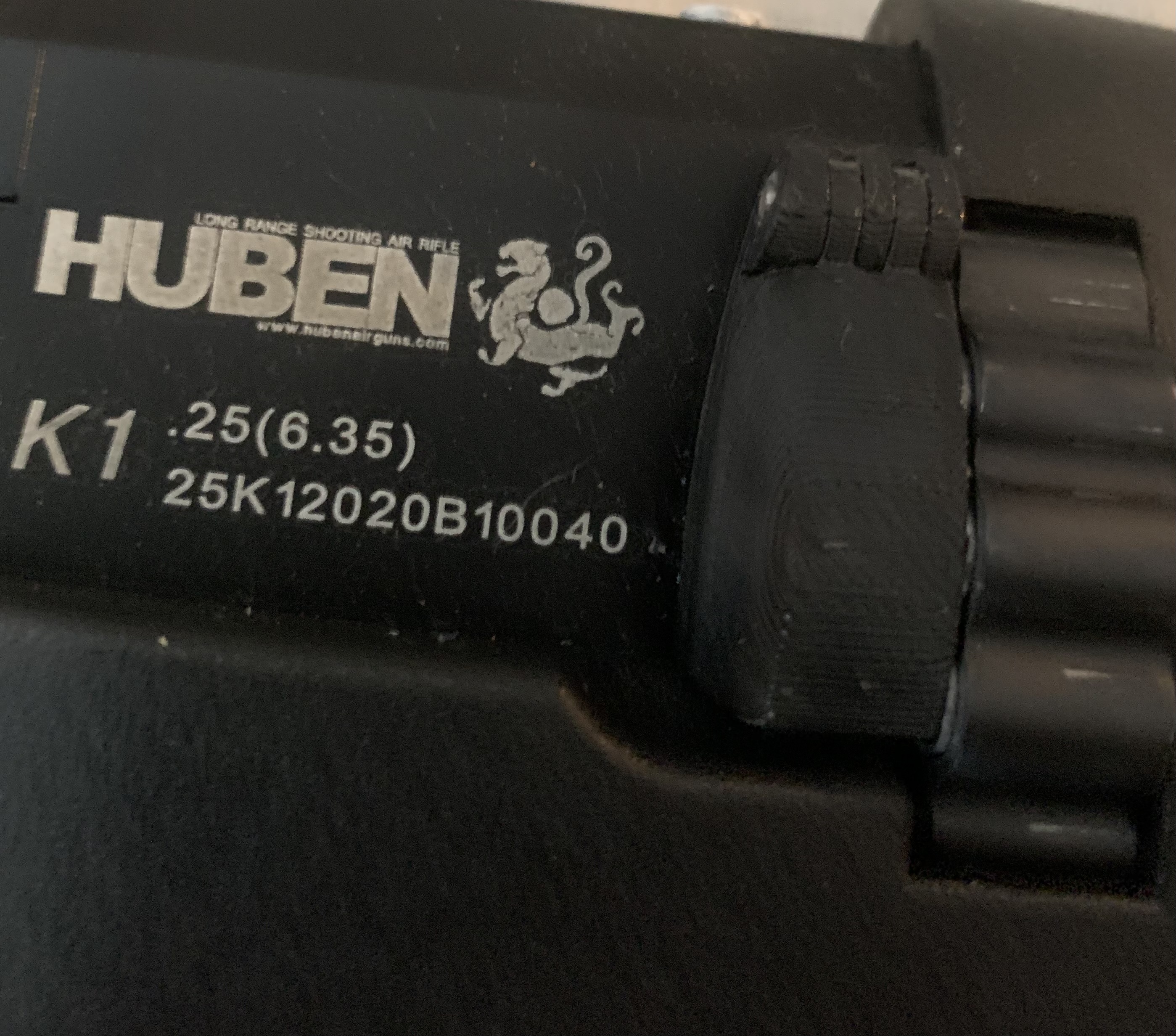

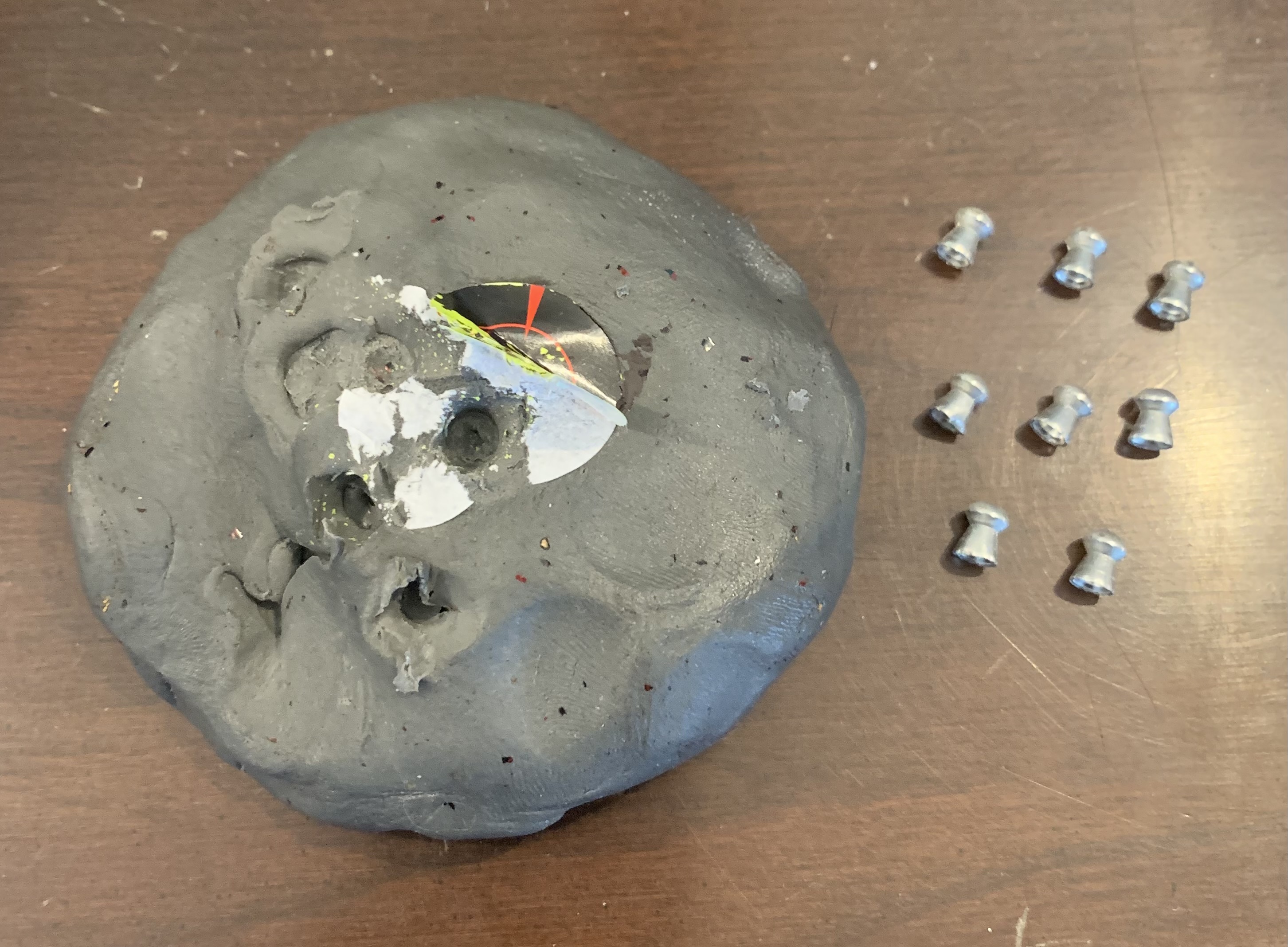

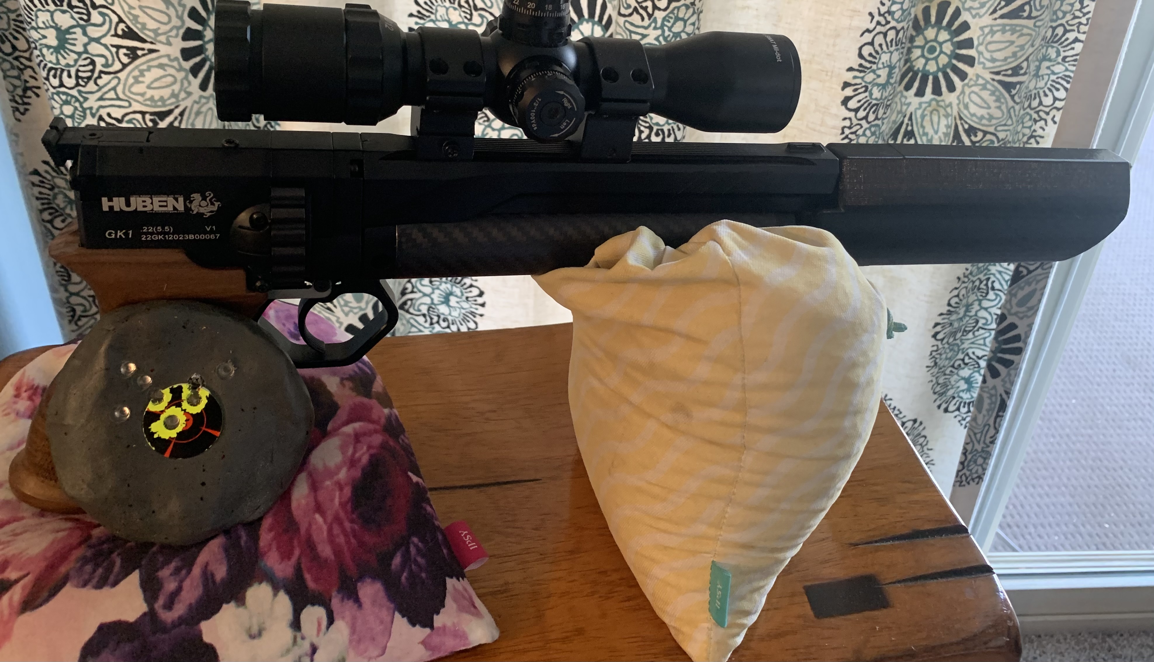

I put the factory gate on today and shot a bunch of JSB .25 & GTO 16 with no jams or binds. As Weevil has suggested, I pushed the pellet until gate clicked and did not seat them. I never shot for accuracy; I just shot for function. But at a 20-yard target, each mag full was inside a nickel. Eight hundred fifty fps with the GTO. So, it does look like my gate was the issue. I have a gate coming from Huben 3D parts. I will try that & see what it does.
Love me the OEM gate, not going into battle so if it take couple seconds longer to reload I'm all good ;)
The stock gate provides a rigid backstop for every chamber.
But it has two sharp corners (top corner of gate and corner of part below it) where skirts can get caught during rotation. The flip-up gates present one uninterupted continuous surface to the back of the cylinder. Also, they can be made to be the highest point on that side of the pistol, to prevent knocks and wear to the cylinder chambers outer walls.
