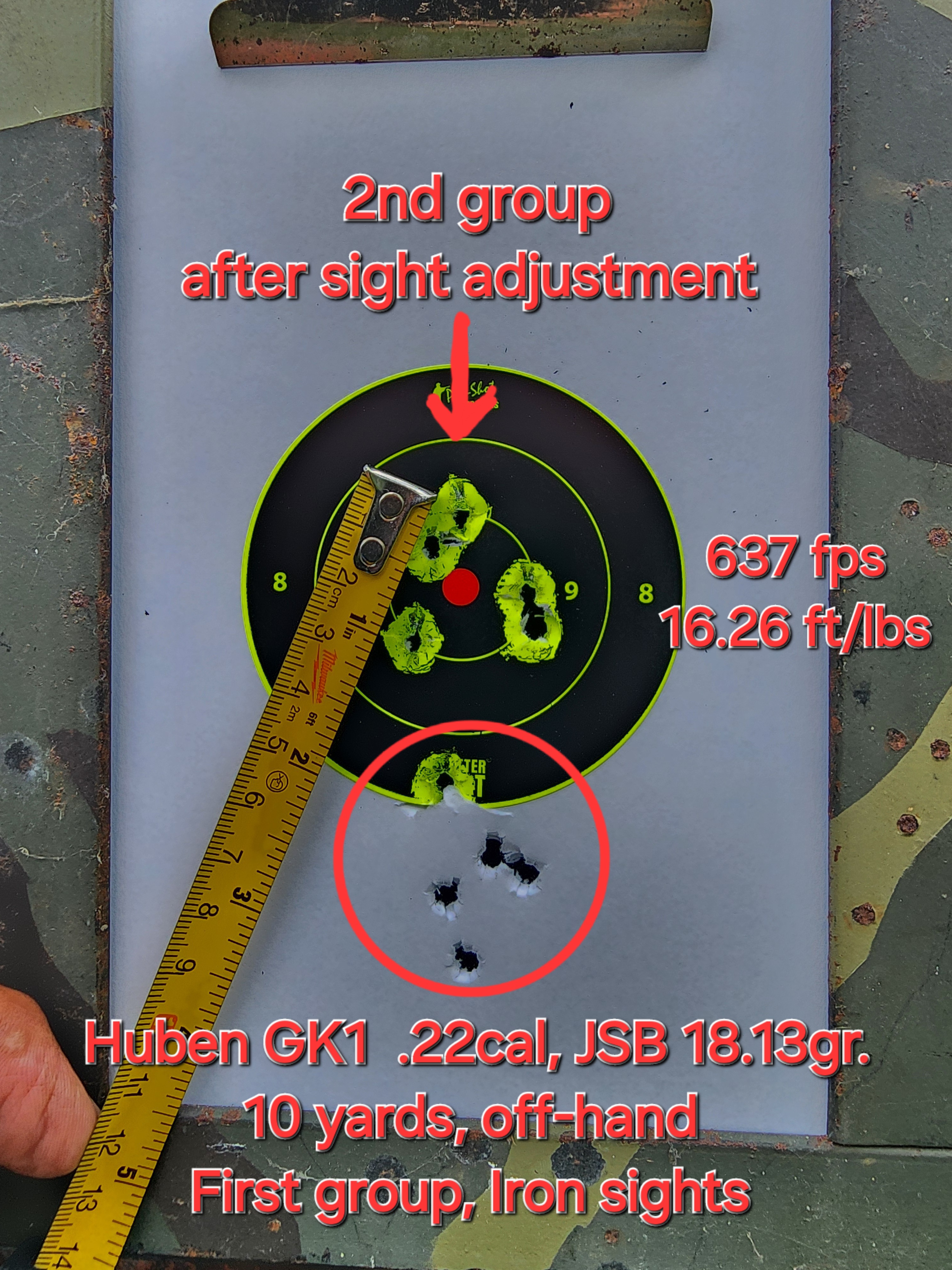

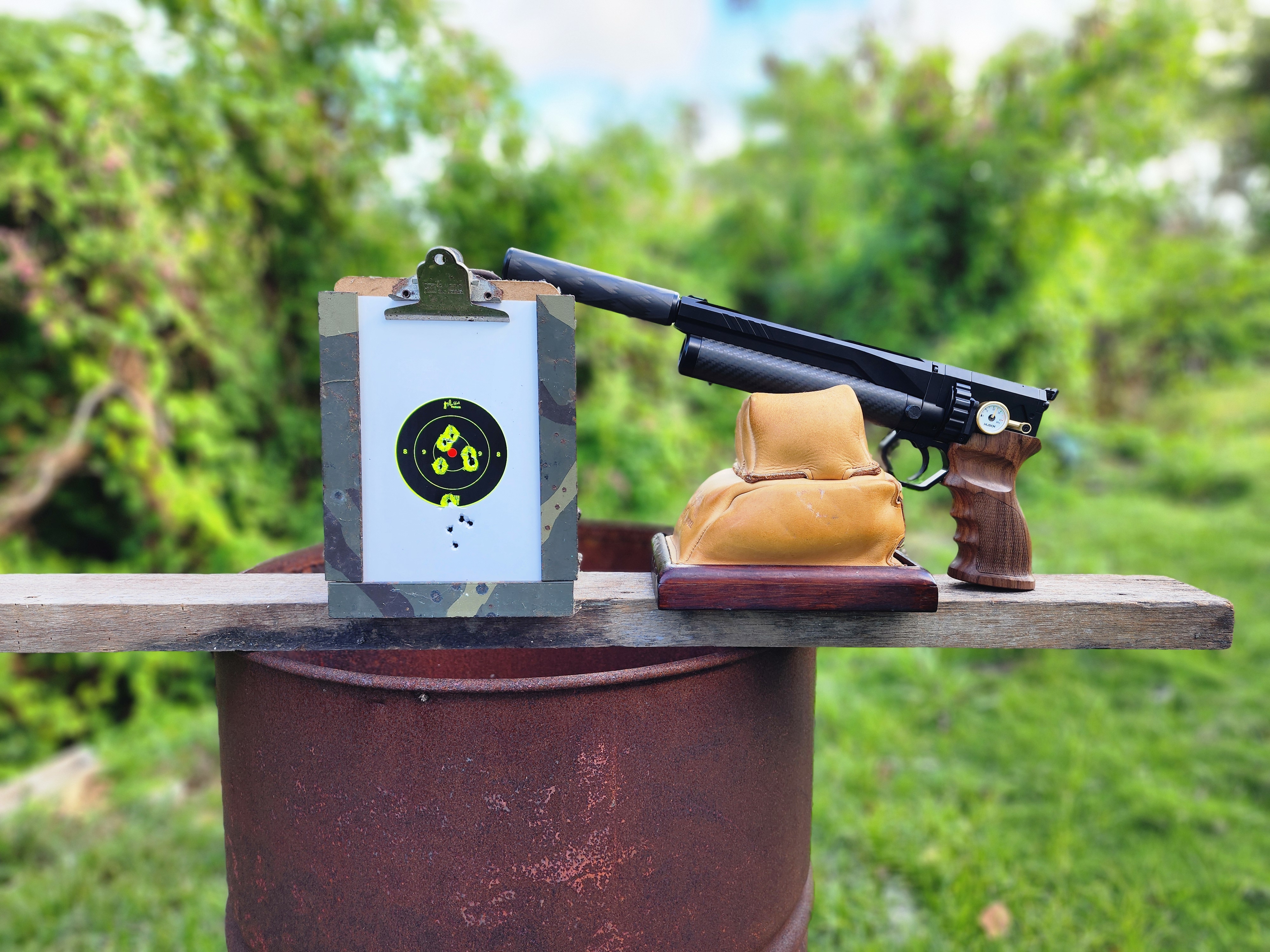

I only had time to run it through the chrony, adjust the sights, and do a few groups. I have it set up for JSB 18.13gr at 637fps average, 16.26fpe with 1 full turn CCW from zero on the power adjustment screw. I can get 2 magazines (38 total) from a 270 bar fill with ES of 27fps. I forgot what pressure it ended at. When I first shot it at zero turns out of the box with the Huben moderator, this thing is super quiet at 397fps/6fpe. I could only hear the mag rotating and I started to laugh in amazement.
Shot this off-hand at 10 yards unsupported. My eyes ain't what it used to be lol.

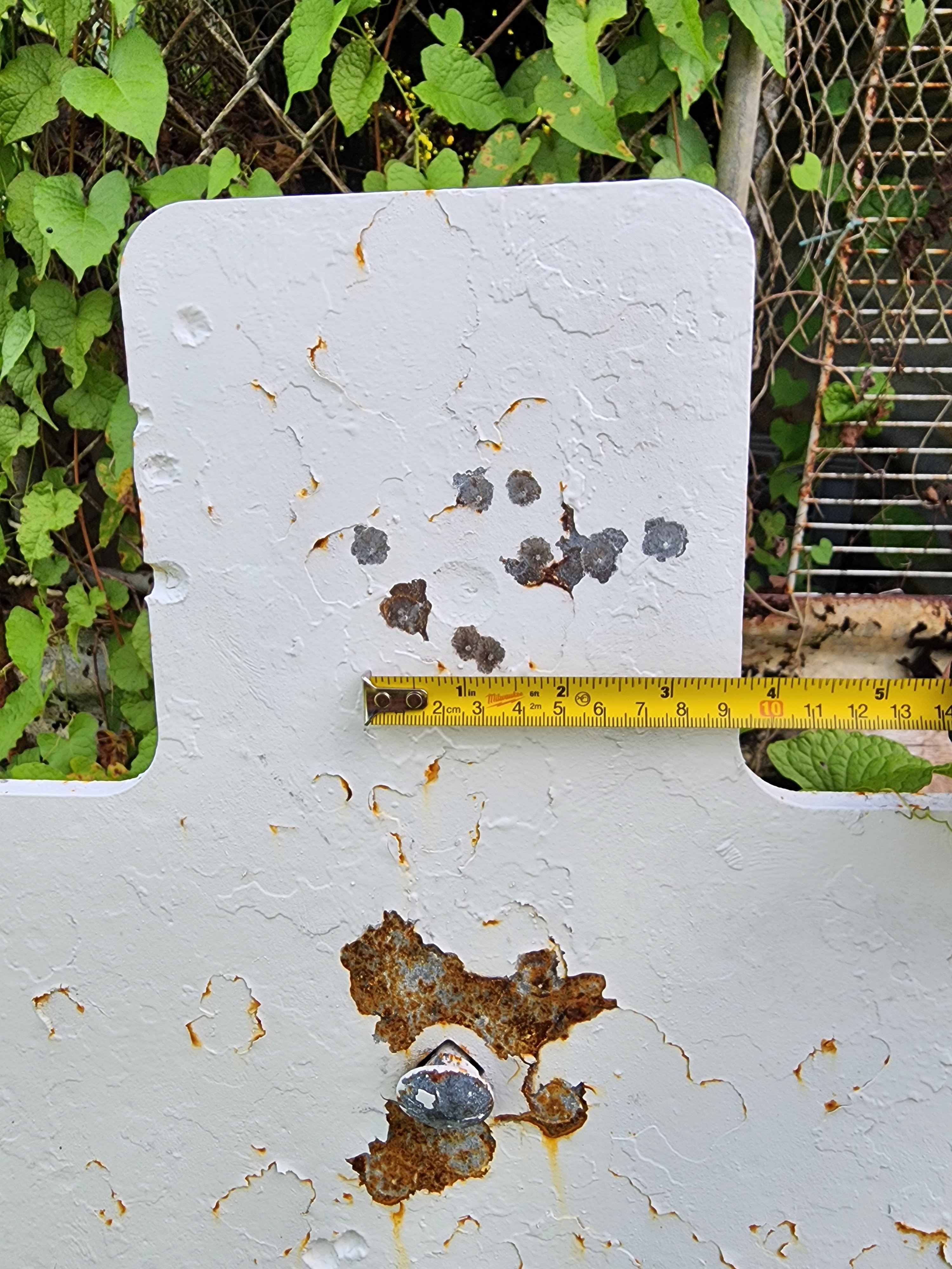

I then proceeded to empty the remaining 9 shots from the mag on to my steel plate at 22 yards off-hand, unsupported. I might have to adjust the rear sight to the left a little.

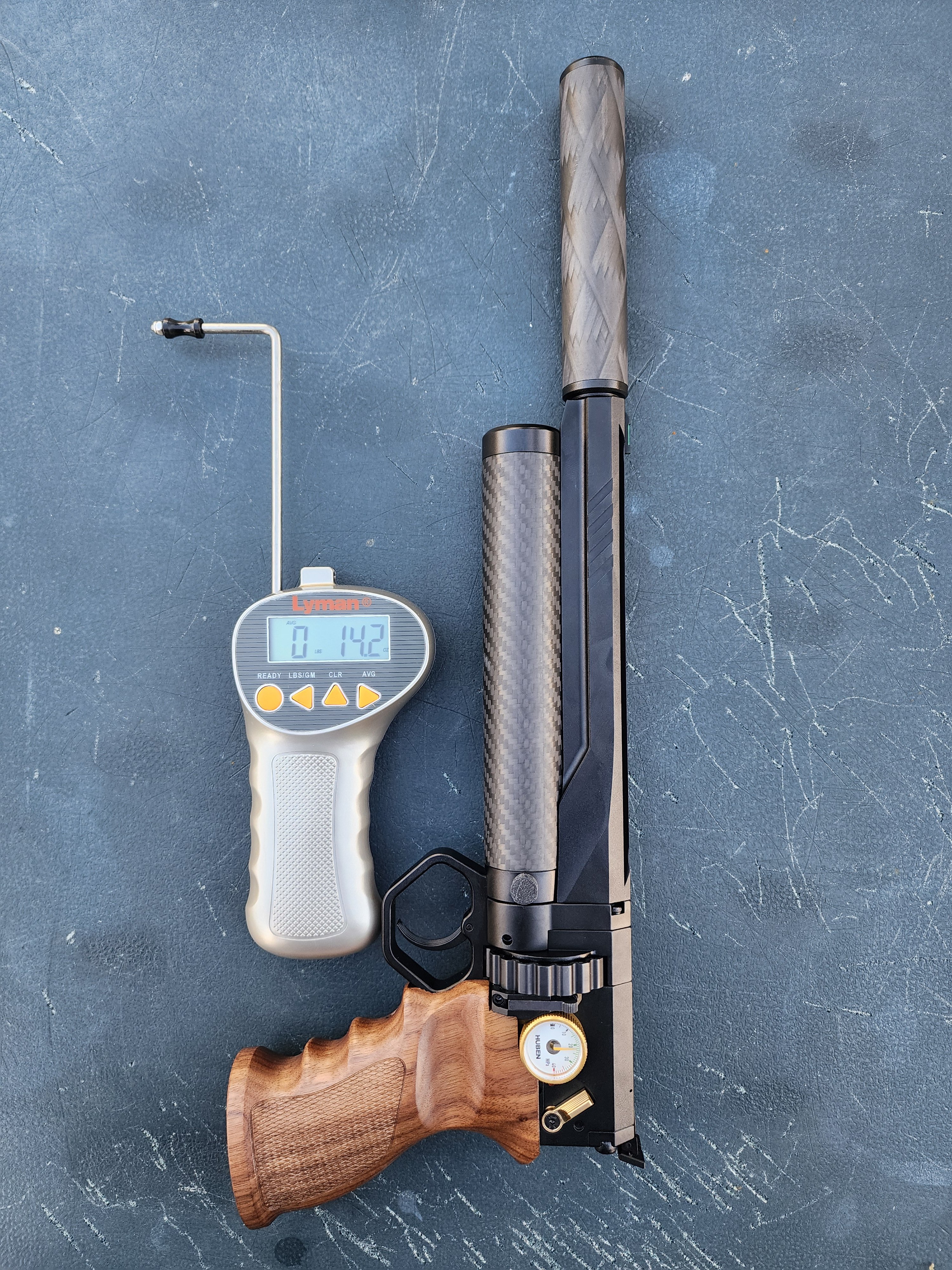

Trigger pull comes in at 14.2 ounces, average of 3 pulls. The funny thing is that when I first took the pull weight measurement, it doubled like I bump fired it lol. If you don't have a firm grip on this pistol and the trigger is set too light, it will double.

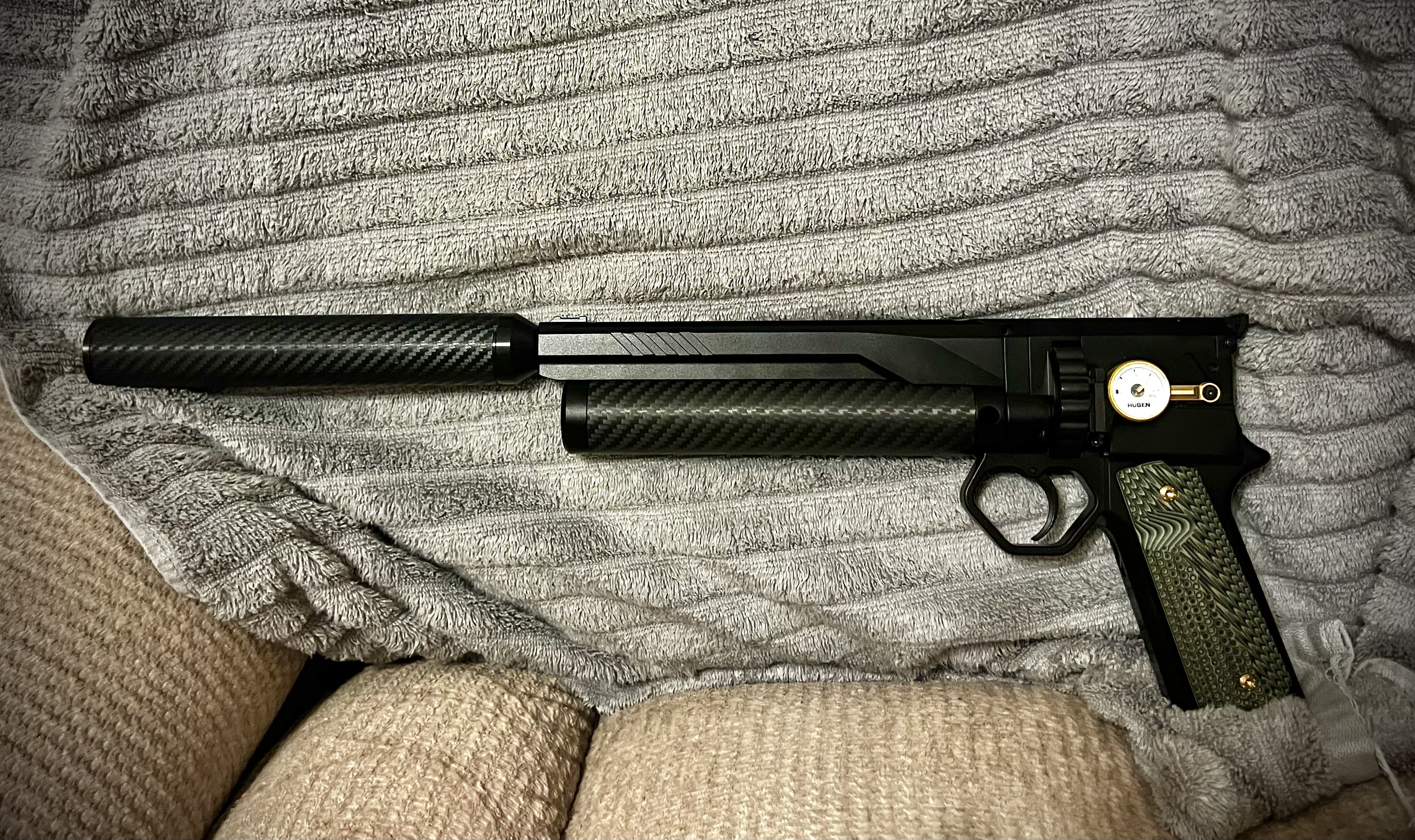

Cut up your credit card brother or you’re in for a rough ride. In a very short period of time, I have three different SBR configurations and my first one birthed another I’m waiting for… a Kelly special Shorty.
I have a hole in my wallet, and a smile in my heart.

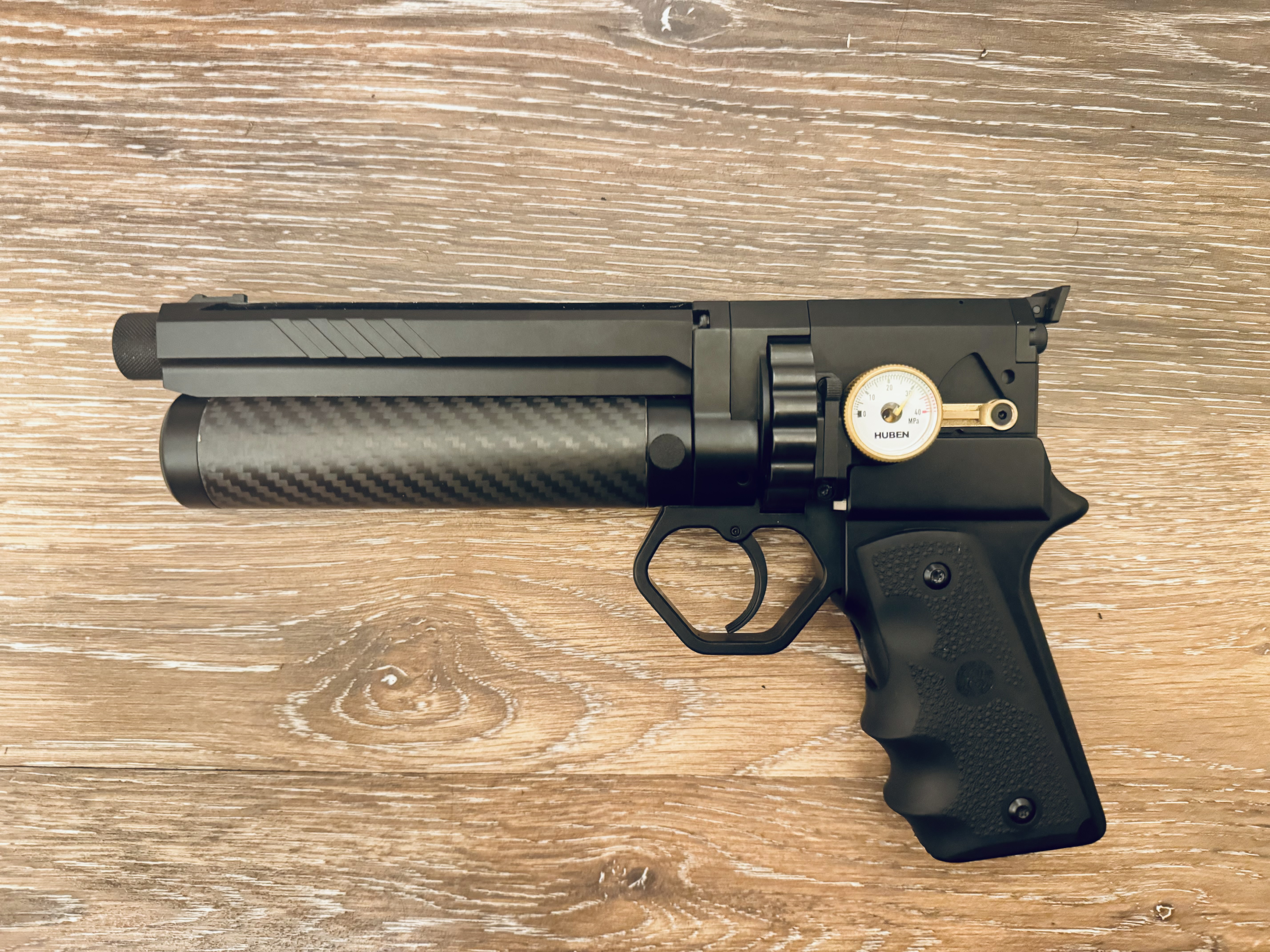

I bought my first used.
It was a rough start for me as the fifth shot degassed the rig. After asking some questions here, I had taken it apart and put it back together, filled and working. It takes the mystery out of the platform and made me confident it was a solid buy.
I geeked out on different setups - and different shooting scenarios and I’m super pleased by how customizable it is.

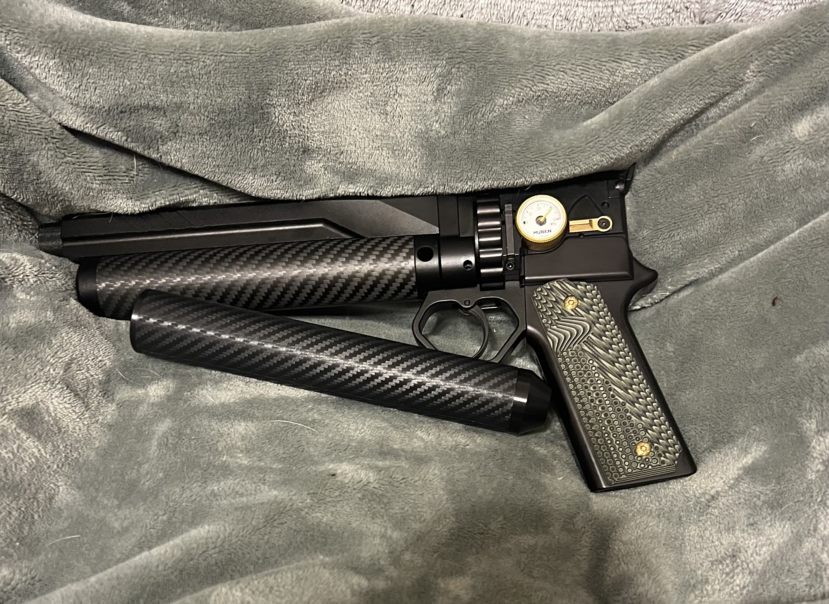

Can you tell me where to get grips like that?
Ethan, [email protected], makes a 1911 type frame, which will fit 1911 slabs. Excellent customer service ! Lots of grip choices available on line, Amazon, $20-$25 up. I have a dozen, I switch out weekly for a very cool look. I feel I shoot better cause the grip looks SO good. Never did like the standard GK 1 grip.
