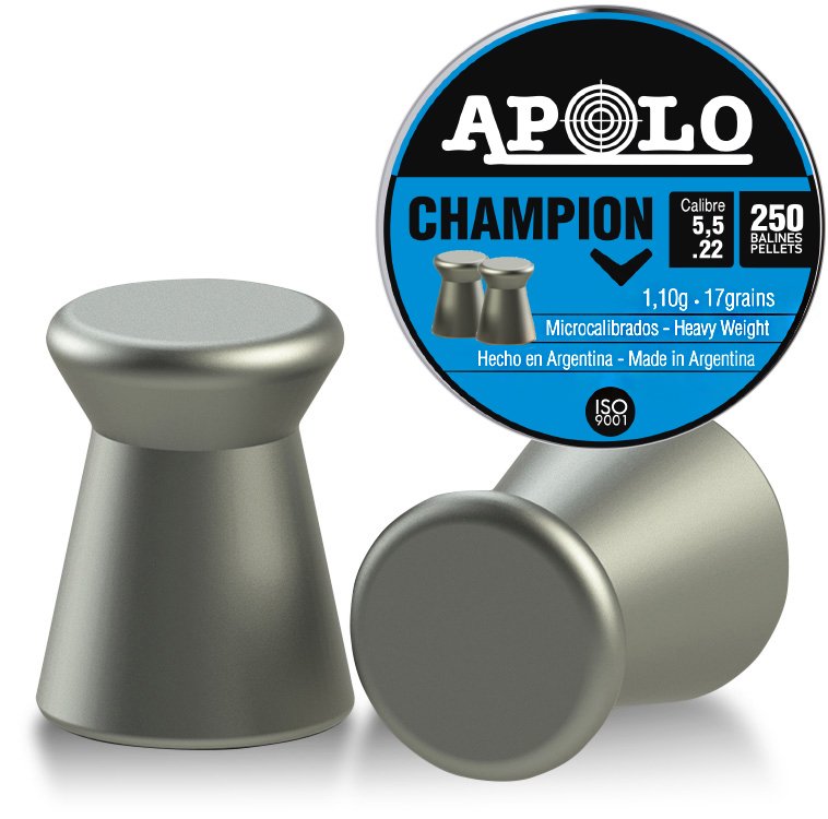

I have used those 17gr air boss in my Artemis PP700 and my Artemis PP750 with very good results. I’m a pistol enthusiast, had three AP-16’s which all eventually leaked air so I returned them. I have two Artemis PP700’s in .22 cal and a .22 cal Artemis PP750 that shoot superbly accurate out to 50-60 yards. I’ve also pre-ordered the GK1 in .25 cal because I want a .25 cal pistol.Thanks, Manny.
Yeah, for us close-range pesters there is really a market for wadcutters...:
(1) Heavy wadcutters that don't require detuning today's PCPs with their much higher ME.
(2) Larger caliber wadcutters to put even more smack on the pack.
For no. (1) for .22cal I found these 17 grain wadcutters from Air Boss, a sub-brand of Apolo. I still need to do some testing with them, but they seem better than the featherweights that all the other manufacturers are selling.
