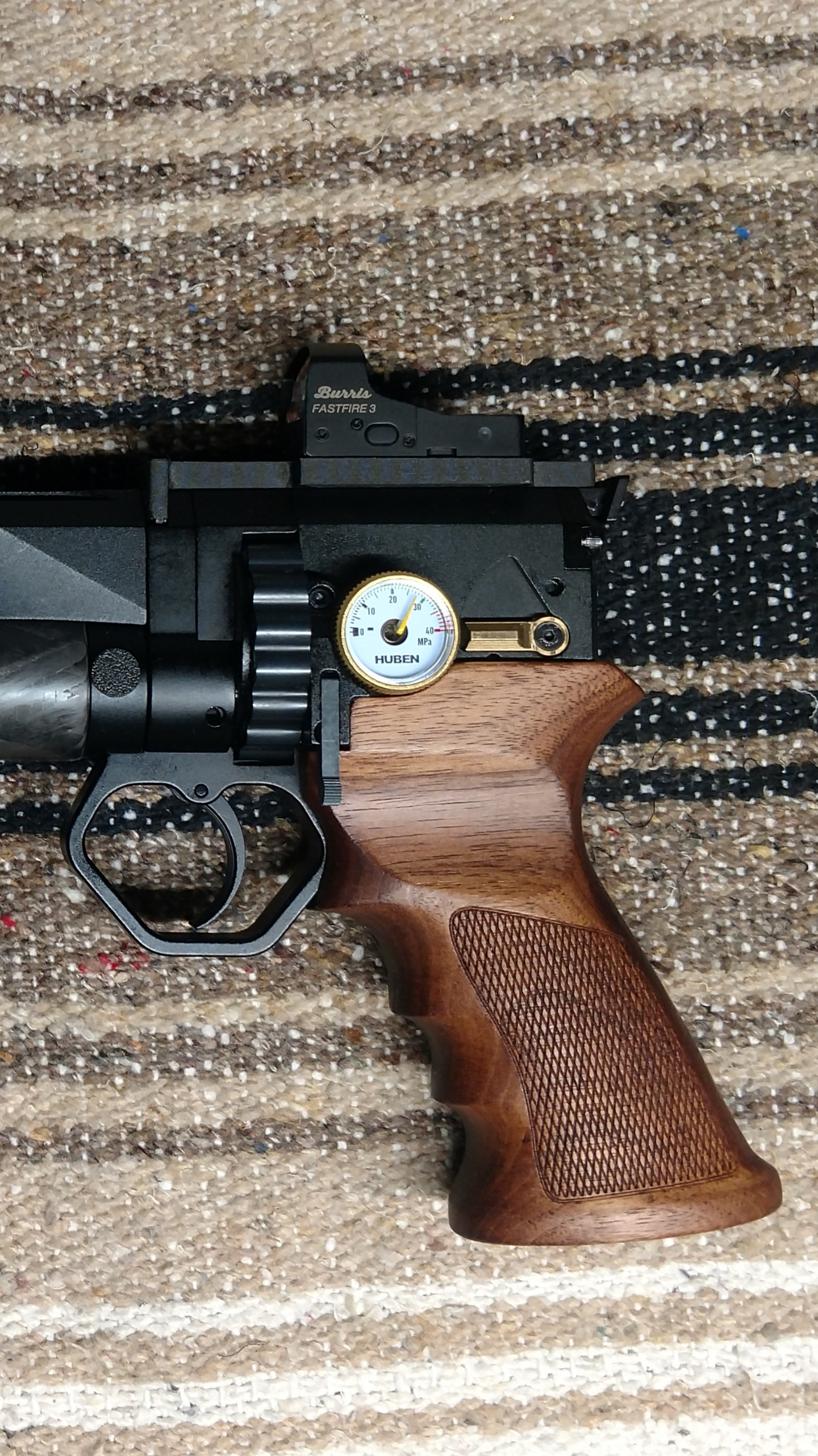

The grip was a little bit fat on the palm side, so I filed and sanded it parallel with the finger side. Then I stripped the finish and gave it a couple coats of oil based walnut stain to darken it up, and finished it up with some Howard Feed-n-Wax for now. It's much more comfortable like this.

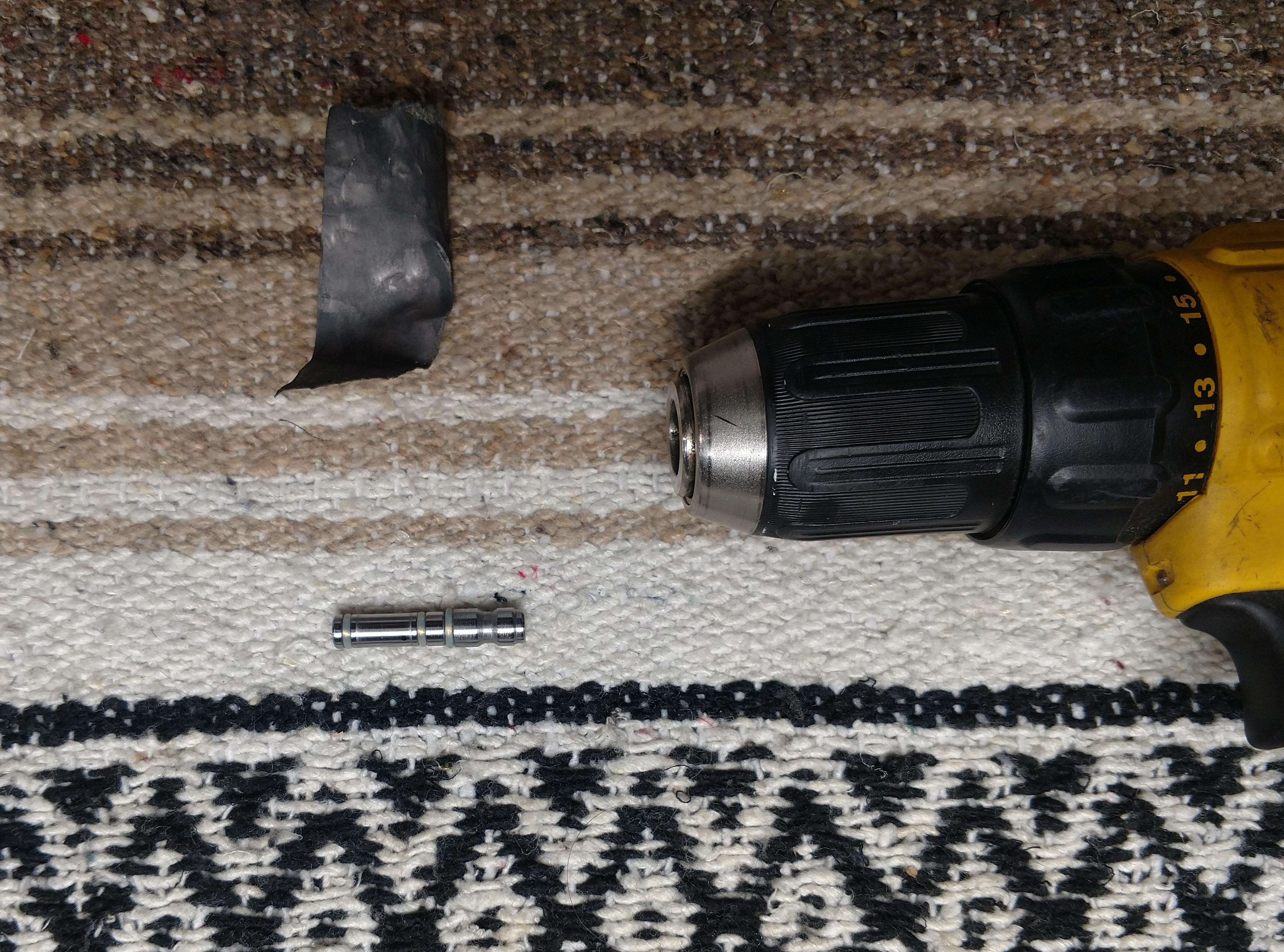

The fill probe was a bit rough and had some drag resistance into and out of the port if not exactly straight. Using 400 grit fine wet/dry sandpaper, a drill, masking tape (to wrap the end of the probe to be chucked up in the drill), polish up the rough fill probe until it shines. The chucked end was done too, but not as nicely polished where it didn't seal. Clean the port hole well so abrasive contaminants don't go into the air cylinder and reinstall the o-rings.
