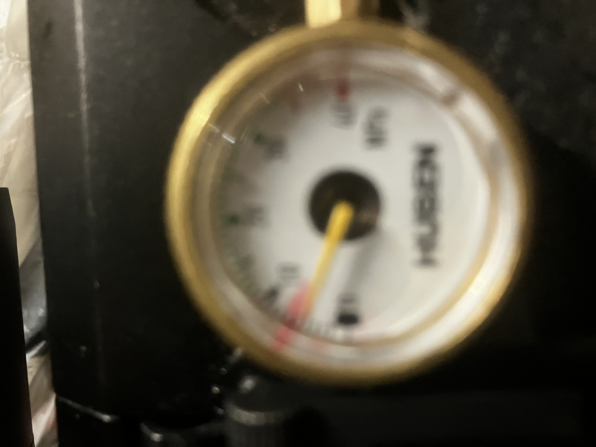

yesterday i let my best friend shoot my version 3 22 cal pistol/carbine, it was cold & misting rain so i stayed inside looking out of window while he stepped outside on porch,, he was shooting the caps off a water bottles at 35 yds & loving it, & then i heard a strange sound & he had shot it too low on air, , i had a hard time getting the fill probe out at first (i leave it in the the a/g .anyway to not lose it.)
. so when i filled the gk1 & shut off the fill tank & then bled the fill hose the a/g bled down also ,after a few times, i finally got the probe out with close to 3000 psi, so he started shooting again, 5 shots & a loud noise , the lever to release the mag for loading blew open & he felt air in his face, now the lever has maybe 1/2 of the original tension, & the mag stuck in place, anyone have any ideas how to get it working again? PS , sorry i know this post is rambling, i have a sinus migraine, roger
Reactions: miksatx
i do not know, could be , i will try to call Kelly@krazycool friday, thanks
pic of the air left in airtube after the incident
