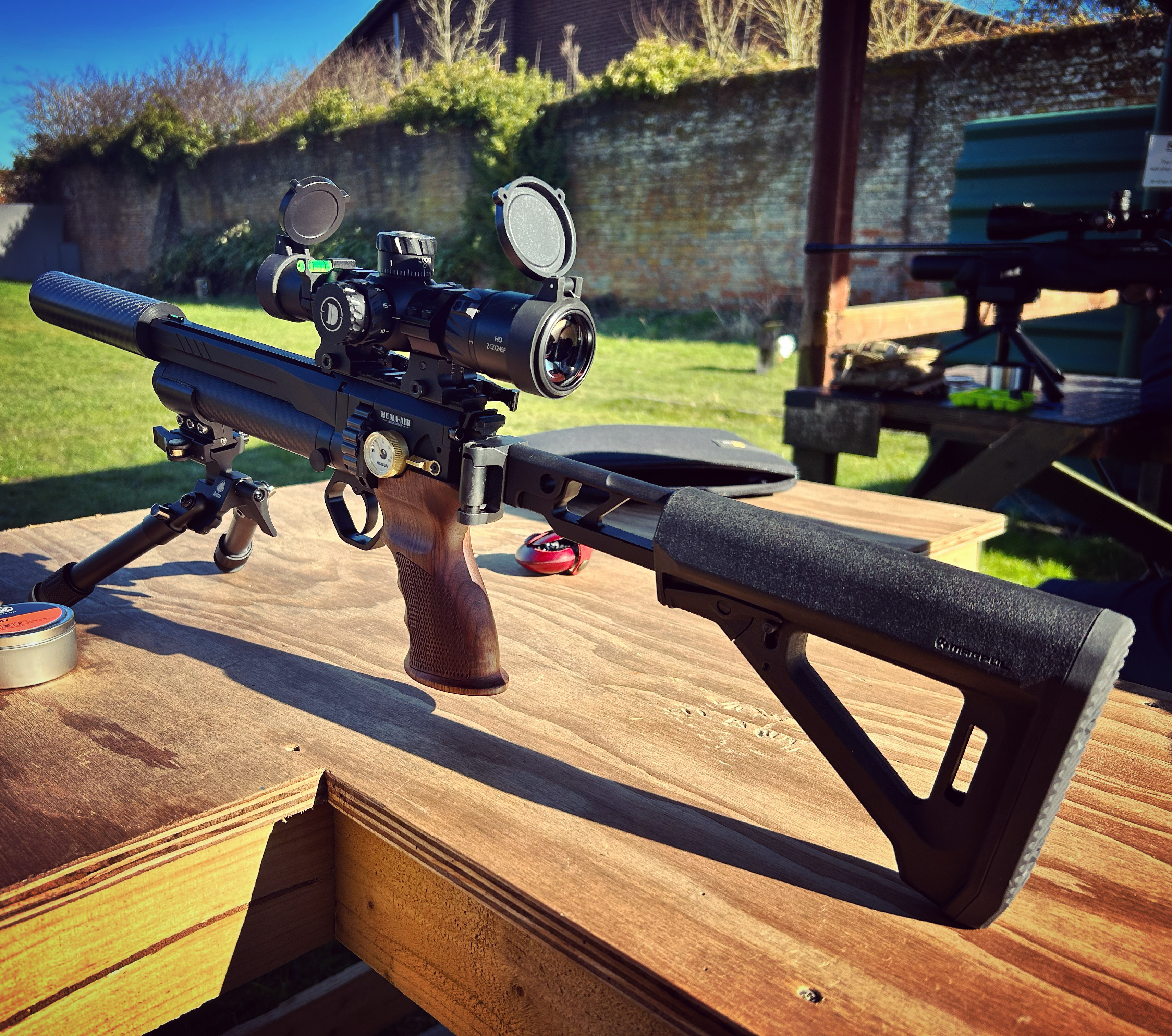

I installed regulators on my .177, and my .22 GK1s. Here are tips for those who are considering a regulator. I did not use a chrony.

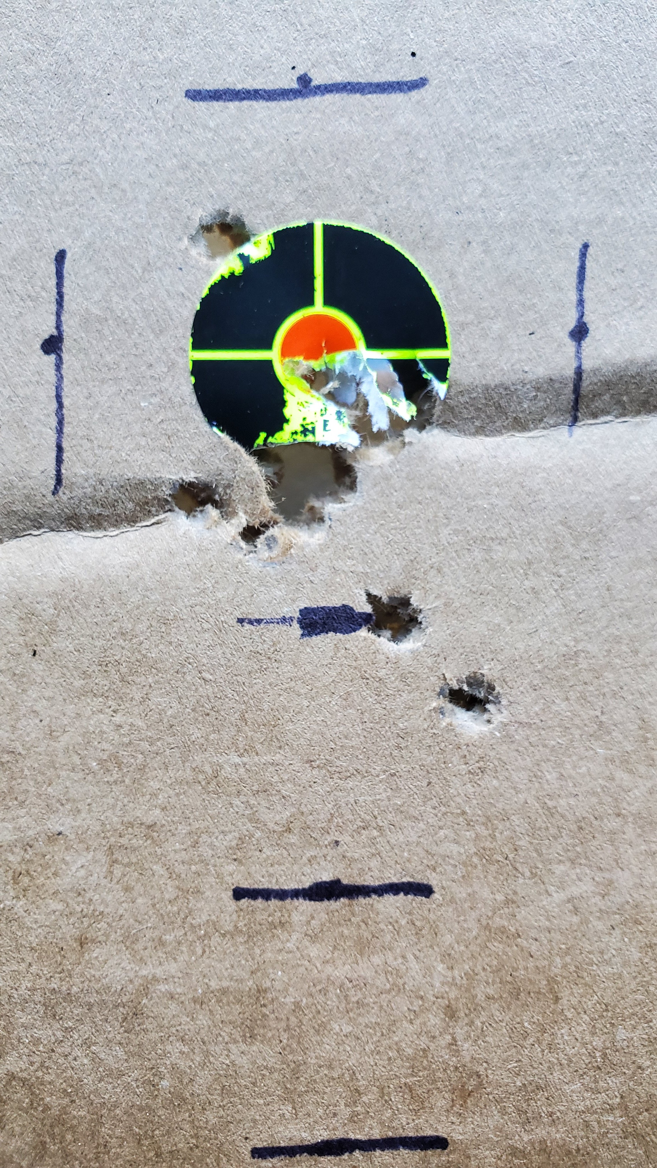

BEFORE installing a regulator, first find your best shooting projectile. Note your power adjustment, and the pressure range where you get your best consistent, tightest shot group - this may only be 5 to 8 shots or so. Groups will shift with the tube pressure. You may have 2 or 3 decent groupings; select the tightest one, or if they are similar, the one with the most shots within the group. Make your notes of the best groups, power setting, and pressure range, etc.
NOTE: selecting the top of the pressure range will yield the most power at a cost of shots per fill. Likewise, selecting the bottom of the range will yield more accurate shots. If you choose to set your reg at the middle of your range, gauge errors will be less of a factor (gauge reading different than where you thought you set your reg).
