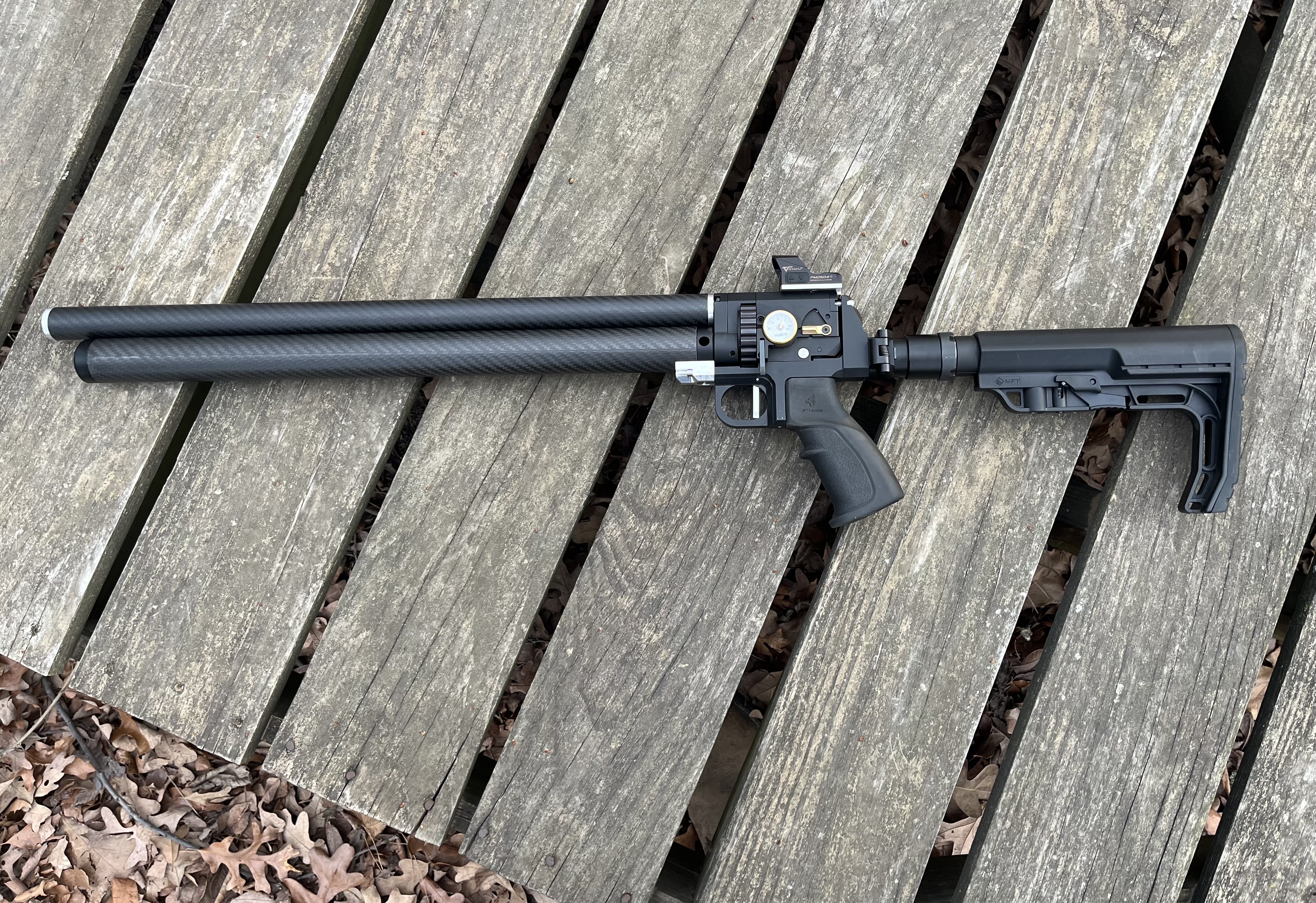

Mine still needs to be shortened. I’m using a k1 reservoir and just haven’t cut it down yet. It may very well end up in a wooden stock eventually.
DaveView attachment 495073

Several projects going on and this one has been a bit since getting it together. It is setup for slugs 34gr and up. I don’t remember maxing out but it had no issues getting into my preferred 850-950fps range. I have no idea on shot count because I’m seldom concerned with that and don’t remember testing that.
A side note though that for slugs, I use a knurled (sorta) slug that’s easy to load, stays put in mag, and is still snug in barrel once it makes the transition. Barrel alignment is a must with slugs. With this procedure, very good accuracy can be obtained. I shoot 50 yds and have been pleased.
Dave
Forgot to add, it’s a 22
