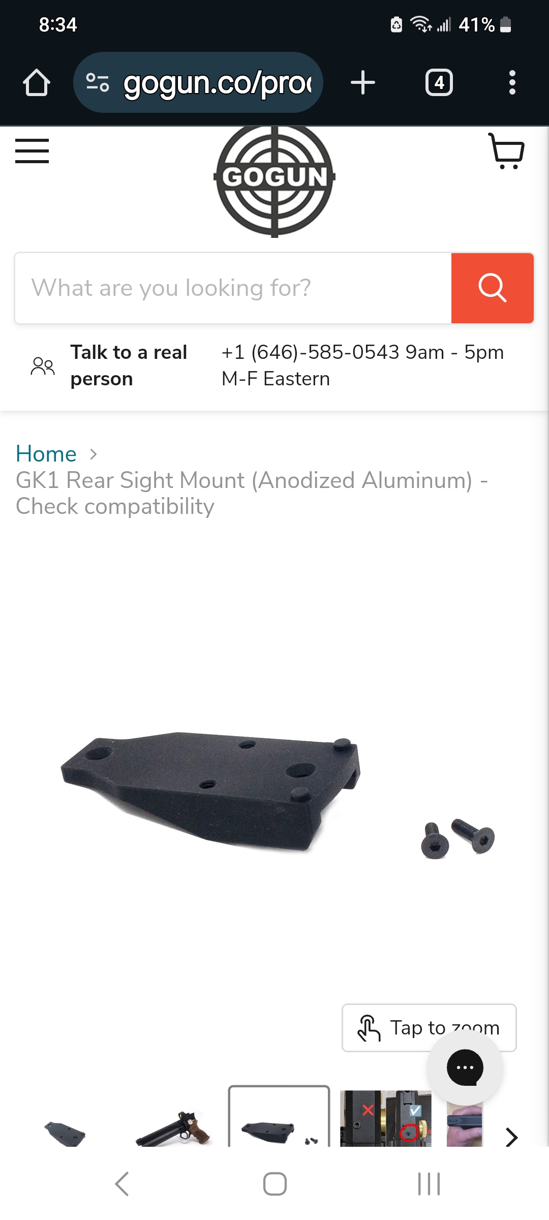

Who makes the aluminum red dot mount? Think I missed that. Is it an RMR style mount?
Go gun and yes it's RMR style fits very right to the gun
Low.profile I like it better than the 3d printed ones I bought.
Also allows the red dot to sit lower.

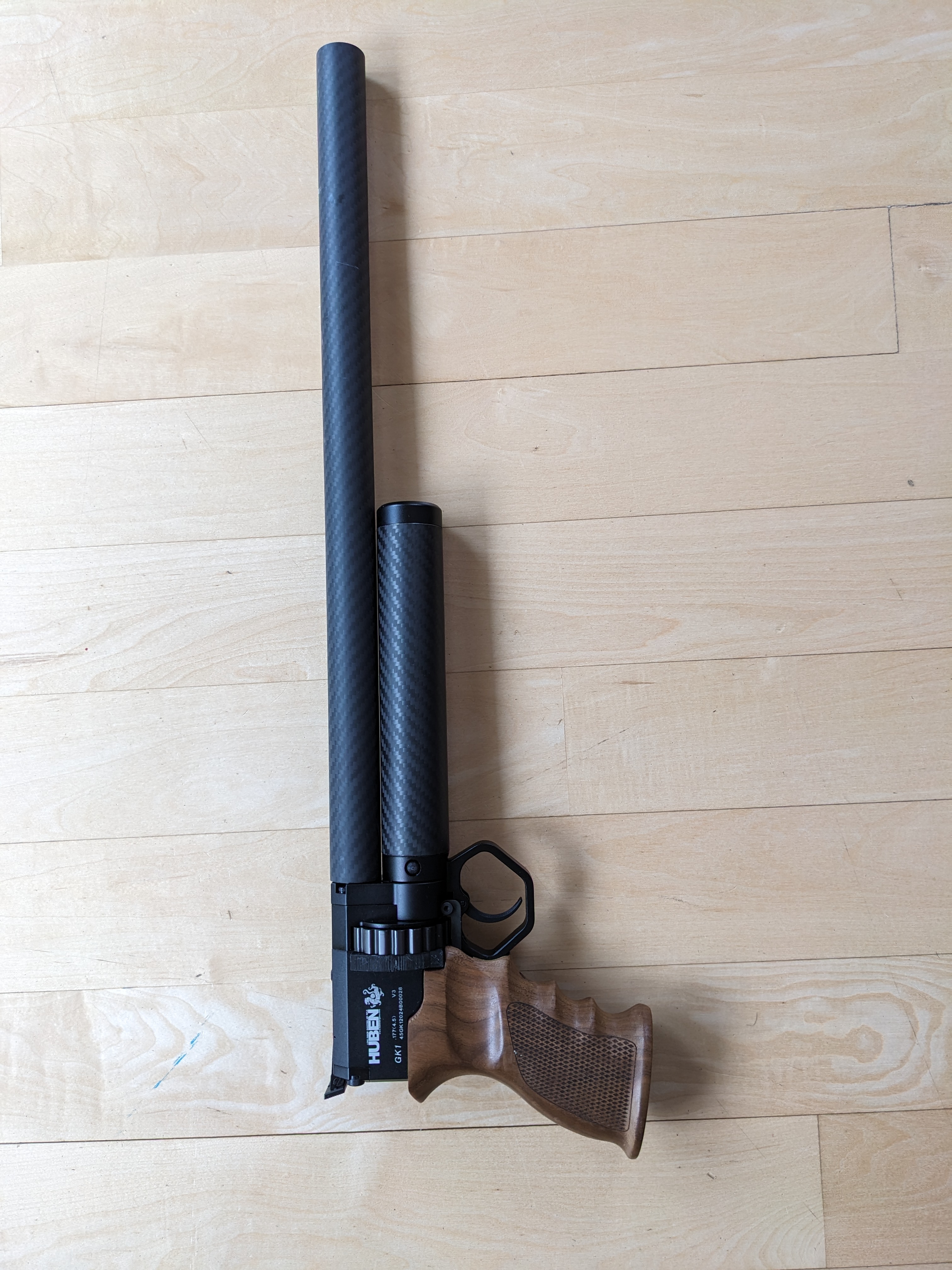

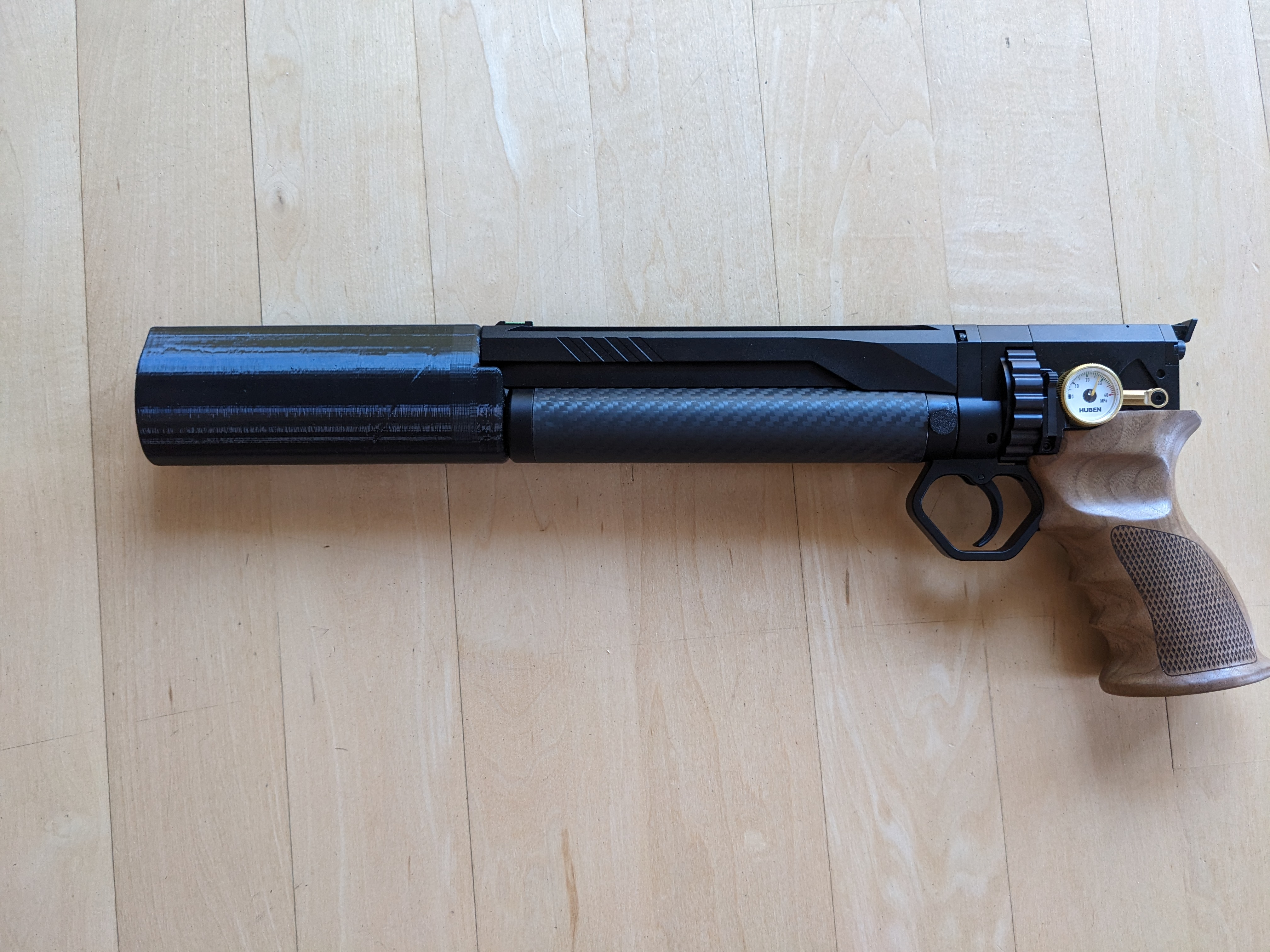

Because my GK1 soon won't have a rail on top of the shroud. I'm expecting it to be both lighter and quieter well not upsetting the balance.
Because my GK1 soon won't have a rail on top of the shroud. I'm expecting it to be both lighter and quieter well not upsetting the balance.View attachment 508175
Thats Awesome!!!!!! I get it now. Just get rid of that barrel shroud and put Krazcools falcon rail on it with a muzzle break. You'll have the best looking airgun.
No falcon rail, too heavy, non-function shroud volume, but it looks great. Function over form!
Rear receiver mounted red dot, CF shroud with integrated moderator. This isn't the final length, just a test fit. I'm not sure if the CF shroud is low enough to use the stock rear sight. Probably not, thus mandating the use a red dot.
the falcon is made out of aluminum and is half the size but cf is very light. Can you put a moderator on that shroud? I bet they weigh similar. Obviously your putting a rear stock on it so you'll have a nice carbine.
One concern is if the valve does an air dump is where are the piece going to fly? Best to wear eye protection and not have anyone standing to the sides or of course anywhere downrange.

No I was just asking if anyone used it. I think I will buy it as the open sights probably won't work. A 25 OD 1mm wall thickness CF is really light the aluminum shroud is many times heavier and won't help with sound reduction, because it's internal volume isn't utilized.

The GK1 already has a lot of forward weight due to barrel length and especially once you have a mod on it. I understand your point I just don’t need any additional weight there
