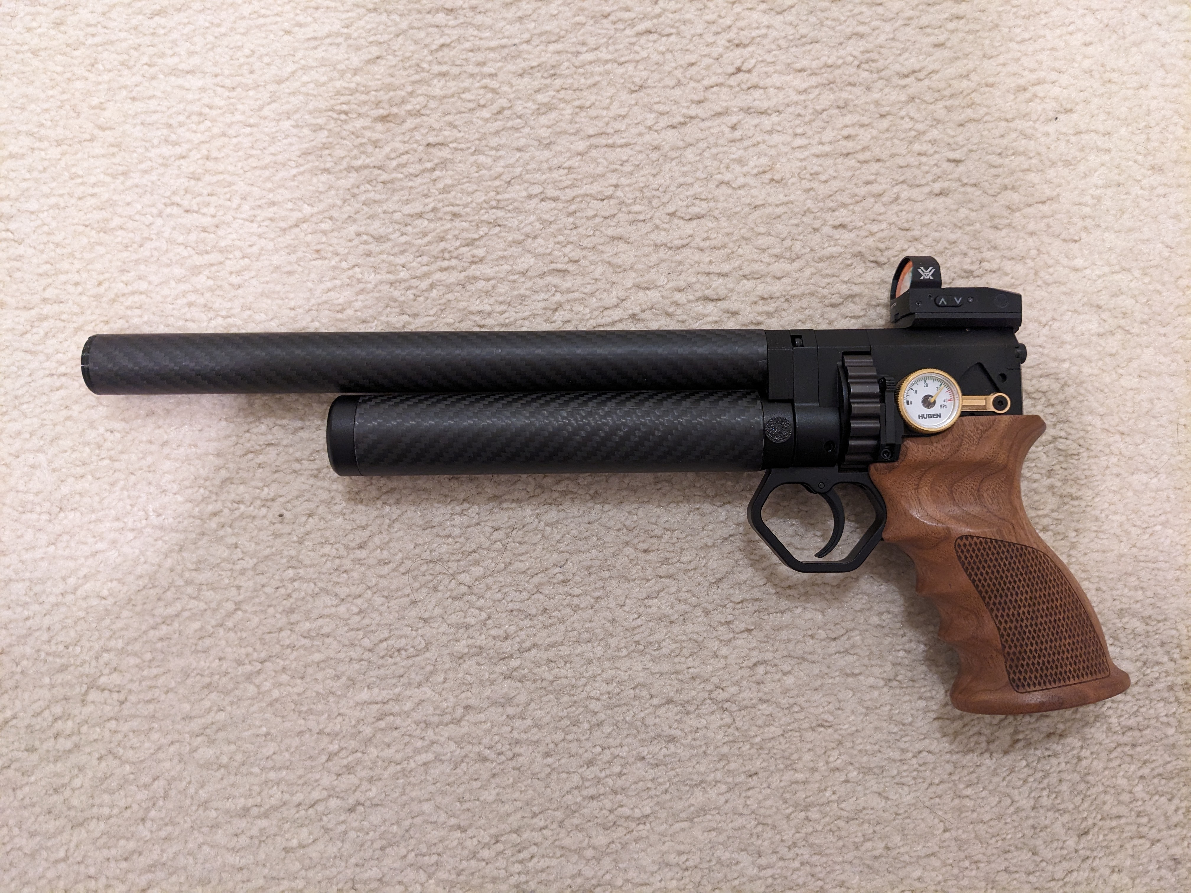

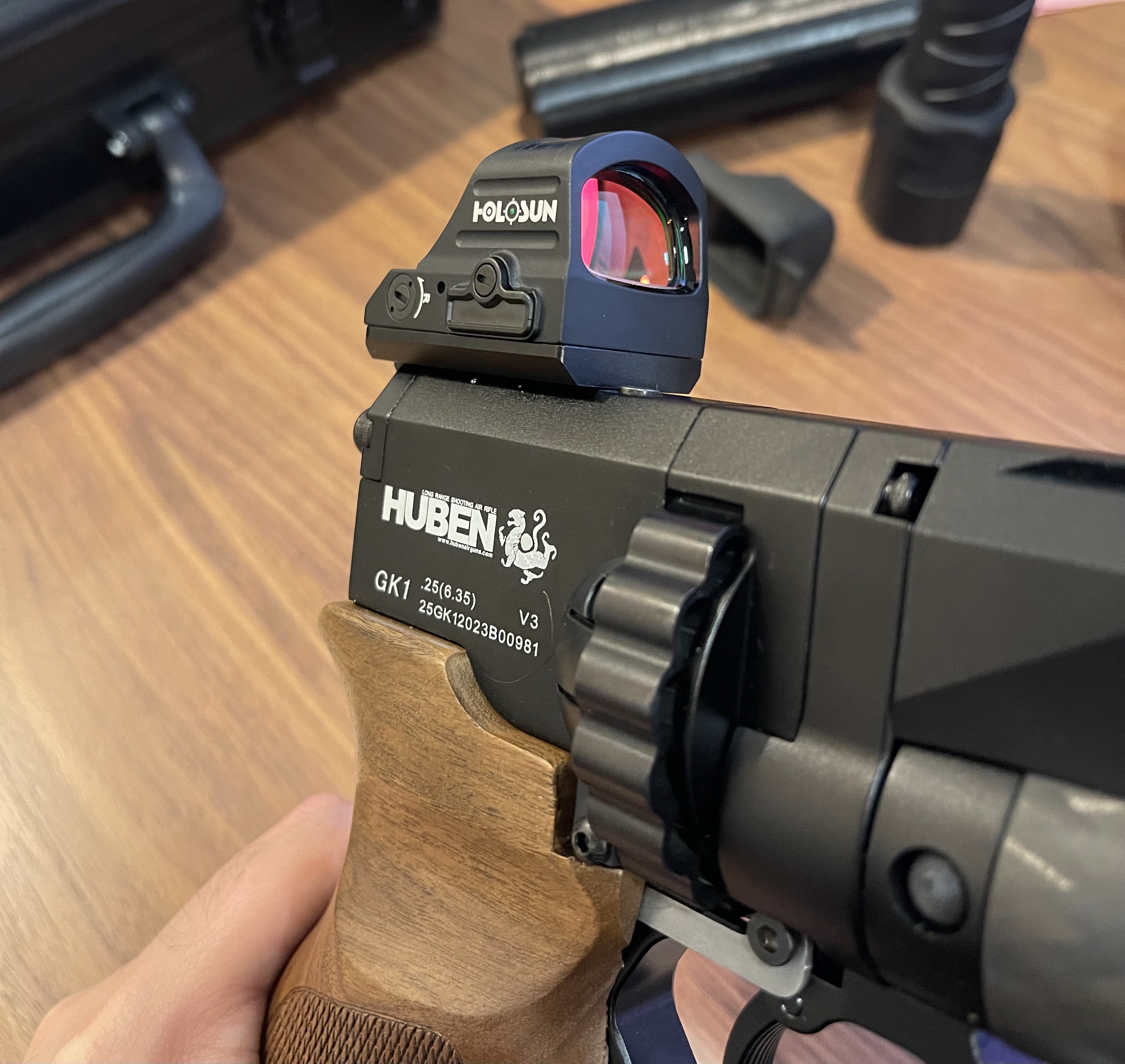

I got the mount I mentioned. It works well with the Vortex Venom red dot. I needed the mount because I replaced the stock barrel shroud with a functioning 25mm OD CF stroud with integrated LDC. The rear sight would be partially obstructed by the new shroud, and no dovetail to mount a sight anymore. The shroud volume contains the muzzle blast. The gun is very quiet now! Shooting 0.177 10.8g at about 800 fps even the shooter wouldn't think a gun was shot. A person standing next to a shooter doing rapid fire wouldn't know what the sound was. :) It sounds like a pneumatic tool venting air. The gun is about 3.5" longer and weighs 0.05 lbs. less than the gun in stock form. Better sights, quieter and lighter!

How do you all determine the correct style mounting plate to buy in order to mount a reflex sight on the GK1?
Are you referring to which of the GK1 mount's "footprint" style to buy? If so, then the mount style depends on the reflex sight that ypu plan to.put on there, as each brand and model of sight has its own ''"footprint." Here's an explanation and list of them.
