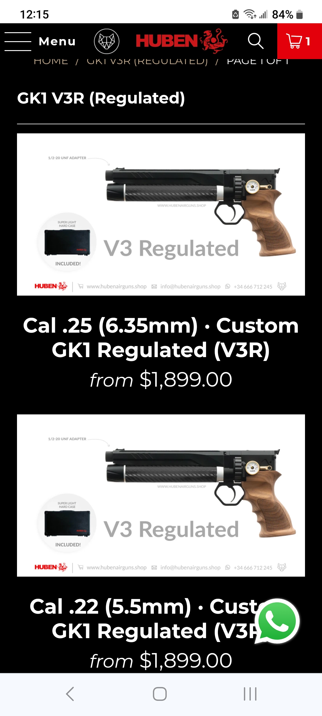

The regulator kit works on all model GK1'sHuben now has a regulated version of the v3 now available pricey though
The Huma Regulator kit looks better (in my opinion) than this one, as it doesn't then add extra length to allow for the pull out fill probe cover.
That isn't correct mate.The only regulated GK1 is through Francisco's shop. It's aftermarket parts and would leave you with a small plenum. The GK1 self-regulates well enough for a pistol.

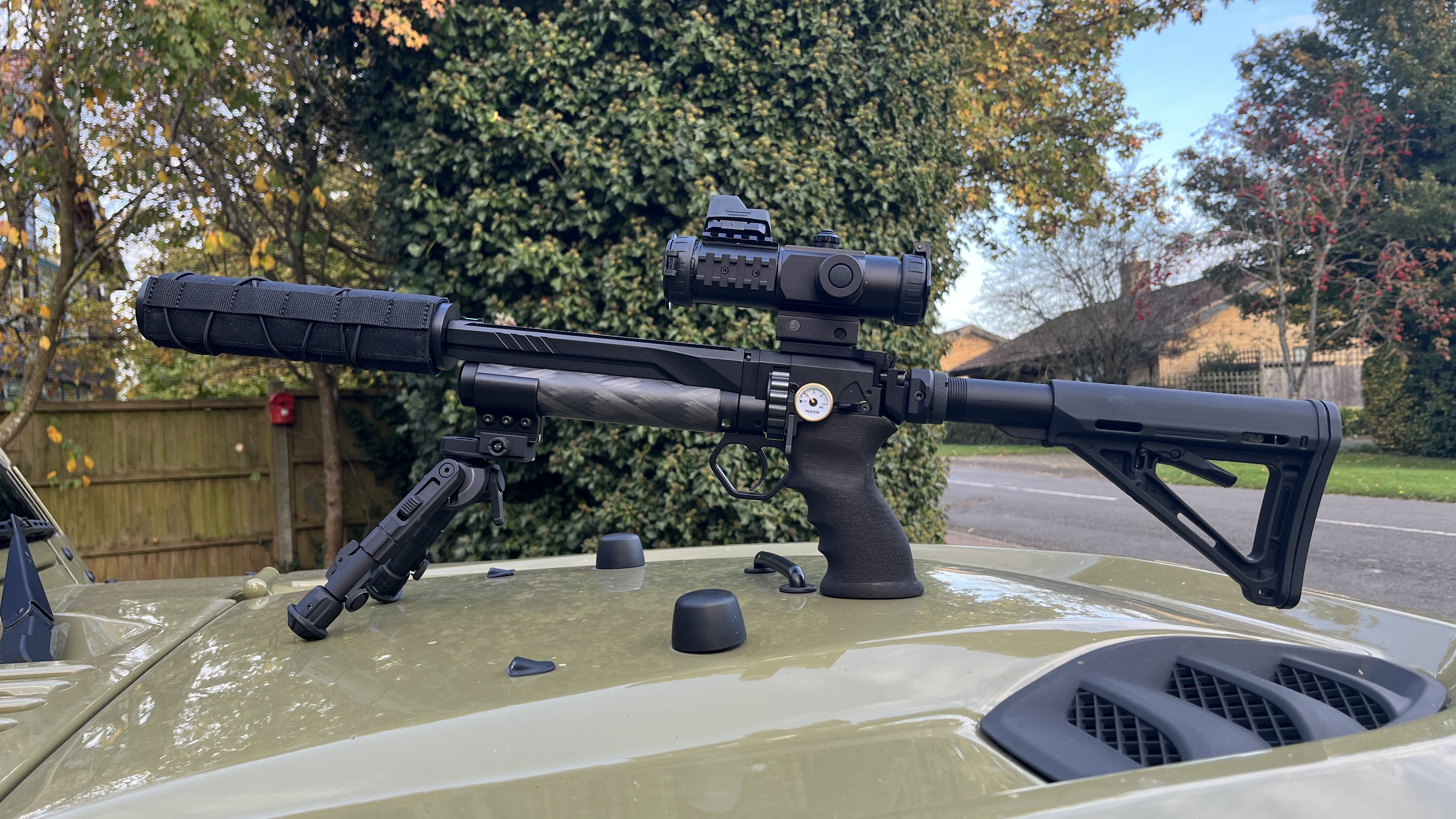

My Regulator is set to 125Bar (this is probably the lowest you can set it to in order for the gun to index correctly) and in a .25 calibre shooting at:
12fpe = 105 shots.
20fpe = 75 shots
30fpe = 34 shots
All with a power deviation of 1 (if that)
Obviously in Carbine form with a nice scope on it, power consistency is always a bonus and let's be honest, 30fpe is still a massive amount of power.
