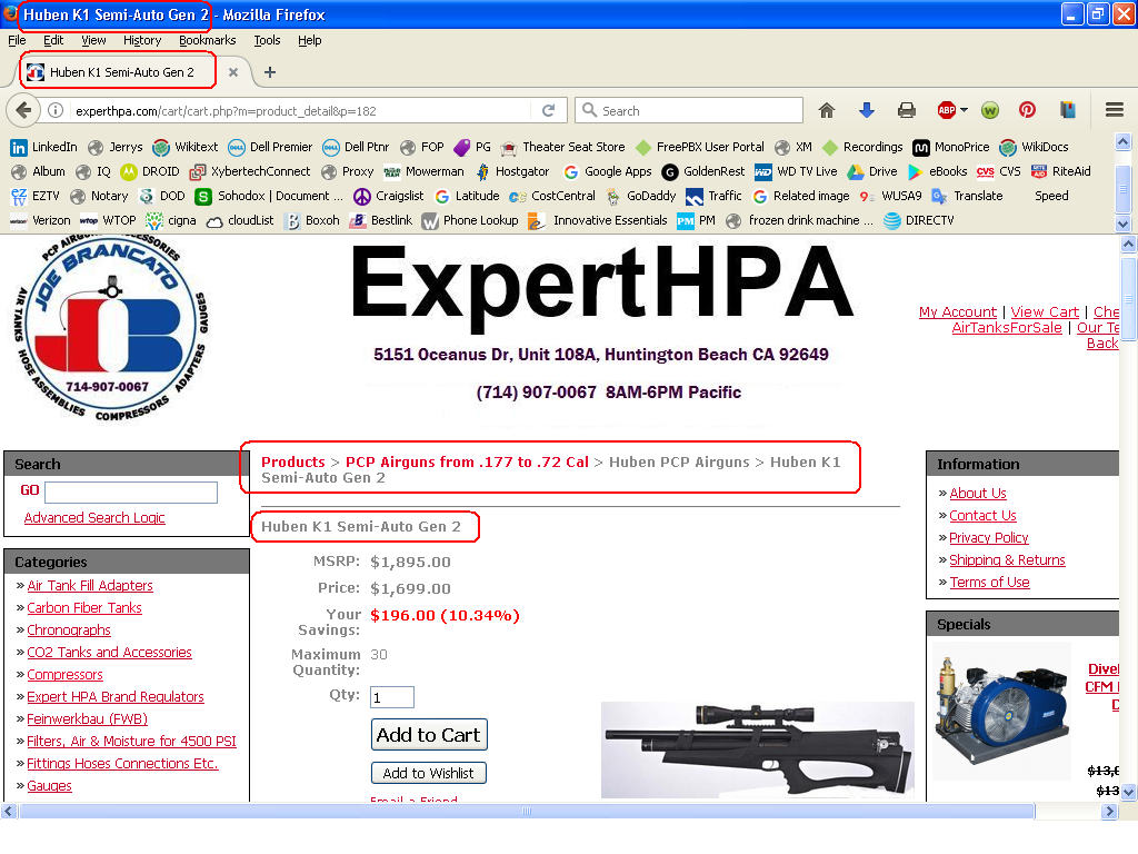

Topgun Airguns is selling the Huben as a "2nd Generation" (their description). I bought one and checked my serial number with the manufacturer to get the details. The Huben response called the new ones "Updated versions" that were manufactured in November 2016 and have a "Lothar Walther barrel, 12 rifling, twist 16" ". They did not mention any other upgrades.
"WylieCoyote"Topgun Airguns is selling the Huben as a "2nd Generation" (their description). I bought one and checked my serial number with the manufacturer to get the details. The Huben response called the new ones "Updated versions" that were manufactured in November 2016 and have a "Lothar Walther barrel, 12 rifling, twist 16" ". They did not mention any other upgrades.
http://www.topgun-airguns.com/HUBEN-PCP-Airgun_p_105.html
