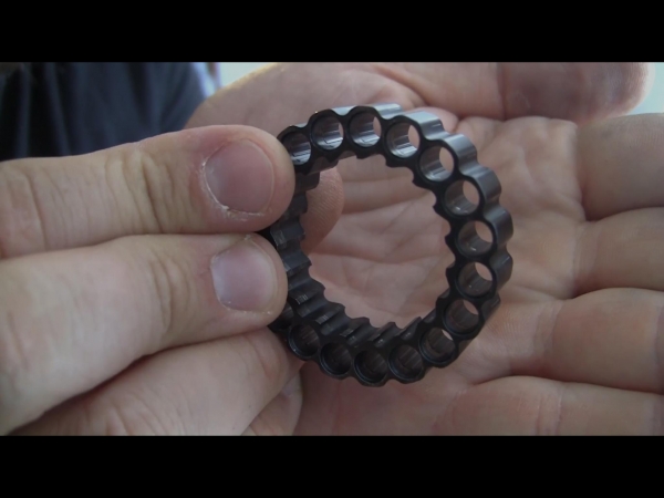

magazine with lands and grooves
machined barrel reciever, barrel clamped by nut
added layer of adjustment (magazine cylinder lands indexed to barrel lands) in barrel reciever
1 in 16.4 twist barrel, choked
highest serial lumber I've read of is 2016 #392
screen grab of Gregor's rifled magazine:
