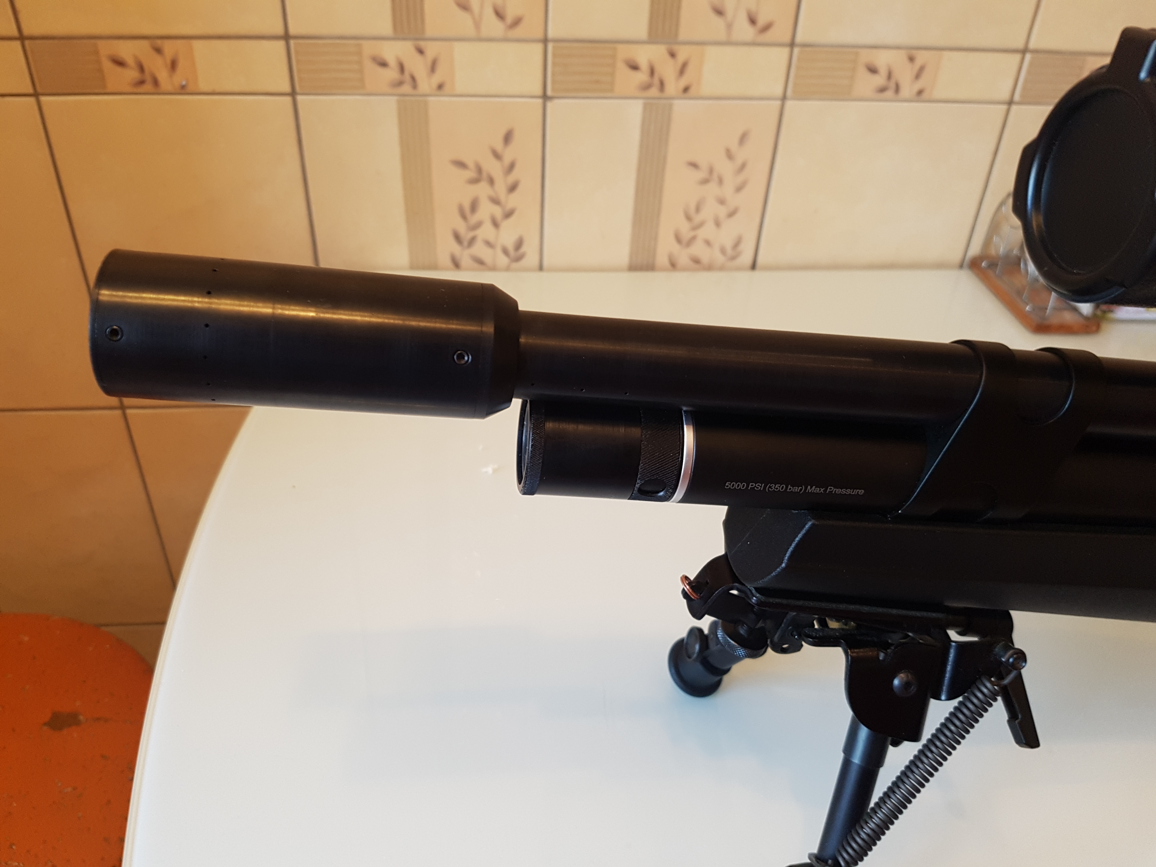

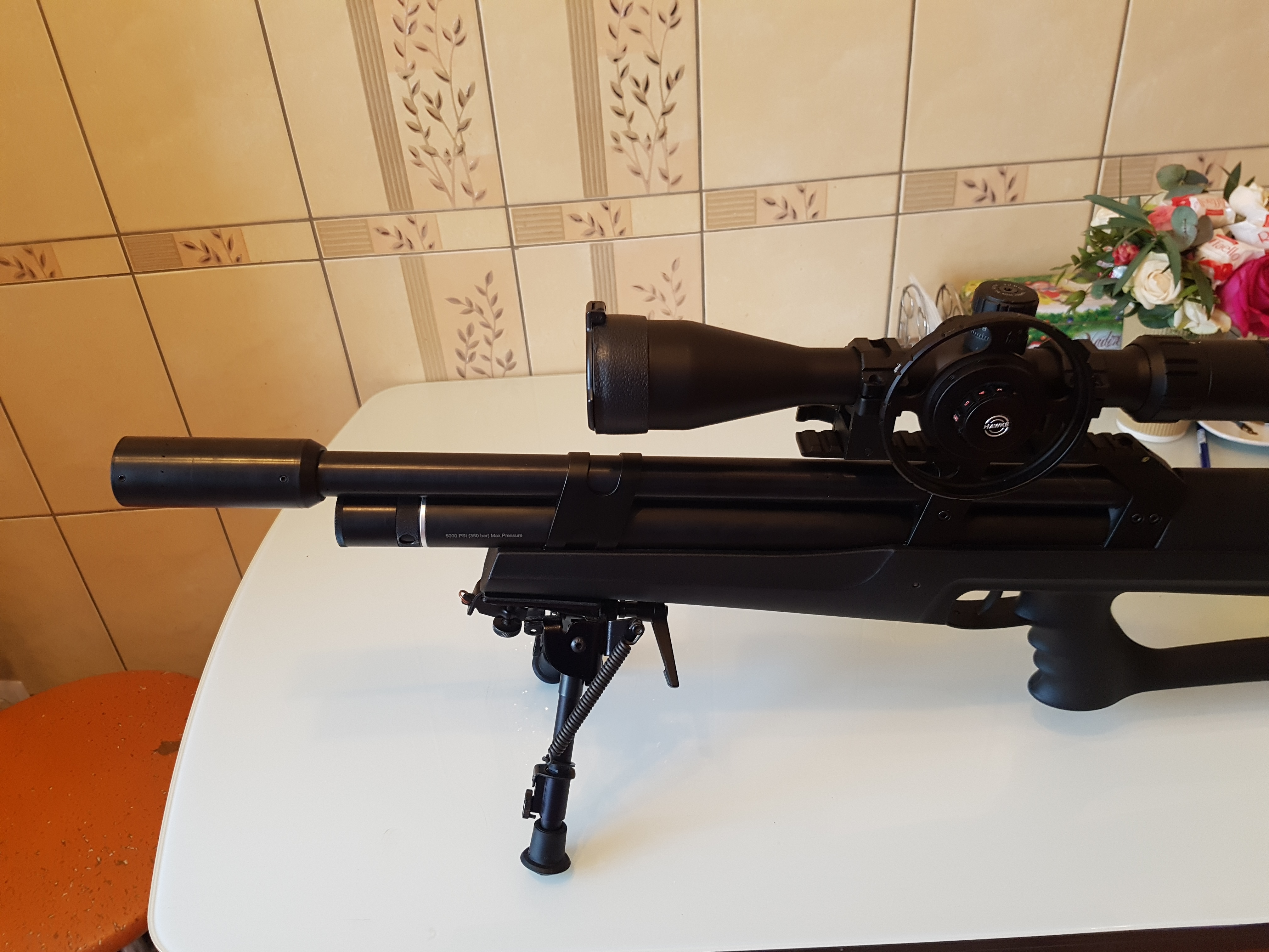

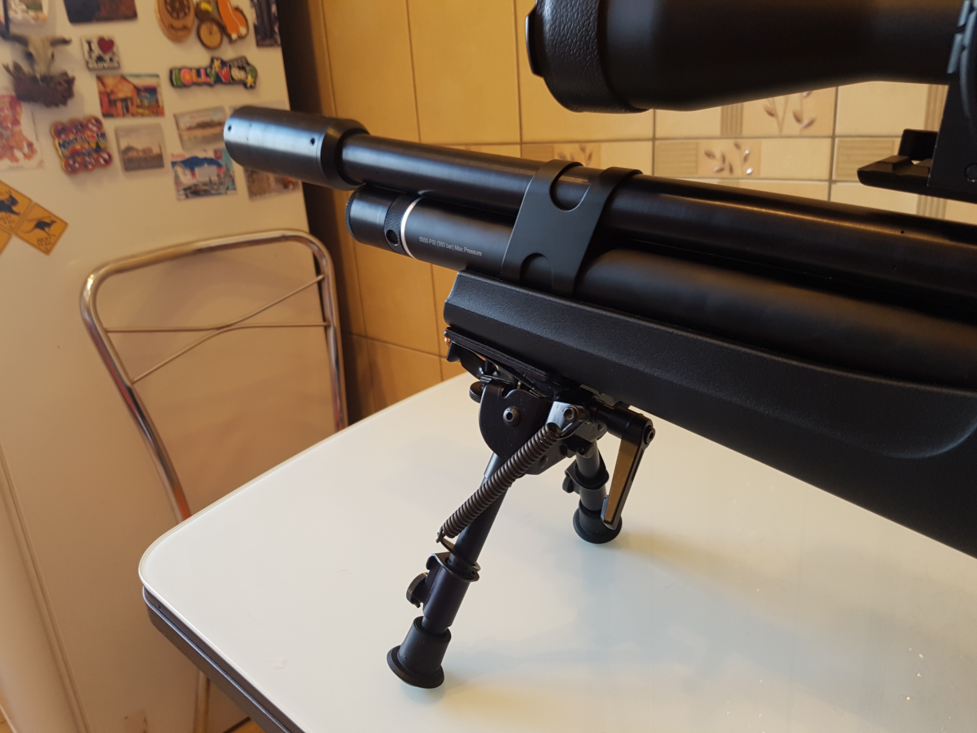

I also bought the CF tubes for the moderator you made, getting ready for the 3D file, one question that I have is how did you make the enclosure between the 2 different CF tube diameters so air wont leak back ?
Alejandro
if the thread is to withstand pressure gains, there is no possibility of air transfer between the front and rear tubes: / but the loss of cm3 is minimal compared to the fi38mm wider tube:]
I will add *.stl file this monday :p
p.s. you can cut holes to transfer air back but if you shoot with reg 170-200 bar hmm better don't shoot whole silencer with pellet ;P

There's something I don't understand how you did in the LDC I took the liberty to edit your pic of the Huben with the moderator installed and I color marked the back end of the bigger tube (see the pic), how did you make that angled CF piece to transition from the big tube to the smaller one ?
Thanks HCL, try to upload the files please.
