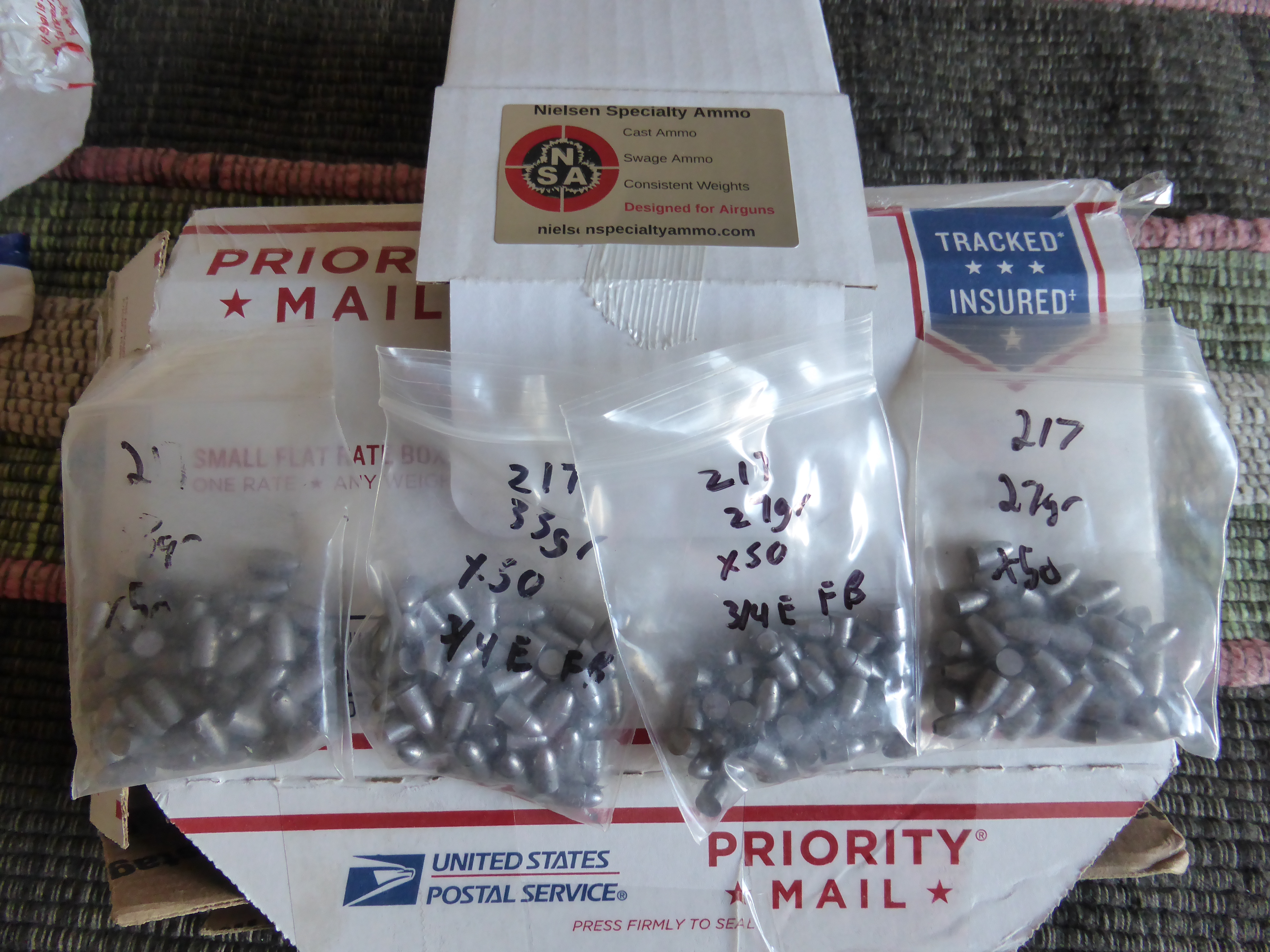

As a lot of you might saw on the video I made a few days ago Nick send me 4 types of slugs these are the differences (see the pics).
- 2 Hollow Point in 27 and 33 grains
- 2 Round Nose in 27 and 33 grains

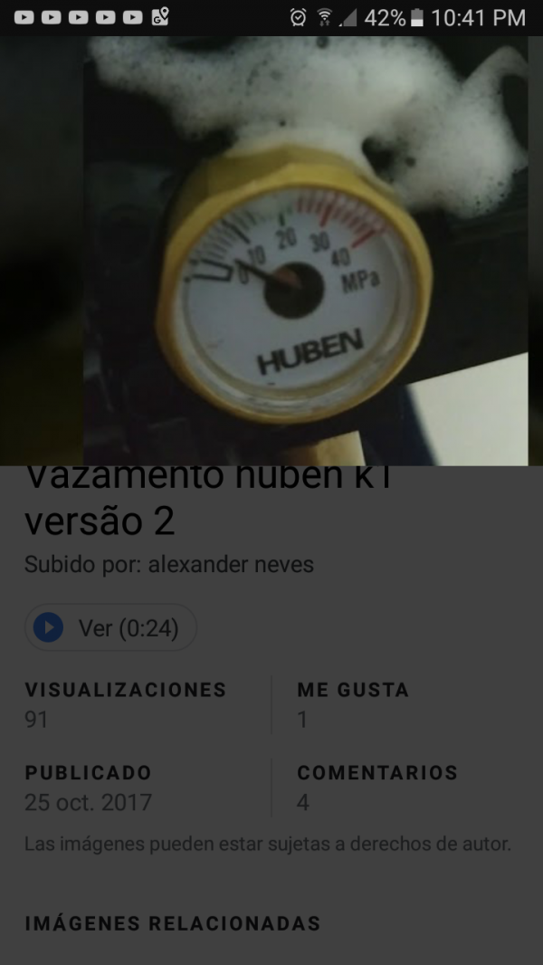

Hola a todos,les hago un pregunta tengo un huben y me empezo a perder aire por el manometro del regulador,le cambie el oring y menos pero sigue perdiendo,no se que hacer¡¡¡¡,veo que es un sistema en el que el manometro al no tener rosca no se lo puede ajustar como para que no siga perdiendo.Espero me puedan ayudar,desde ya muchas gracias
Translation for Carverter question: Hello everyone, I ask you a question I have a hub and I began to lose air through the regulator manometer, I changed the oring and less but still losing, I do not know what to do!, I see that it is a system in which the manometer without having a thread can not be adjusted so that it does not continue to lose. I hope you can help me, thank you very much

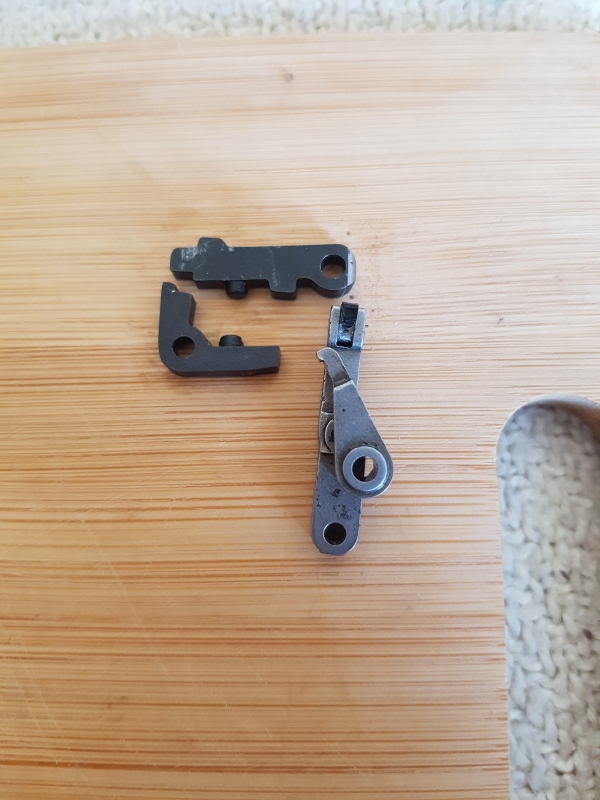

- Hi Bigalex, what happened with your trigger assembly? any news on the silencer mod and 3D prints?

 Alejandro thanks for posting. From your video here’s list of velocities:
975, 943, 960, 962, 962 ft/sec
this spread of velocities ideally should give you about 0.30” vertical group (per ChairGun or StrelokPro) st 50 yards. Looking at almost closed shooting range - wind can be ignored.
So air system can do 0.30” group at 50yards. Your “all over” result is caused by barrel and/or projectile.
looking at pics NSA bullets have rear biased center of gravity. Some of target holes do not look round which may indicate keyholing caused by bullets loosing stability and wobble.

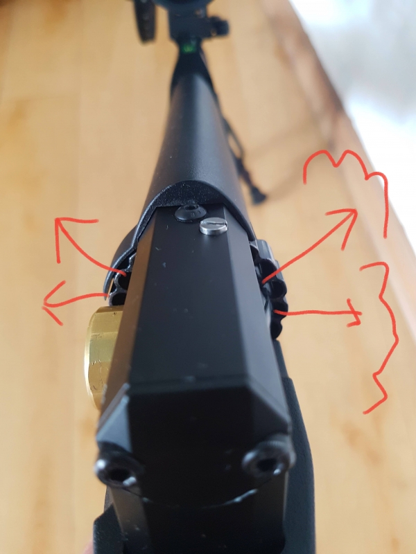

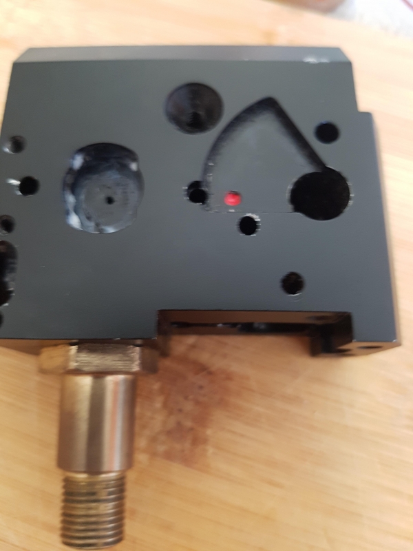

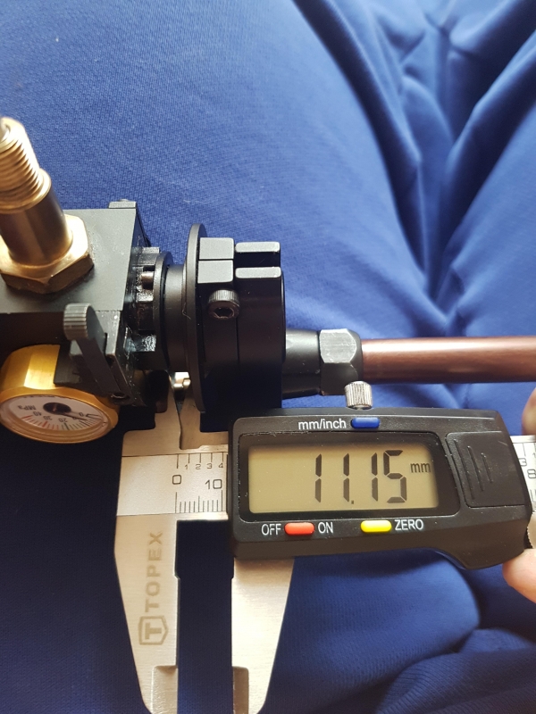

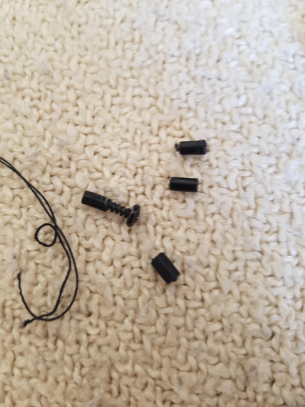

I disassembled the valve incorrectly and made too much pressure as a result of the triger mechanism hit pieces of metal. To parse the mechanism, it is necessary to drill a 1 mm hole in the plastic plugs in them and screw in the screws. I also combined the barrel and magazine, this helped Gregor. There was also a problem in blowing air from under the maga
zine
