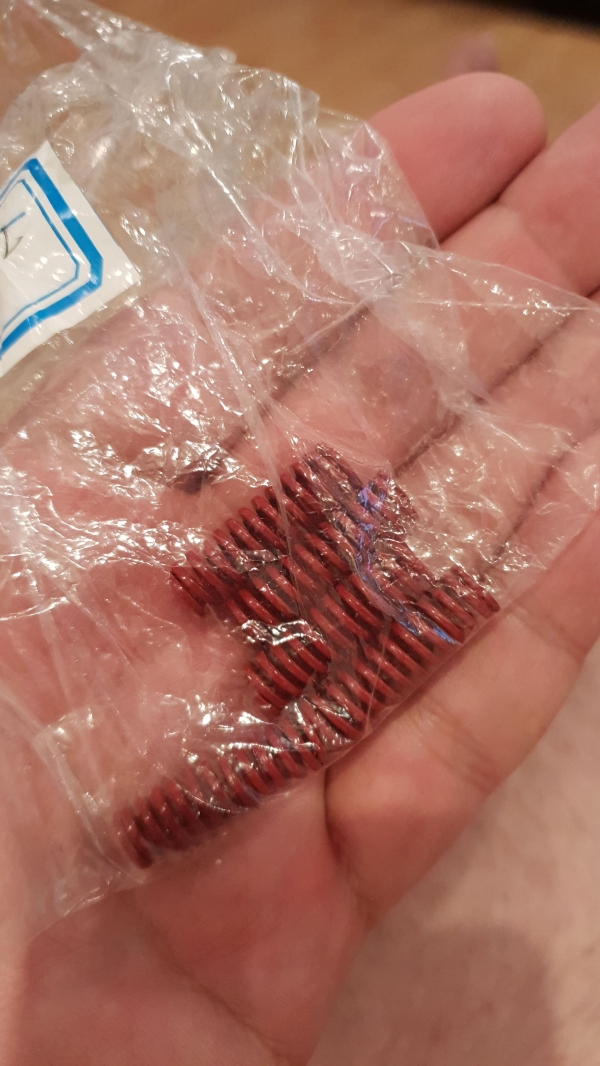

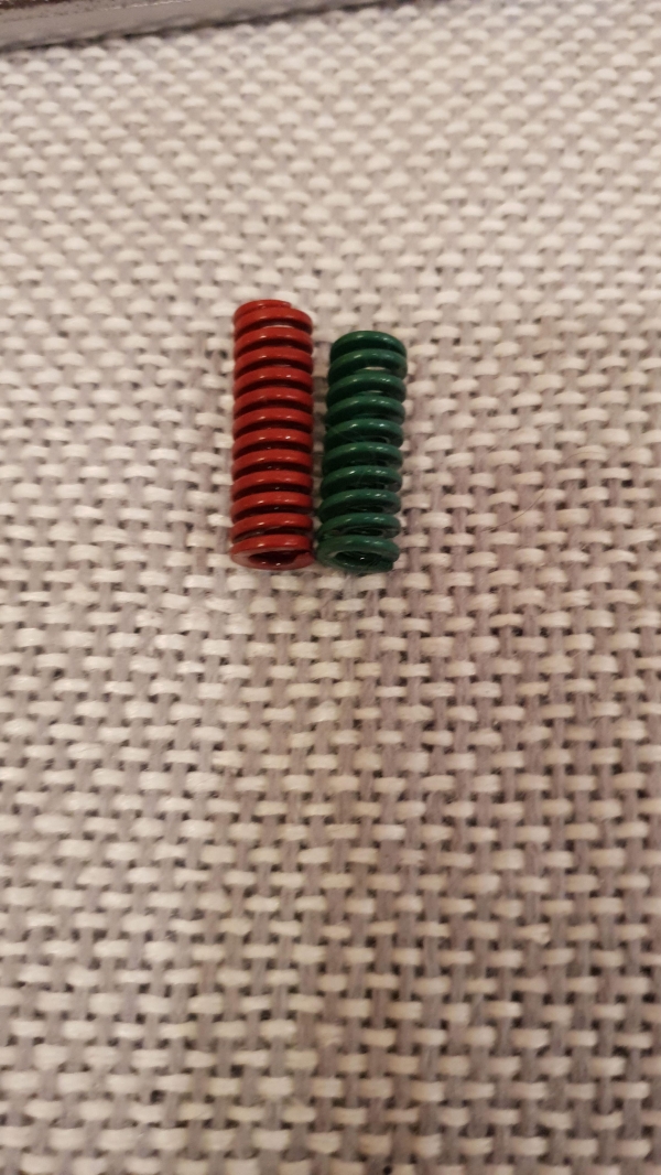

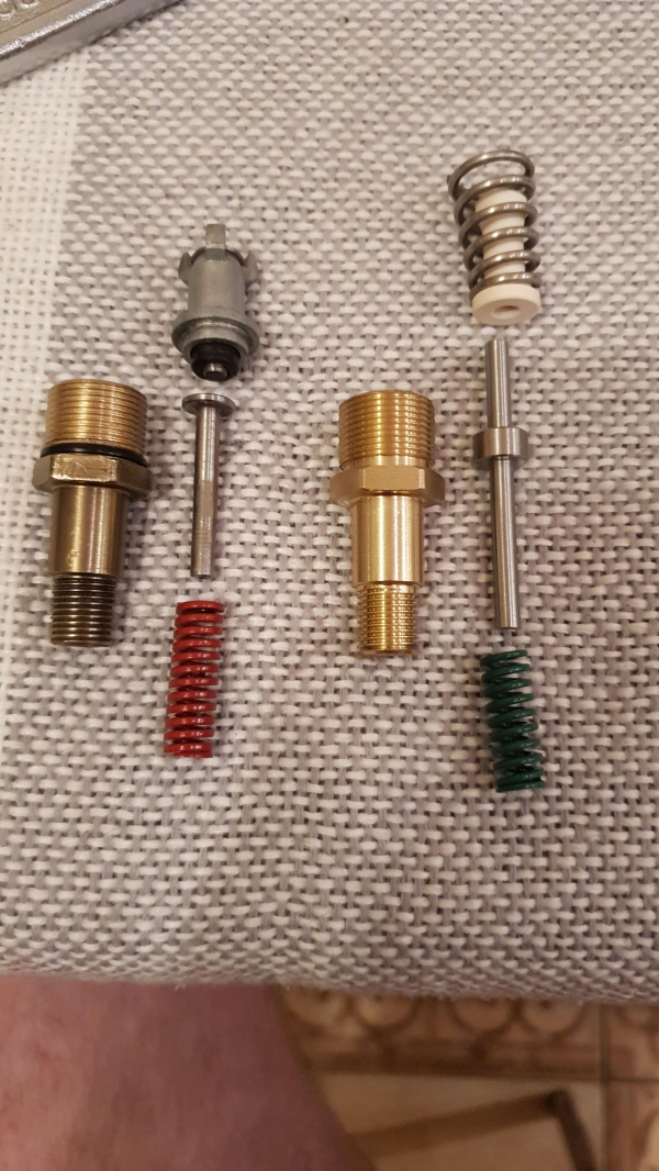

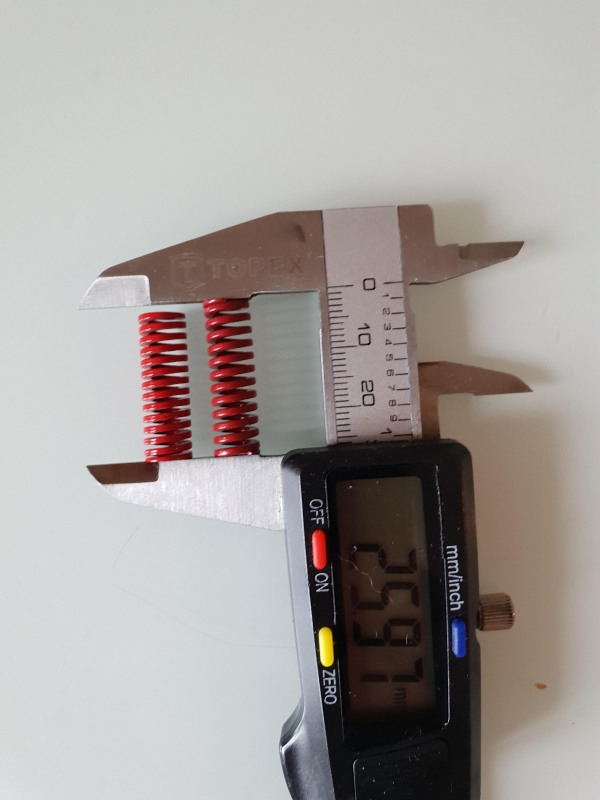

who have problems with the speed jumps, pay attention to the red spring in the regulator its nominal length is 25 mm, I have it dropped to 24.2 and problems started. with ali received similar springs price 4 usd length 25.6 mm

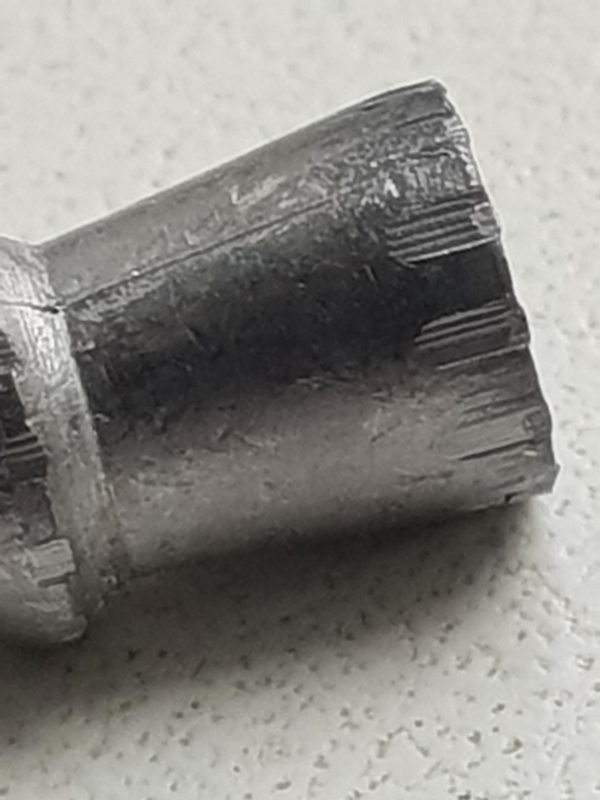

When loading up the solids, Some go very easy, Some tight and some doesnt fit in the magazine.

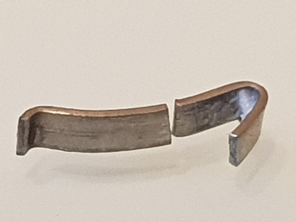

But When I push a pellet in, and press it out, this is What it looks like:
1539102331_12506617005bbcd67b6dc866.01662729_3395836E-09D1-46DF-BC2D-240E7F07FF27.jpeg
My tought was, Maybe soms solids get damaged wrong And Cause inaccuracy.
Does Some of you have suggestions to make the gun more accurate When shooting with the right pellets?

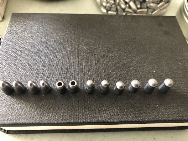

Hi D-RIG,

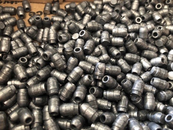

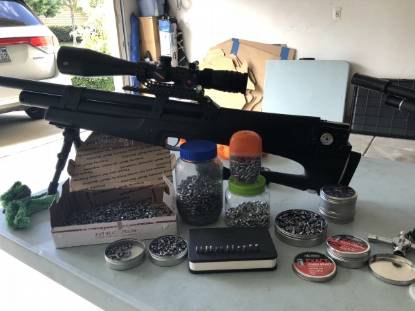

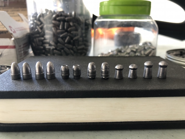

I found this hollow point 28 gr. bullets on eBay? This bullets fit Huben’s magazine and this bullets seem to shooting well at 50 yards at 990 fps. Accuracy about the same as JSB redesigned. I’m waiting for my side-shot scope mount to come in to do some video shooting with longer distance. See couple of my favorite bullets and pellets that perform very well with my Huben. I haven’t try Huben’s bullets yet, since they are more difficult to found here in the U.S. see pictures what I have been shoot with and perform well on my K1
1539284141_19222007725bbf9cad387d47.30758543_2AA7491E-E674-4623-ABD6-5415A4F6A80C.jpeg
1539284141_21388040585bbf9cadf0cf57.69329930_9A865644-CE0A-4456-9EFA-8D16B70E8C80.jpeg
1539284142_18897617245bbf9caebbd022.37081980_6AFD14DB-9854-4F74-8E6F-D62C6FA780BB.jpeg

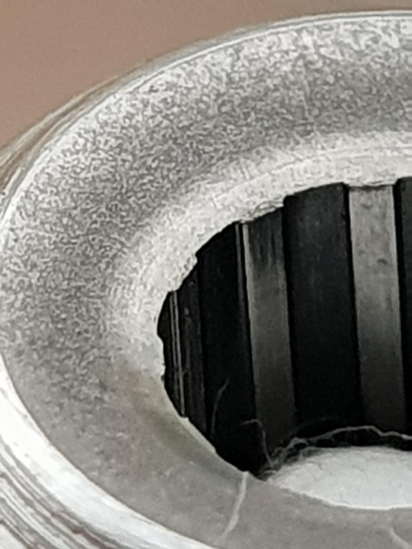

In the picture above, Sept 22 @9:19 post, that crown does not look good. Looks like there is a raised ridge just at the point where the land stops. Especially visible at the top land in the photo and the first one to the right. I'd redo that crown, maybe polishing with brass bolt and compound would be sufficient bit it looks like it could be improved dramatically.
