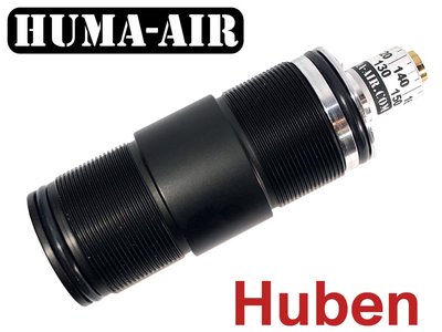

has any 1 installed huma regulator in their huben k1?
If so what are the review about it

I see that it would be wise to order the reg pressure tester along with the reg as having to dump all that air for fine tuning possibly many times would be aggravating. I have two Hubens, an early K1 .22 and a just arrived K1 .25. I wonder if the reg can be used in both. Big disadvantage having to take the air tube apart to change from pellets to bullets. Regards, Tom
