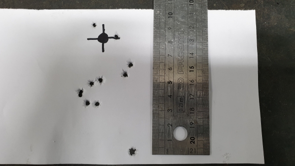

Here's my last group at 100m, almost no wind, shooting huben pellets at 290m/s (around 90joules) with reg pressure at 160bar.
@jellvand, I can confirm your settings with the powerwheel. I`m not sure if it bleeds completely in any wheel position.
However, nice groups for 100m. Im far away from this after first time cleaning the barrel. Dont know what happened to my Huben. I`m also shooting the Huben slugs, but not better than with the JSB Beasts or redesigned Monsters !

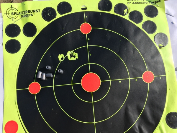

Went out yesterday to test some swage ammo for my Huben 22 cal
I started with 12 different slugs that consisted of boat tails flat bases
hollow points and round nose solids and were 33 grains in weight ,
Here is a 50 yard group the one shot on the left was me I think
pulled the last shot I think I got excited . K-1 / V-4 I do not know
what speed I was shooting as I forgot the chronograph again .
so I just so I just got my 22 Huban. Jsb ammo sucks and the huben ammo was a 4 inch group at 100 yards. What molds did you use? And where did you get it D-RIG?

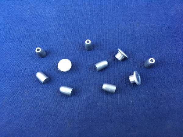

This is not cast ammo it is made with a swage die
and pure lead wire , it is superior in every way to
cast ammo , it is perfectly round and the weight is
within 1/10 of a grain from slug to slug .

The swage die for the Huben are custom made from Corbin , The lead wire I purchase from
a person that I found oneBay it's around 3 dollars a pound .
The SPA M-10 is a great gun I've owned 2 of them and both were capable
of hitting a ping pong ball at 200 yards within 4-5 shots with swage ammo .
