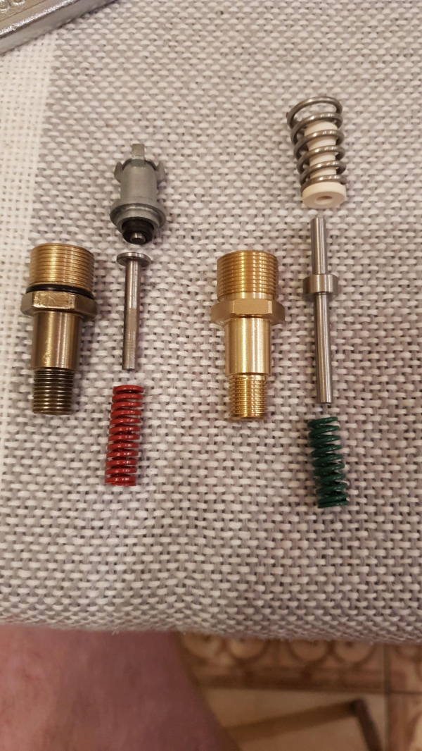

May I know what improvement does the new valve bring ?

It is necessary to remove the bed, the barrel and the log, speed control there remains a tank for air and a box (I don’t know the English name); most often it is in the place of the journal switch and under the plastic cover. a lot of places .... need to check everything. The inner ring in which the valve runs is also damaged. The size of the rings is in the middle of this theme. Buy the best nbr 90 for moving places.

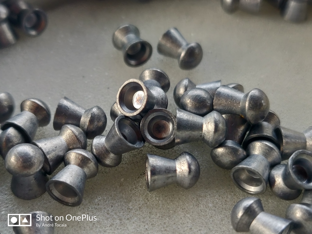

I have been using Jsb Heavy (this one to have good performance has to be specific batches with head dimensions and skirt compatible with k1 barrel, Barracuda Match, Rifle Destroyer, Jsb Beast and slugs by MPmolds
May I know which one is the best for your Huben ? I am considering getting an MP molds ( 5.55 mm ) but would like to hear the others' experience first.
