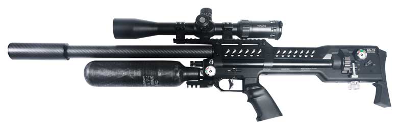

I read an article in Hard Air Magazine about an LCS airgun that is semi and full auto - see link. A close examination shows that it looks a lot like the Huben K1, including the fixed magazine. They improved the loading port and many other little things. They use a carbon fiber bottle instead of the titanium, so the pressure is lower. According to the article, they are being assembled in the US. They are being sold at Airguns of Arizona, according to the article for $1999.
