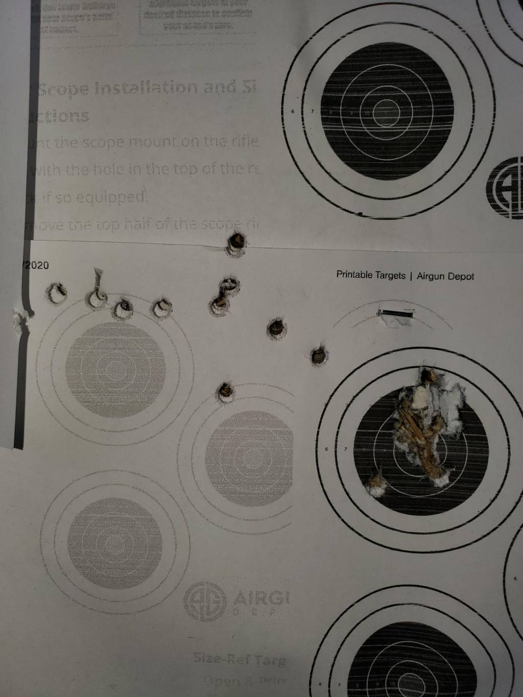

I got some of the new hybrids from FX to try with my .25 caliber Huben K1. They were on backorder for several months. I am having a hard time getting them dialed in. The 10 shot group on the left are the hybrid slugs and the group on the left are JSB Heavy MK2.
I am glad I got the FX hybrids for free from Aigun Depot because they don't seem too compatible with the K1. I bought several tins of JSBs and got the hybrids for free (I think it is like buy 2 or 3 get one free, I can't remember because I ordered them months ago).
They get stuck and make it hard to advance the mag a lot too. I had the same problem with H&N Baracudas as well.
I might try and drip some candle wax in the tips of the hybrids to see if that makes them more accurate.
At least the JSB pellets are super accurate.

I know your problem with K1 .25 because I have had this problem. I am currently using a custom made slug and have shoot the target at a distance of 255m. The main reason for this is that the size of the bullet is smaller than the magazine so when it hits the barrel it's often in an unbalanced position and that's why it doesn't always hit the target. We have made smaller magazine so that the bullets inside are balanced. Wish you a successful research
Hi Mike0
Makes perfect sense. Thanks. I sort of figured the slugs wouldn't work out. But I saw lots of positive YouTube videos about them and wanted to give them a try. I should probably just stick to JSB Diablo shaped pellets because they shoot great and they always kill what I shoot. I usually do a 2 shot "double tap" when I hunt any kind of varmint, and I don't hunt over long distance. So I probably don't need a slug anyway.

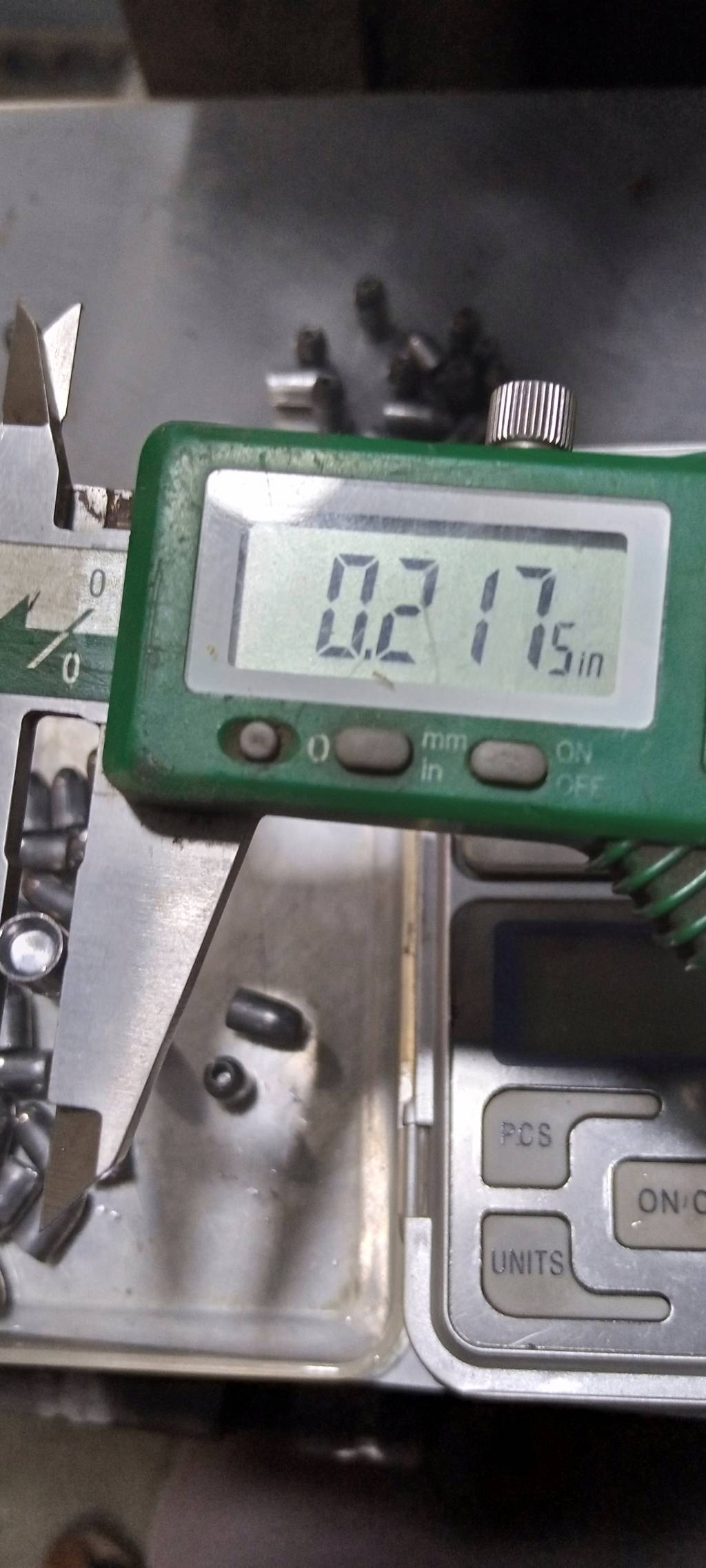

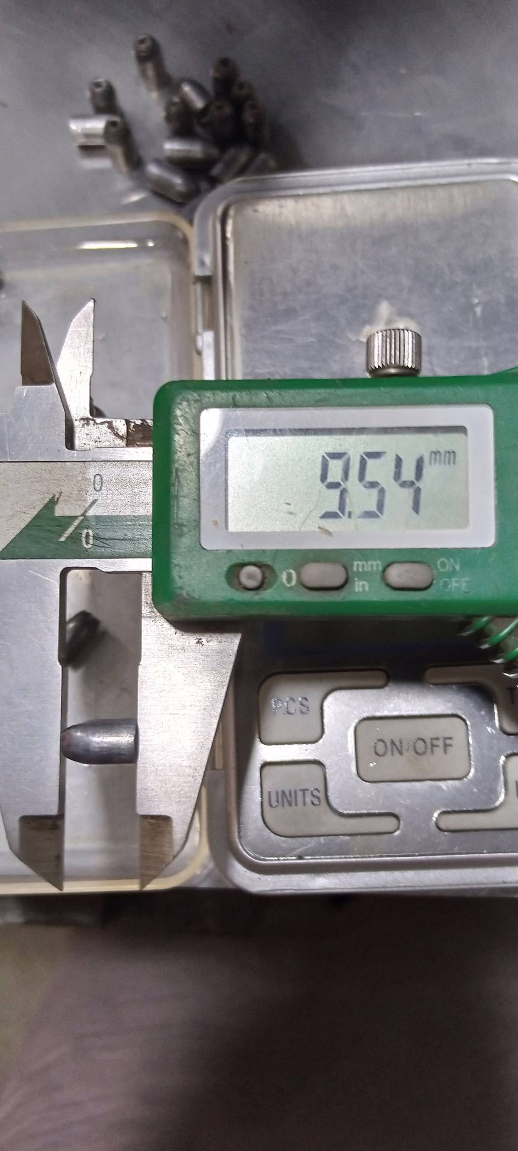

Kelly from Krazcool Airguns passed along these barrel stats. to me today regarding the 2020 .25.
Huben Manufactured
Twist Rate – 580mm ( 1 in 22.8346457 inches) OR 1 in 23
Groove – 6.45mm
Land – 6.3mm
No Choke
So, this is a .254 barrel, not a .250. Slugs with a diameter of .250 will not work well, or at all, in the Huben. Thought folks would want to know that before ordering slugs. Seems like right now AVS is the only place (that I know. Others can chime in if they know) that is making the .254 diameter slugs.
