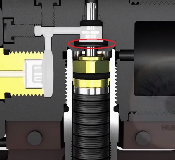

Hi there I am having problem in huben k1 with firing valve, vale is seated properly in seal but is striker is not engaging properly and safety in not engaging,
Alejandro, thanks for stepping in. There is one issue that you can have when installing the new type of the seal (the light gray harder plastic type). The tool for inserting the seal is designed for old softer seal and can cause problems when installing the new type of seal:The problem is that the plastic part of the seal does not seat on the inserting tool properly because the inner edge of the inserting tool is not sharp enough... Before the modification:After modification:![]()
Also important, it is not possible to get the new seal out with the removal tool as this hard plastic is so tight that the tool slips out and the seal remains in its position. There are other ways to remove the seal but you have to remove the whole action and I pushed the seal out form the front side (from the magazine side...) but not with the removal tool, you need to use a small flat screwdriver with sharp edge or something similar, but be careful not to starch the surface of the inside of the action where the seal lies... Hope this helps.![]()
Got the same problem.The bottom part that is marked is a plastic seal that is damaged, top part is an o-ring around it... This plastic seal is responsible for sealing when the regulator cuts off the airflow (when the pressure reaches its set value in the regulated chamber). Because it leaks, your pressure just keeps on rising. This is probably the reason for your problems
